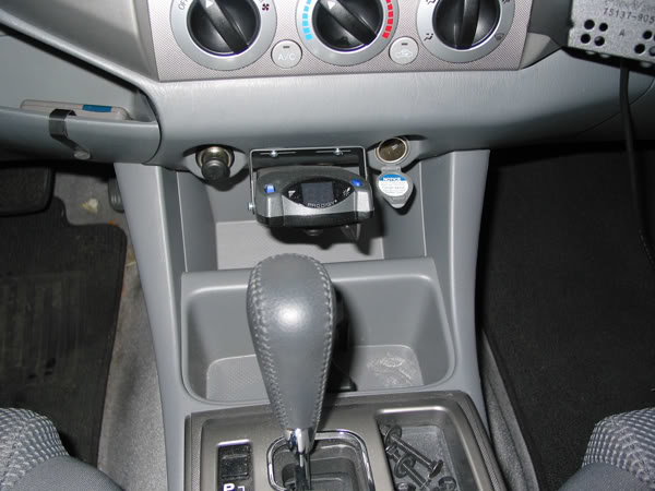

    Speaking of Brake controllers. The Prodigy is probably the best proportional controller out there. You'll find that a majority of people that tow will recomend the Prodigy. Surf on over to http://www.rv.net/ and you'll see the "rave" reviews.
    Just as easy to install as the one you have... actually easier because you don't have to use the pigtail that Toyota supplies. The one they supply doesn't have the molex plugs on both ends. Tekonisha sells a Toyota pigtail to go with the Prodigy which has both ends on it. The install is literally a 10 minute plug-n-play installtion if you have the factory tow package.
    Here's where I mounted mine... easy to activate the manual lever as well if needed. Some have mounted it in the coin pocket just to the left of my install but I found it harder to reach.

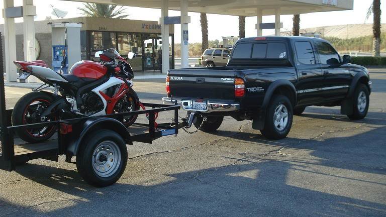

    Hi i have a noob ? Well i did some towing this past weekend about 140 miles round trip with my 2002 crew cab v6 trd tacoma.. (not 4wd) i was towing my street bike and a 5x8 trailer.. I would say total weight is about a 1000 pounds or less. I know this has been asked way to many times but what gear should i be in? and does it have to be out of overdrive? i drove it in D with overdrive on, but i wasen't sure if it was hunting for gears or not. i went up some pretty big hills with the ac on.. it seems to do fine, And is it ok to take the overdrive in and out of overdrive? i took it out of overdrive a few times when i hit some steep hills.. then i would put it back into overdrive once it was over the hill. is this all okay? =) thanks!

    It sounds like you did fine. It is a safety rule to keep it out of overdrive. If the truck is managing the load the the overdrive rule can be ignored. I wrote it the way I did to prevent people who didn't know any better from doing damage to the transmissions. If the truck is hunting you'll hear as well as feel the transmission kick out of overdrive, and the engine RPM will increase, then almost as abruptly you'll feel it re-engage overdrive and the RPMs will drop. you can also watch this happen on your tach.
    It is more than safe to take the truck in and out of overdrive manually, in fact you did exactly as you are supposed to do. Take it out of overdrive when you need to climb a hill, and then once you are on flat ground again you can go ahead and put it back in overdrive. Just be watchfull for the tranny hunting, and if you do that you and your transmission will get along just fine.

    Thanks! i feel alot better now.. so i do just leave it in D? right ? not in any other gear? thanks for ur time =)

    So im gonna do some towing today.. here is a pic of the trailer with my bike on it. just thought i'll share this so u guys have a idea of what i was talking about =)
