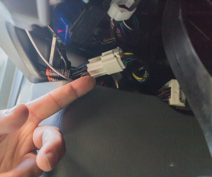

    Ok hopefully someone can help. I'm looking for the brake controller plug under my drivers side kick panel and around the fuse box and I can't find it for the life of me. Am I just looking in the wrong spot? I have an '09 DCSB OR with the towing package.

    on my 08 it was just forward of the driver-side dashboard fuse panel (by forward, I mean car-wise, so behind the fuse panel...). ok, here, let me take a picture, I used a Tekosha harness adapter so installing was trivial, just plug and play. the plug was a bit tucked behind the kick panel to the left side of the drivers feet, its the one with the fat yellow wire.

    Since mine had never been used, it was buried behind all the wires. I found it by feeling around. I couldnt actually see it.

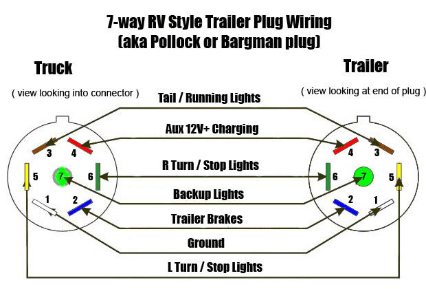

    What is the most common connector type after the 4 pin? When I get my hitch built I'm wondering what kind of wiring connectors to use.
    This is the plug cover I see everywhere that I like but I'm not sure what kind of connector it has other than 4 pin.

    4 pins are for tail/brake lights only, mostly used on small utility and boat trailers under 1200 lbs gross trailer weight.7-
    the standard plug on class III/IV hitches for towing RVs and such is a 7 blade. this has battery charge power (so the tow vehicle charges the camper battery when you're traveling), and electric brakes as well as lights. It also has reverse lights, which the 4-pin does not have. if you wire for a 7 blade (big fat round connector behind door on left of your pic), you can get a 7-4 adapter plug really cheap.
    7-blade RV connector:
    4-pin:
    note on both of these, 'brake lights' are both turn signals together, much like old school american cars/trucks where they just used two filaments on each side, one for tail/parking light, and the other for turn/brake.

    if you're wiring from scratch, the Aux 12V Charging should be on a relay so its only powered when your engine is running, and it should be wired and fused for at least 30A. naturally, the ground wire has to be sufficiently heavy gauge for this same 30A + the brake power (brake power is substantial, too, like 15 amps for dual axle brakes, ideally use 10 gauge from the brake controller you mount under the dash).
