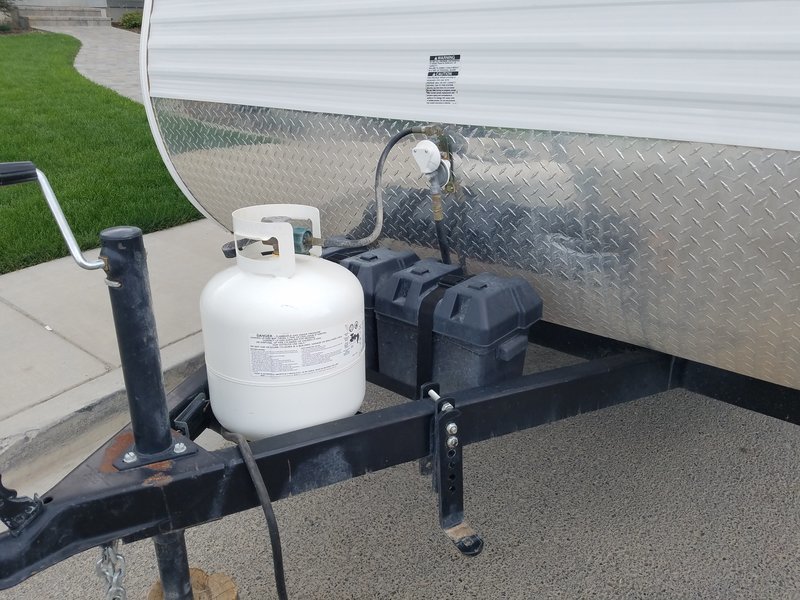

    if you can, weigh the tongue weight with it 'typically' loaded, and subtract this from the 1200 lbs(?) payload including passengers of your tacoma (that 1200 number is what my AC TRD OffRoad says, its on the sticker in the door frame).

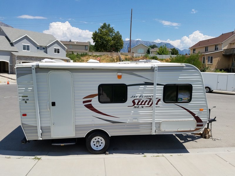

    I'll get it on a truck scale once I take delivery and get it outfitted. If the dry tongue weight is 315 lb I can't imagine that it could be more than ~350 lb loaded. My door frame shows cargo/passenger capacity at 1205 lb., and my wife, labrador, golden retriever and I weigh <400 lb combined. :-D What would that Leer shell weigh, 250 lb? That leaves 550+ lb. remaining.

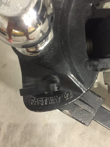

    Those brackets look like it's from a FastWay e2 WDH. If you're getting the complete kit, great.
    It has an integrated anti-sway feature so it's one less thing to attach. It's also great because with a traditional friction sway control, you'd have to remove it when backing up. Not with the e2!

    I doubt a shell like that weighs more than 150 lbs... me and the seller managed to get my Snugtop off his truck and onto mine with just the two of us.

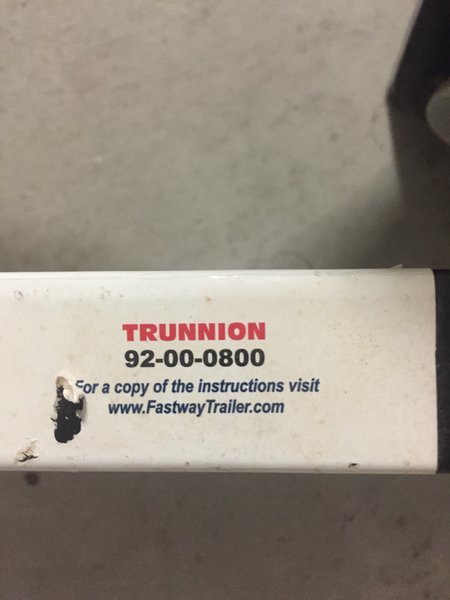

    Now that the seller has sent me a photo of the rest of the hitch, it looks a tiny bit different from that e2 but essentially similar? Does anyone know exactly what hitch this is? It's not sufficiently high res to zoom in to read the label.

    That may be the Equal-i-zer WDH. (Expensive)
    Yours is a trunnion type, whereas the e2 is a round bar type.
    In fact the Equal-i-zer and FastWay e2 are the same company.

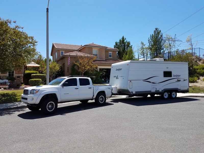

    I believe those have the advantage of not needing a separate sway control device (which is that skanky old flat thing you can see in my picture that says Curt Sway Control)

    It's actually a FastWay e2. I emailed the seller and had him take close-ups to identify it:

    20160818_140654.jpg What is everyone going to as far as electronic brake controllers? Picked up an 18ft, 4800# towhauler today. Came with a WDH, and I already have firestone airbags in the rear and the TSB leafs. Towed okay, but braking made me nervous. Thanks!
