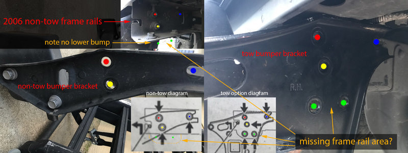

    Question about 2nd-gen. I have a 2006 non-tow PreRunner and got a stock later model (2014?) tow bumper bar. I figured I would put it on my truck instead of other non-stock solutions (I totally realize this will not increase my non-tow capacity). However, it seems that either the frame rail ends are different or I am missing some frame end brackets. (It's possible the later year frame rail ends are different but the fact that the workshop manual for 2006 show the tow frame rail shape as different seems to disprove this theory).
    So is it indeed possible that the frame rails are different between tow and non-tow? I took some pics and compiled them into an image. Hope it's not too confusing. It shows pics from the workshop manual indicating the different shapes and also pics of the different brackets AND my straight frame rail ends. What I am missing is frame mount holes for the GREEN tow bumper bracket holes. There are holes that could hold a bracket on but I don't understand why that would be the case unless it was cheaper to manufacture.
    If someone with a tow package could at least look under their truck and see if their frame rails are straight with or not that would help. I can't find part numbers for any kind of bracket anywhere. Thanks.

    outside of right hand factory thing on my 2008 4x4,
    inside of RH

    Awesome thanks for the quick reply and pics! so there is a bracket. now, to find some sort of PN for that...... hmmm...

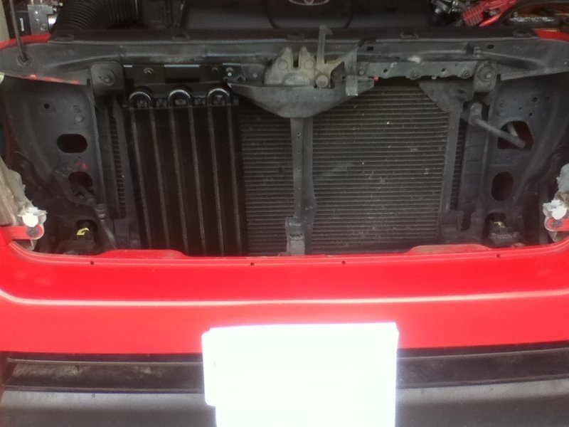

    Ive been reading this thread and other threads, including toyotanation on how to install transcooler on a non tow package v6. Does anyone havea definitive answer to which lines coming of the transmission are in and out, and which ones off the radiator?

    I didnt pull one off the radiator. I went to the hard lines that are below the radiator. It has soft lines that go to/from the tranny attached to it. I pulled one soft line off, ran it to an aftermarket cooler, then hooked another soft line to the hard line. I'll see if I can find the pictures.
    Edit: I couldn't find the picture of the lines. I'll get one when I get the truck back from the body shop. Here is how the cooler sits, obviously the lines go straight down.
