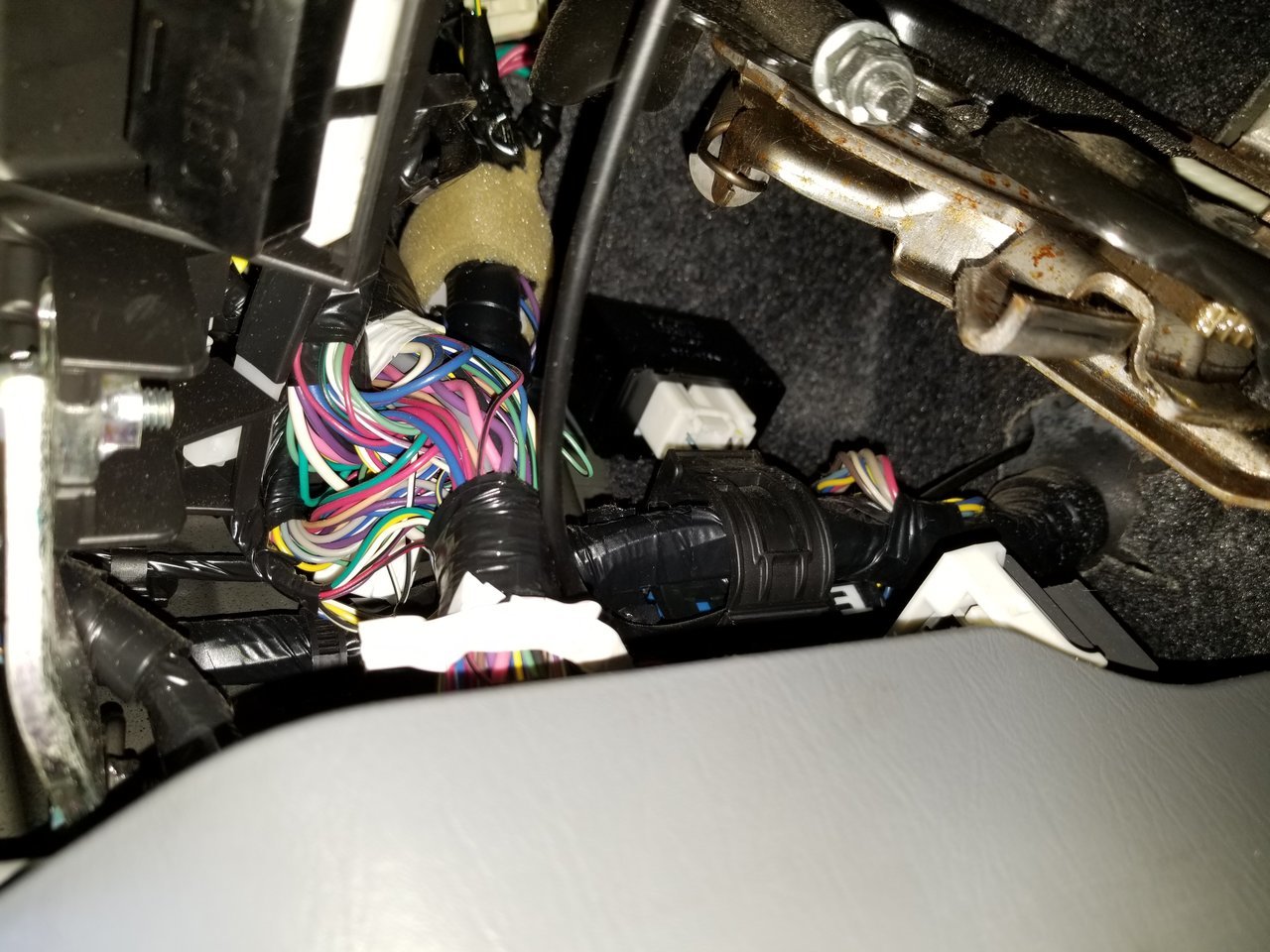

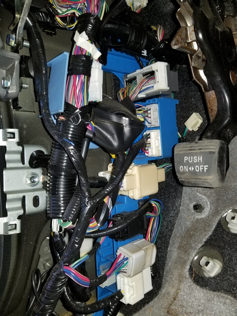

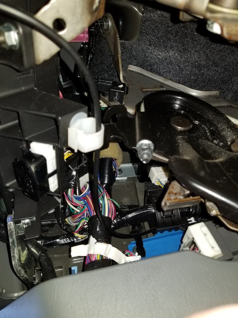

    Hi all!
    Had no issues installing my brake controller in Tacoma #1 but can't seem to find the harness in this Tacoma #2. It should have it but I'm not experienced with all the wires.
    A couple of pics. Can anyone assist?
    Thank you

    LeftCoastNerd
    LeftCoastNerd Old 'nuff to know betta
    Mar 27, 2016
    #182459
    1,890
    John
    Santa Cruz, California
    08 AC 4x4 OR 6sp
    on my 2008, it was tucked down behind that grey panel, i had to fish it out.

    raven Well-Known Member
    May 29, 2009
    #17787
    92
    Vancouver, B.C.
    '09 Access Cab V6 Off/Road
    Thank you ^
    Not much luck there either.??

    LeftCoastNerd
    Mar 27, 2016
    #182459
    1,890
    John
    08 AC 4x4 OR 6sp
    whats that plug behind/above the parking brake pedal?
    this vehicle /does/ have the factory tow option, doesn't it ?

    LeftCoastNerd
    Mar 27, 2016
    #182459
    1,890
    John
    08 AC 4x4 OR 6sp
    according to my tacoma wiring diagram, the brake controller should have...
    1 - yellow - brake
    2 - black - B+ (power)
    3 - white/black - ground
    4 - blue - 'stop'
    5 - green - taillight
    raven likes this.

    HB Taco
    HB Taco Well-Known Member
    Apr 10, 2011
    #54683
    1,242
    Curt
    Huntington Beach, CA
    2019 F150 FX4 S Crew 3.5 TT
    I'm pretty sure that's it just above the E brake pedal in the picture
    Mar 27, 2016
    #182459
    1,890
    John
    08 AC 4x4 OR 6sp
    and I just looked at mine, the blue and the black wires are quite fat going to the brake controller connector
