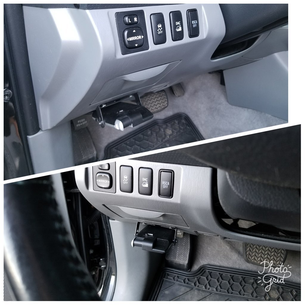

    Thank you all. :)
    I had a look at the one behind the brake pedal and it didn't have the right shape nor wires unfortunately and now I'm wondering what that connection might be for.
    I brought my truck to a local hitch shop this afternoon and they were able to find it tucked in behind that big cluster of wires. Only took them a minute or two. Oops!
    Thank you again for the help and if anyone needs another controller mounting idea this is how I set mine up. I can see it through my steering wheel.

    Glad you got it. Mines down there except on the right side so I can adj it with my right hand.

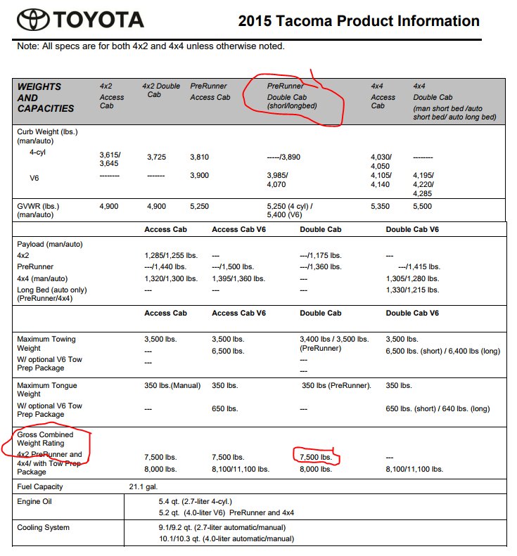

    GVW = Occupants + Stuff (in truck, bed and mounted) + Tongue weight
    GCWR = (GVW - tongue weight) + Trailer weight
    You might have to move some of your cargo into your trailer to meet your GVW. That being said, you have enhanced your load carrying capacity and this is not configured into your GVW rating so this is kind of a grey area for me.
    Your GCWR should be 7500# based off what you have told me.
    Hope this helps

    I am way under the combined weight, it is the payload weight, my door sticker has max 1145 lb and I am at 1350 lb - anything I can do to help that extra weight. Got the ride-rites, can play with truck tire air pressure, can watch the tx temp with the scan gauge. I have towed it at this load weight for 6000 miles but now looking at it thru clearer eyes.

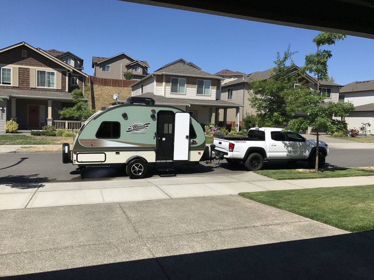

    Hoping someone can help me out with my towing situation. Full disclosure, I am new to towing a trailer.
    So while towing my travel trailer, I feel a sensation like the trailer behind the truck is moving from front to back. Not so much swaying from side to side. Also feels like the trailer is moving up and down where the hitch is at. Just doesn't feel very stable to me considering I am way under the Toyota recommended towing capacity. Maybe the tongue weight is to light?
    Specs:
    2016 Tacoma V6 w/ tow package
    Tekonsha p3 brake controller
    Curt loaded ball mount (7500/750)
    Stowaway hitch tightener
    2017 r-pod 177
    Roughly 2650lbs
    245 tongue weight (according to forest river's website)
    I attached a picture, might be hard to see but the trailer sits pretty level with the truck.
    Any help or suggestions??
    Thanks in advance!

    is this the same for 2007 tacomas? I have a DC 4x4 V6 with tow package. Would I have a GCWR of 11,100 lbs as well? Where did you get this picture from?

    if you're feeling 'porpoising' over bumps/dips towing your trailer, where the front of the truck bounces up and down a a few times, a WDH (Weight Distributing Hitch) will help immensely. I needed one towing a 2200 lb empty, 3500 lb max Casita 16' behind my 08 AC 4x4 v6 w/ factory tow. I suspect the TRD Off Road suspension and tall tires amplify the bumps. I don't feel much fore-aft surging, but I have a stick shfit, dunno if taht affects it any. the best WDH is the Anderson one, like this, https://www.amazon.com/3324-Andersen-No-sway-Weight-Distribution/dp/B009V70ZP8

    http://cdn.dealereprocess.com/cdn/brochures/toyota/2008-tacoma.pdf
    Pg 29
    It appears that with the tow package you can in fact have a have a GCWR of 11,000#.
