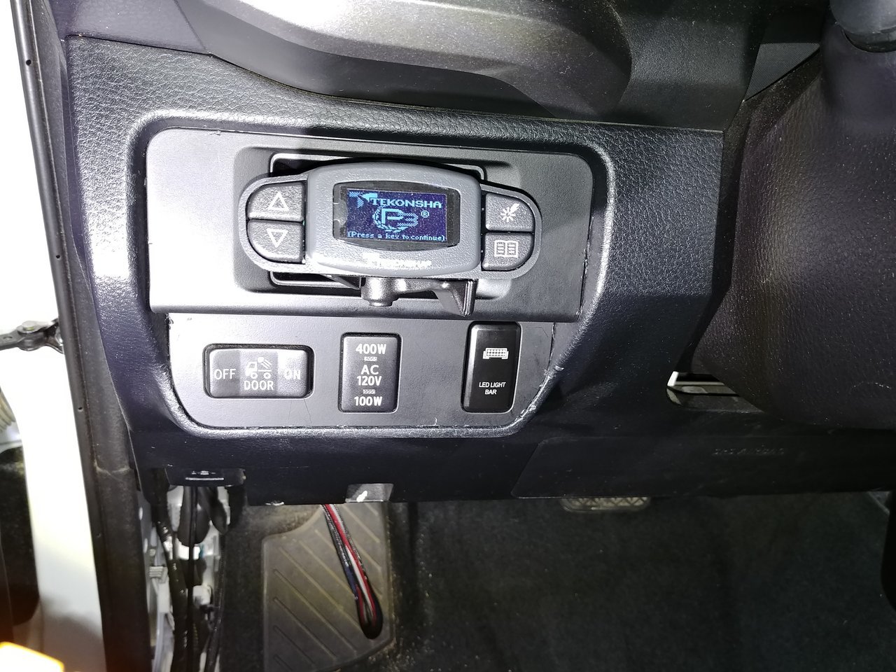

    Tekonsha P3 fits in the change holder of third gen. Still awaiting our trailer build date. Finishing up options this week

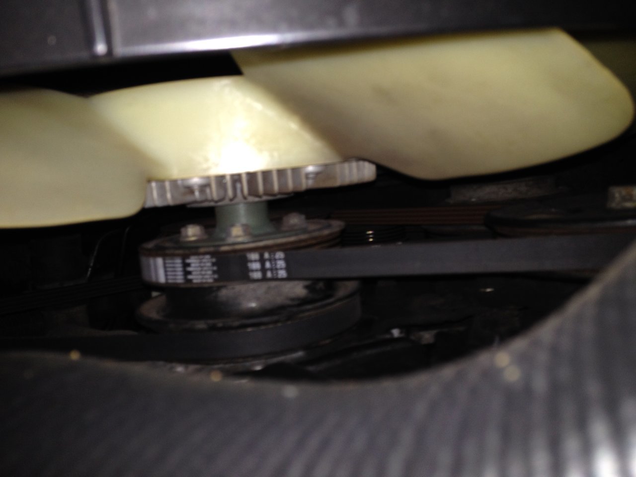

    I am trying to figure out if my current Tacoma will do the towing job. I am getting conflicting info from other sites, this page, and the manufacture info. Here's what I think I know. Also curious what your source is on the 5000lb towing capacity. I have an 03 V6 prerunner. According to Toyota there is a tow package but it appears to apply to the radiator fan. Orange colored shaft for the fan means no tow package, green means tow package. W/ package 6000lbs. W/o 3500 lbs. that's straight from toyotas online manual for the truck. I want to keep my truck but if 3500 lbs is all I have, it has to go. Help!

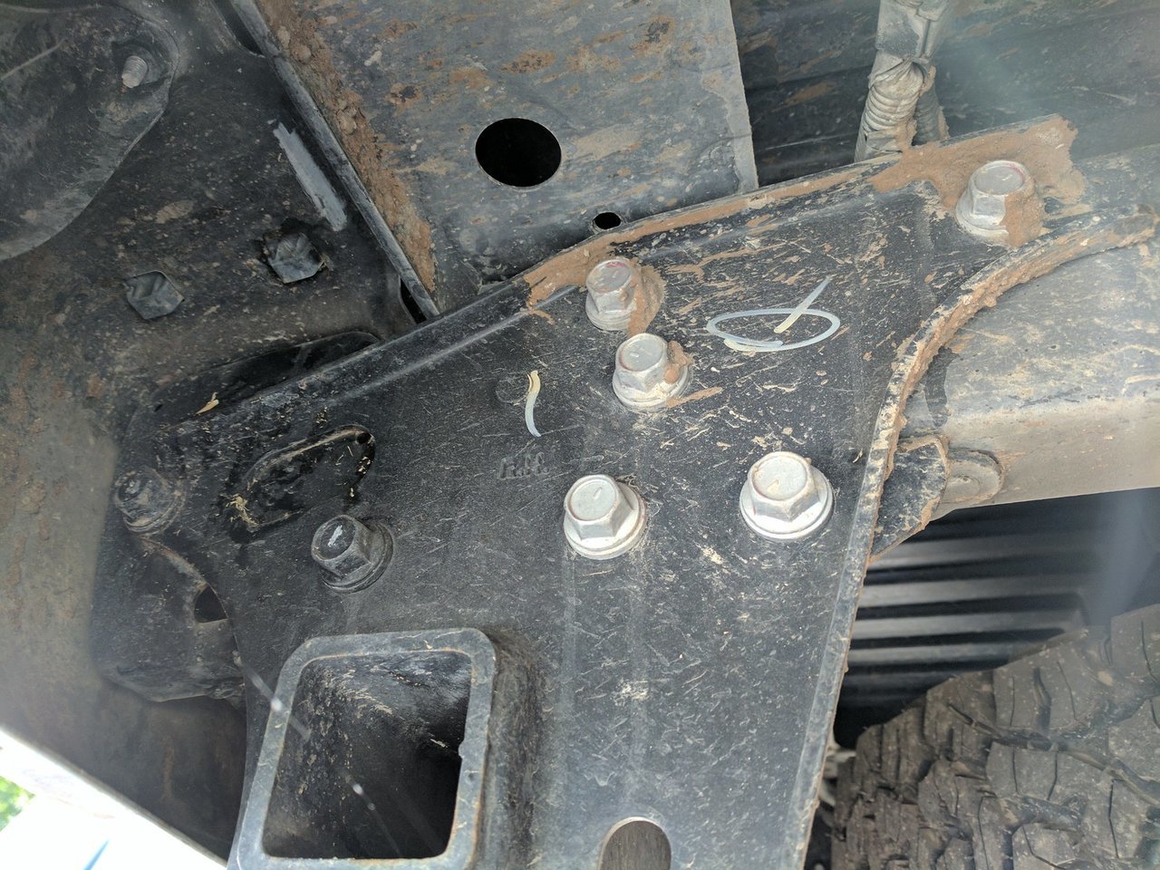

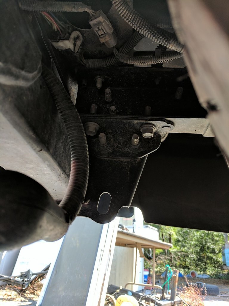

    I've been trying to search on here and google and cant find an answer.. Will the factory V6 receiver hitch (gen2) bolt onto an I4 (gen2)? I feel like this is well known and I just cant find the answer.
  12. Aug 10, 2017 at 3:25 PM
    #1472
    LeftCoastNerd
    LeftCoastNerd Old 'nuff to know betta
    Mar 27, 2016
    #182459
    1,890
    John
    Santa Cruz, California
    08 AC 4x4 OR 6sp
    this is what my gen2 v6 factory hitch attachment points look like... it appears there's not only the rear frame rail but two brackets, one bolted below the frame rail, and another bolted to the bumper, that the hitch itself is bolted to. I dunno if these are on the 4 cyl or not...

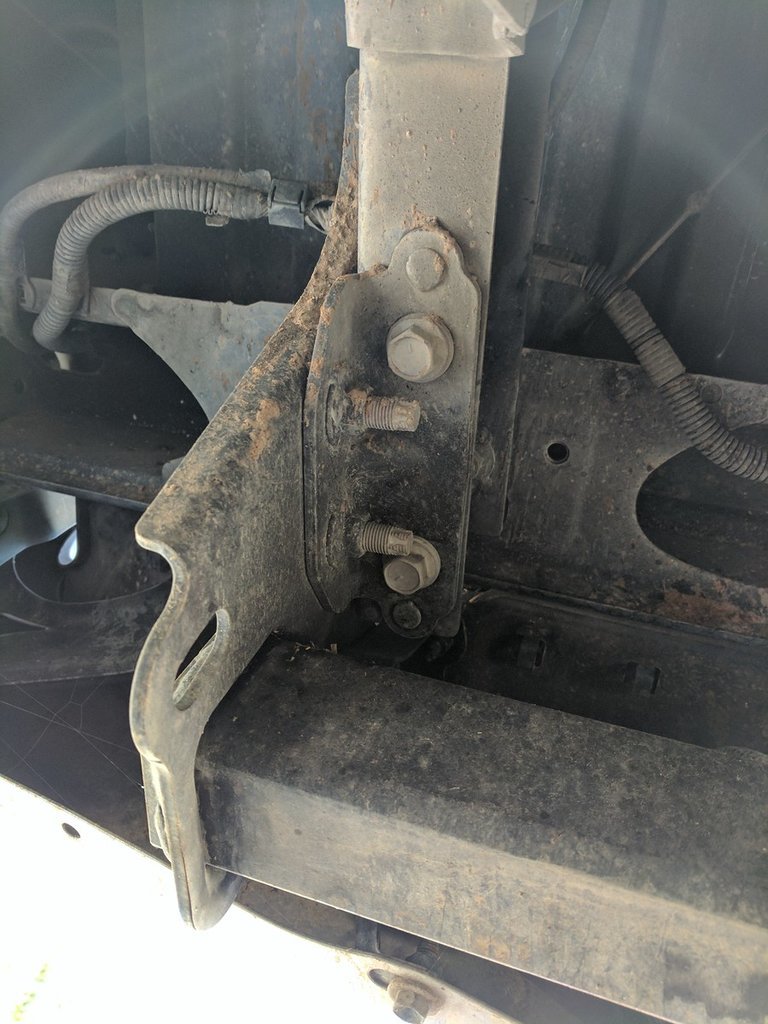

    Maybe the Gen 1 didn't have a towing package according to your specific definition, but it definitely did have a so-called "towing package" available. This is straight from my 2003 owner's manual:
    And here's a pic of my fan with the green part -- and a pic of my hitch, which I'm assuming was from the factory.

    Thanks for all the info on this. I added Tekonsha brake controller and Riderite airbags based on recomendations. Working very well. Now I just need to figure how to keep that tow ability with adding as 1.5" to 2" lift.
