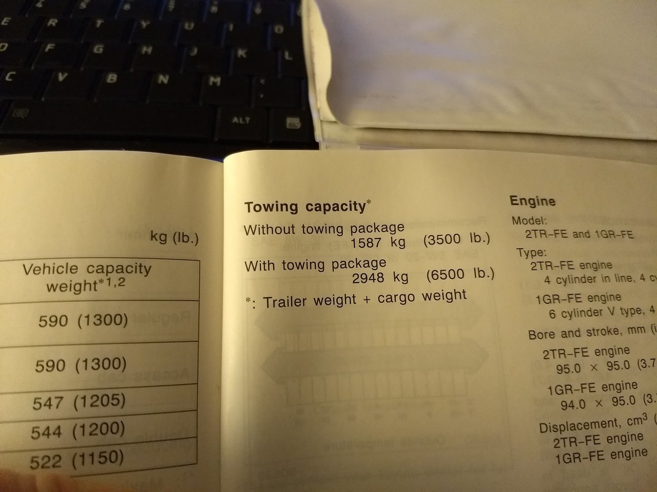

    I've been reading this Tacoma Towing Bible on and off for what seems like a couple of years now...learning about all the things I've done wrong towing over the years...
    Started out towing a 14' enclosed cargo trailer will all kinds of vending equipment with a '01 DC Pre-runner...trailer brakes, controller, but none of the other recommended stuff. Probably exceeded recommended weights, balanced improperly, etc. and survived to tell about it. Now that we are older and more safety conscious, we want to make sure we are being responsible and safe.
    Just want to run some numbers by the forum here for feedback.
    Short range objective is to travel with the wife from PHX to Baja for fishing and surfing. Wanting to get at least halfway down on the Pacific side...about 1500 miles r/t. Some of the intended areas are off grid and wanting some amenities to keep said wife happy.
    We've got an '07 2.7L AC, 133K miles, Ride-Rite bags, a Leer cap and diy bedslider...
    I realize we are limited with the 4 banger, but was hoping to find a double axle travel trailer due to lack of shoulders and pull out areas on Mex Hwy 1 should we encounter a blow out. One 250 mile pothole-strewn stretch from Catavina to Guerrero Negro has been taking its toll on vehicles.
    Have been researching the Winnebago Micro Minnie that has two axles, dry weight 2,980, dry hitch 300, GVWR 7,000, 31G fresh h20...
    I realize that only leaves a margin of 520 lbs. before maxing out the Tacoma tow rating. We'd really like to upgrade to a Tundra (and intend on doing that down the line despite the limited payload), but can't figure out how to swing that financially right now.
    We would definitely install oil and trans coolers, brake controller, WDH and anti-sway device (looks like Anderson for that), scangauge II (or similar system) on our Tacoma.
    Some specs on the 2.7L:
    GVWR 4,850
    GCWR 8,100
    GAWR Front: 2380 Rear: 2685
    Max Tongue weight: 350
    Towing the micro minnie, would we be within the allowable limits for our vehicle?
    We also need new tires before the trip and were leaning toward p-metric (for everyday driver comfort) all-terrains (Falken Wildpeak AT3/W, Michelin LTX AT2 or BFG KO2), but after reading from p. 78 back to p. 50 it seems some recommend LT for the stiffer sidewalls.
    Would LT tires be needed in this scenario?
    Also, looking at upsizing from 215 70R15 to 235 75R15 for more AT tire options. It sounds like we will lose some low-end torque. Will that be a problem? Any way to mitigate loss of torque without a re-gear (i.e., computer chip/software)?
    The last thing that is a bit confusing is our Tacoma manual states the the towing capacity w/o towing package is 3,500 and with towing package is 6,500. Why is it showing a 3,000 lb. difference in towing capacity?
    All feedback is appreciated.
