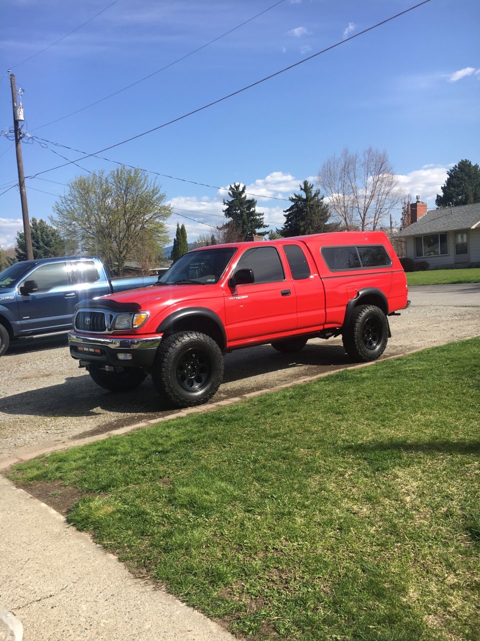

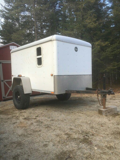

    What’s everyone’s take on towing a 6x10 cargo trailer with general camping supplies and a motorcycle in it with my pickup?
    I’ve got a 04 ext cab, it has the 3.4l 5 speed with the factory tow package and a added brake controller. Eventually I will be doing the TBU once my front brakes wear out. I’ve got a small lift and I’m running 32” tires on stock 4.10 gearing.
    I’m looking to buy a enclosed trailer for hunting and I figured a 6x10 is probably about the smallest size I could go for headroom. Anyone tow anything like this? I’m located in Washington state so I will be going over a few 4-7k foot passes. Mostly North Cascades and possible a few in Idaho.

    I’ve towed about the same thing on my 11, 4.0. I take it easy and keep it around 60 mph and have no issues. Gas mileage stinks. I have a cheap break controller also as I tow about a 3500 lb TT occasionally also.

    What’s your average mileage with towing and without? I assume the 4.0s have more torque then the 3.4? I think the 3.4 is 200-220 ft/lbs.

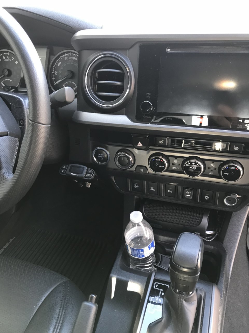

    Tekonsha Prodigy P3

    I get 16-17 mpg normally which is half city/highway.

    Tekonsha p3 install location
