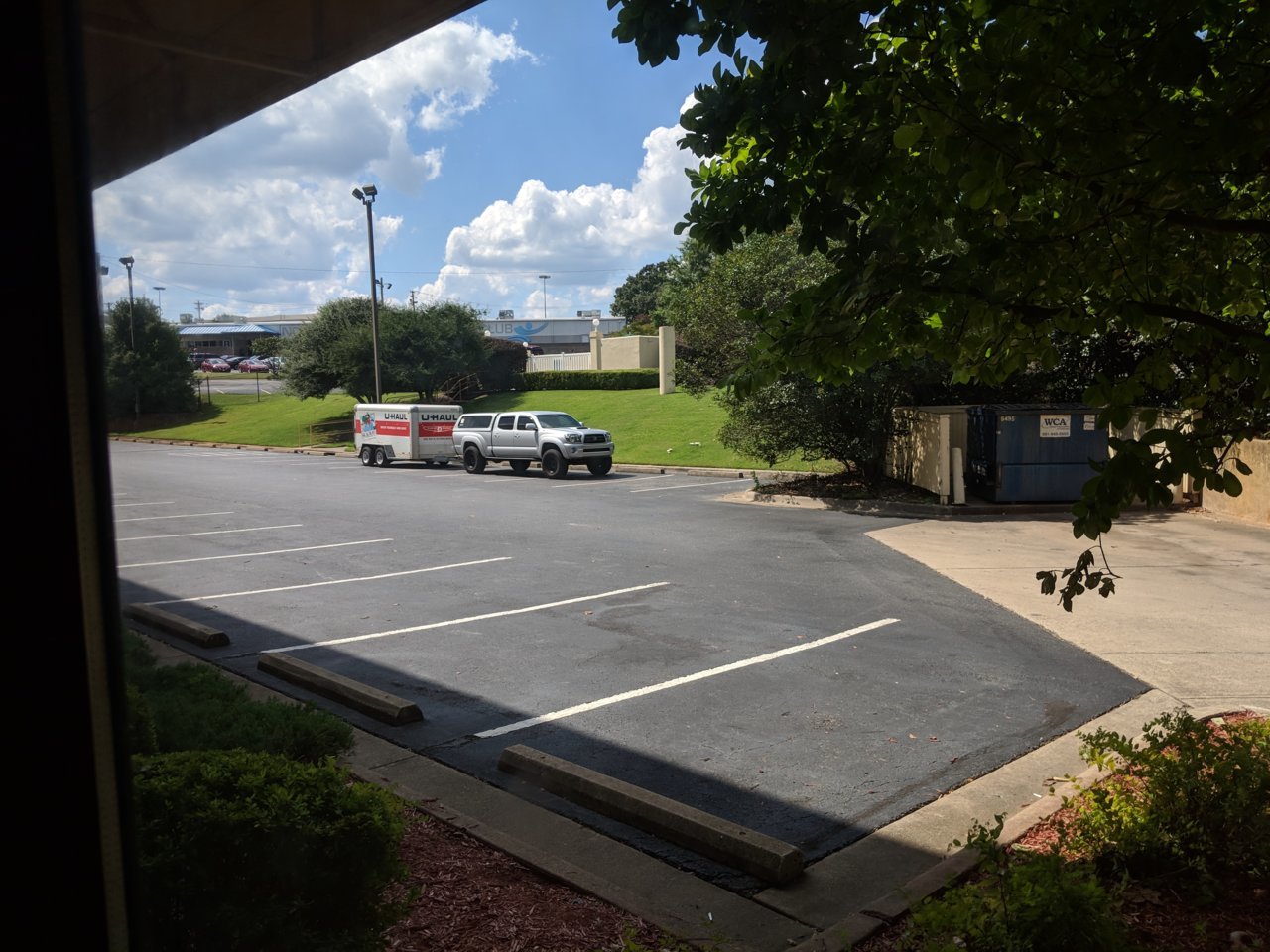

    Don't know if you've made your trip or not, but I can offer a couple of observations on a similar trip. I mentioned above that I was towing a 5x8 foot cargo trailer, loaded with similar stuff to yours, on a 800 mile trip to Florida (and then empty coming back). I ended up driving the entire trip in 4th, I tried for about 50 miles to leave it in 5th (auto trans), but it was continually hunting between 5th and 4th. It's not so much how much weight you're pulling as it is the aerodynamics of the truck/trailer combo. I had the same performance, both in pulling ability and gas mileage, on the loaded and empty portions of the trip. The total load wasn't anywhere close to the towing limit of the truck, I was pulling maybe 2000 lb when loaded, less than 1000 coming back. The trailer is a V-nose, but sticks up about 2 feet taller than the cab, and the drag was significant.
    I've pulled a 4x6 U-Haul cargo trailer and it was probably about 1800-1900 lb loaded. I hardly knew it was back there, pulled it on the I-state and stayed in 5th most of the time, much less hunting and shifting than on the trip to Florida, which was all interstate. The U-Haul trailer wasn't as tall as the cab of the truck, so it apparently didn't create as much drag. Take that into consideration when you make the trip.

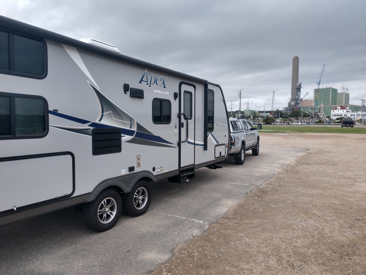

    Bilstein 6112 4th notch Bilstein 5160 rear Camburg ball joint UCAs Old man emu dakar leafs 265/75R16 Cooper ST Maxx Crux stereo a/v interface UltraGauge ARE fiberglass cap Wet okole seat covers Retro fit source Led fog lights Superbrightled pods in rear bumper Superbrightled light bar in grill Rock blokz mud flaps SOS Rock Sliders RCI Skid Plates (to be painted and mounted)
    If it was just me and a dog I could live in it to coachmen apex ultra lite 245bhs but not with my whole family
