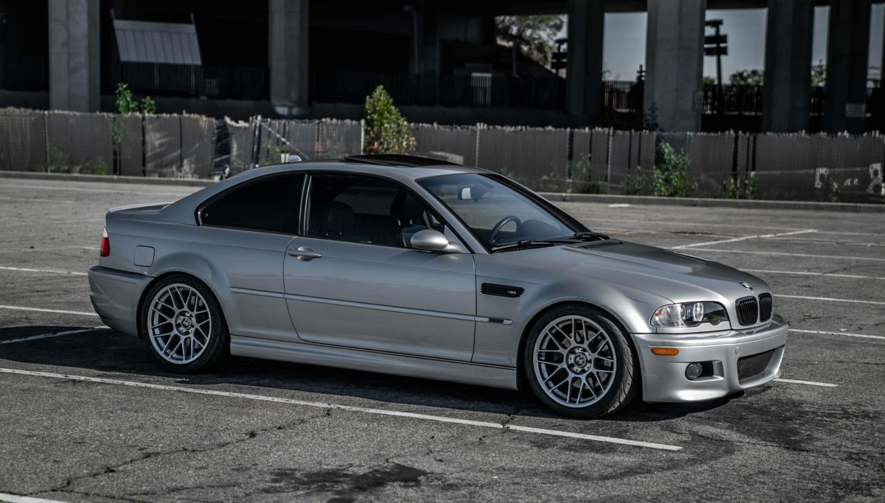

    Nice, I'm more interested in the M3 and how it went on the track. I'd love to track my NTM E90 335i. I'm running a MHD tune and it's fast but I need to upgrade the coolers before tracking it. :thumbsup:

    Still waiting for track pictures to be available but this is my E46 M3. This car handles like it is on rails!!! It's absolutely amazing on fun, responsive and forgiving this car is. Besides upgraded tires and coilovers, there is no upgrades. Brakes work great for what they are, but I am a late braker and will be looking to upgrade to Stoptech rotors and pads before committing to BBK (most people that get BBK don't even use BBK like they are suppose to). The S54 engine just screams at 8k rpm. If you can keep your speed/rpm high when coming out of a corner, this car is very capable of keeping up with the big boys.
    But to get back onto the thread topic. I use to track my bikes a lot but recently got into a really bad motorcycle accident and actually walked away very lucky. So I am taking a break from bikes and got back into a car. I plan on doing more track days so will be looking for a used aluminum car trailer. At first I was iffy about my truck hauling my car (supercharged Taco with 33" tires, not geared) but boy was I wrong. Of course with the help with a brake controller, I got up and down that mountain in LA with zero issues. I was thinking maybe selling the Taco and getting a full sized truck. Just wasn't all about that idea because driving a full sized truck as a DD sucks.

    Awesome. On the N54 its the opposite, big torque starting as low as 2.5k and shift at 6k. But the Twin Turbo N54 (tuned) gets hot quick so for now its quick blasts for me. Anyway you got through the grapevine okay so your good. In the summer it may be different. The 4.0 Tacoma's pull very well for a midsize truck. You have the blower so even more so but the cooling could be the only thing if you have to push it say in the summer months? I've been contemplating a full size truck also, but I drive the beemer whenever I can so the truck is just for bigger work jobs and offroad / recreation.
