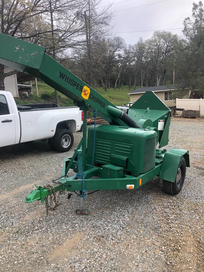

    Why does the V6 have a tow rating of 5,000 pounds while the 2.4L 4 cylinder only 3,500? Is it horsepower, or does the V6 have stiffer springs?
    I am looking to buy a wood chipper, and just haul it around the local area on rural roads, 25 mph, 40, up to 50 mph. No traveling on any freeway.
    Wood chippers tend to be heavy, unless it's just the piddling little ones with the 30 hp vee-twin Kohler motors. I'd like to get a drum chipper with a regular 4 cylinder engine like an Altec, Asphlundh, ... Often they have I6 engines.
    I just looked up the Altec 126A and it says it weighs 3590 lbs, so it is close. I'm surprised how heavy these things are.
    https://www.altec.com/site/uploads/WC126-A166a-Literature.pdf

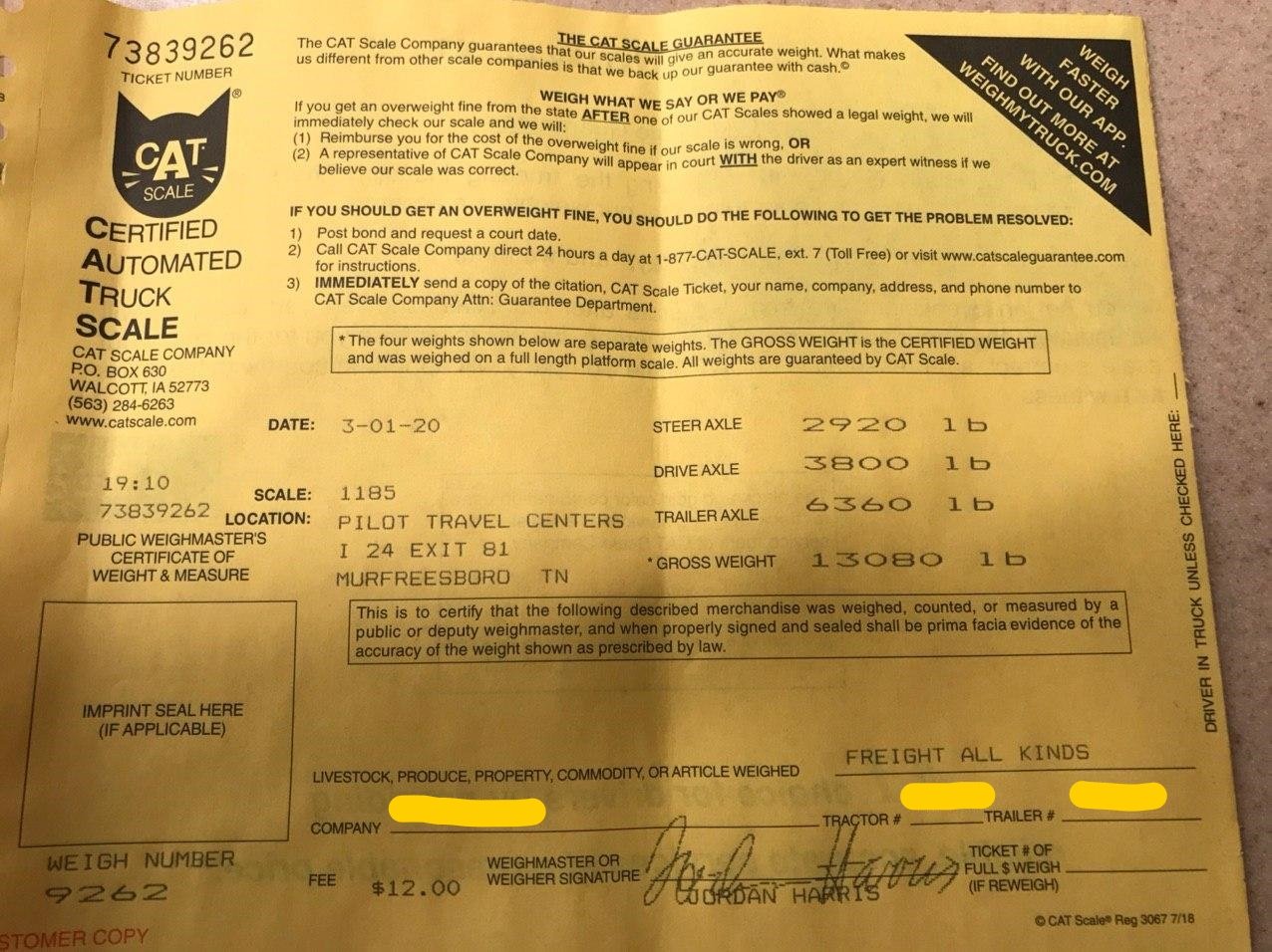

    The longer you plan to stay in it, the more inches matter. The tung weight of the Kodiak trailer could be an issue with just a factory tow package, also if you put that 3K in cargo in the trailer, you're quickly going to surpass the tow rating of the truck. I'd recommend adding something like the Sumo springs or airbags to the rear of the truck if you go that route. I've had my truck/trailer at 13K GCVW on 33's and 4.56 gears without a problem, so the truck can pull the weight. Though as Mike O mentioned the side surface area of a camper trailer in a crosswind could very well be more problematic. I didn't have anywhere near the side surface area to deal with. There was probably a time or two passing and being passed by Simi's @70mph with a sidewind that made the truck wabble a bit.
    Here's the weight ticket for this load of RR ties, on 16' flatbed. I pulled that in 4th gear for 200 miles without issue.

    KRAMERICA noted that he doesn't have near the side wall area with a flat bed of RR ties. Do yourself a favor and believe it when I tell you that the frontal area of a trailer will add considerable "weight" and instability when pulling at speed. With effectively no frontal *OR* side area, KRAMERICA has two less factors for instability in wind or as he mentioned a semi passing.
    Also, KRAMERICA mentioned Sumo Springs or air bags. An excellent recommendation. I have Sumo Springs and the did make some difference when I am loaded "heavier". Air bags may not be for you if you off-road hard.
