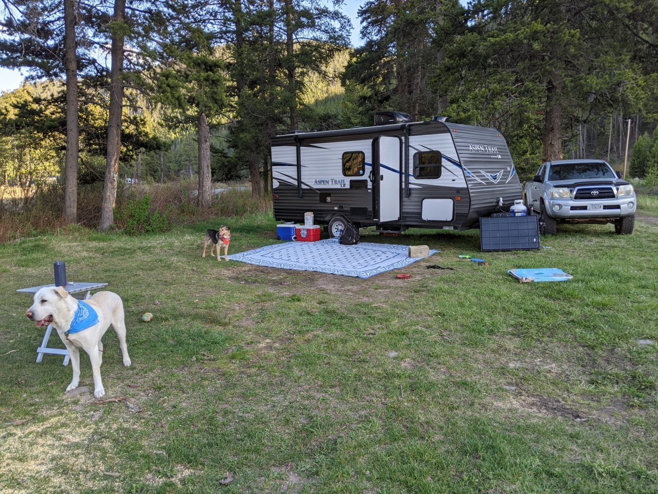

    A ton of good info here in this thread! Thanks for all who have contributed.
    I am looking into a 2019 Aspen Trail 1700BH. Here is a link to it so I can save you a google search. https://www.rvusa.com/rv-guide/2019-dutchmen-aspen-trail-travel-trailer-floorplan-1700bh-tr41384
    It has a dry weight of 3199 lbs, 651 lbs payload, and 452 lbs hitch weight. It holds about 700 lbs of water if I have to tow with the water tanks full. I am planning to have a weight distribution hitch, not sure yet if i'll need any airbags or anything in the rear. This should fall well within the V6 Tacoma with tow package limits, correct? Trying to make sure I'm not overlooking anything before I spend the money.

    You WILL be overweight before you pull out of the driveway. As you stated, even filling it with water puts you over weight.

    So after a little more research the water weight is not nearly as much, I was counting all the water tanks as full (grey/black/fresh) - and ideally won't be towing with any water in it. But ~200lbs of water leaves another 400lbs or so for any gear/supplies in the camper
    According to the sticker my payload is 1205 lbs.. -400 for my wife and I, -100 for our 2 dogs, - 500 for the tongue weight still leaves ~200lbs of capacity in the truck. Did I miss anything big on the trucks payload?
    Please point out anything i'm overlooking - I want to make this camper work (its a good price, in town) but I also want to be safe.

    Your going to need some sort of helper springs in the rear, even with a WD hitch. The stock leafs are pathetic by themselves. A 3 leaf AAL works great but does lift it a little if not loaded so not sure if you want that. Other than that if you have all the tanks dry when you roll you should be okay. Keep it out of D, shift as needed and drive safe. Enjoy

    Update to my earlier post: took it out this weekend and it went great! Towed fine, was even really windy the way back and I never felt like I wasn't in control. Only thing that gave me a hard time was reversing on some of the backwoods areas, definitely burned up a bit of my clutch life. Not sure what the trick is there. Thanks for the help all!
    Also: do not have my AAL put in yet, but did OK without it. Definitely still putting it in this week though.
