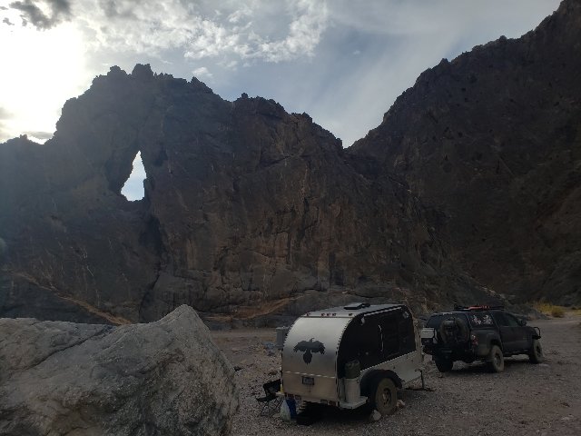

    Wild Crow
    Wild Crow Well-Known Member
    Oct 22, 2014
    #140868
    1,795
    James
    Anywhere is home
    2014 Baja
    I don't know if this helps you at all but...
    I have a 2014 Off Road V6
    Tow capacity is 6400
    Tongue weight rating is 640
    Tekonsha P3
    OME HD Dakar rear springs
    Max Coupler hitch
    No sway controllers
    My trailer is a home built teardrop
    Loaded weight is 3500
    Tongue weight is 400
    I've towed this trailer full time since last June over freeways, back roads, blm roads, forest roads, up 9000 foot passes and down them. All across the country with no issues. My truck handles 3500 lbs great
    Watch your braking distances
    Watch your corners
    You'll be fine
    Go camping

    HB Taco
    HB Taco Well-Known Member
    Apr 10, 2011
    #54683
    1,241
    Curt
    Huntington Beach, CA
    2019 F150 FX4 S Crew 3.5 TT
    Nice! Eye of the needle DVNP :thumbsup:
