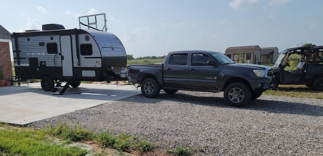

    Nice trailer man! I’ve been looking for one of the Vikings but they are hard to find on the west coast right now. Looking at Coachmen Clipper & possibly the bunkhouse R-pod for now.

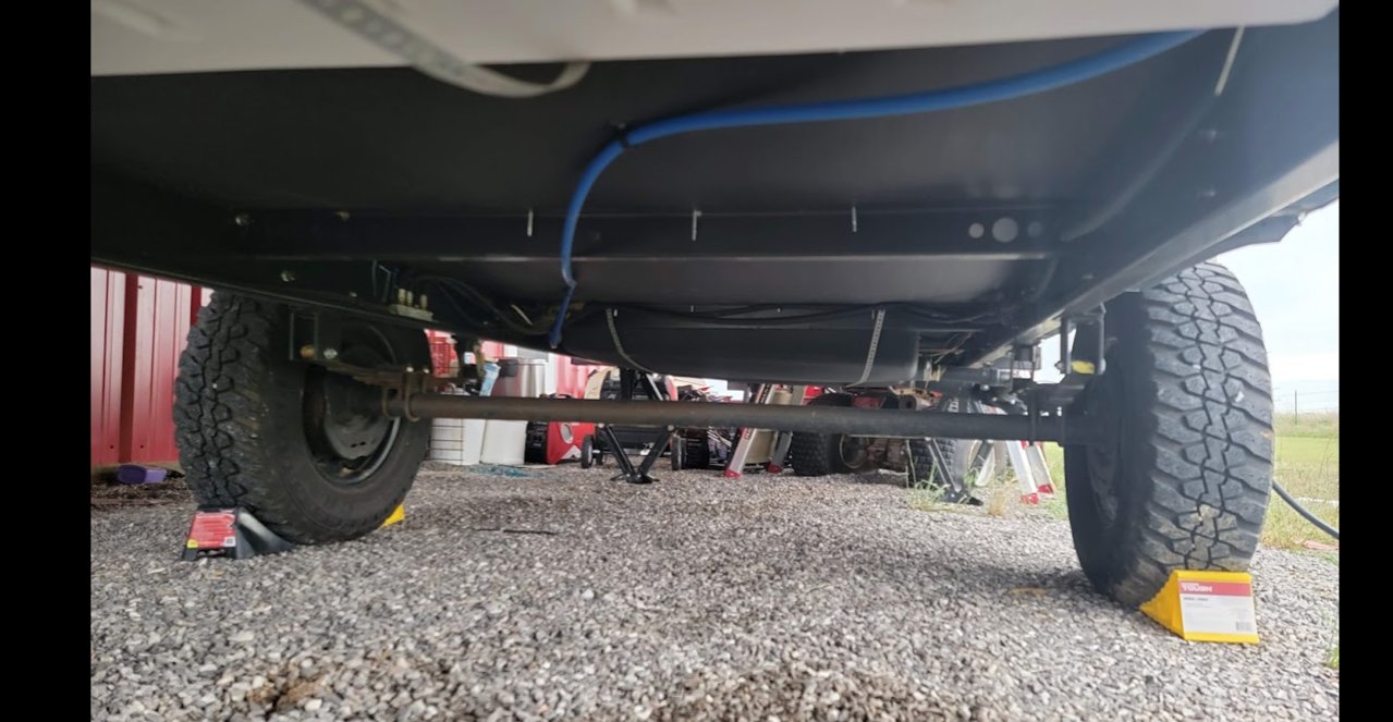

    Its been pretty good. Its a 2020, bought it used off a guy that used it about 4 times. Like that it has bunks and a little door by the bunks to access the storage under them. You can flip the bottom one up. Also front pass thru on the queen up front and the queen flips up for access. Had to replace the skylight, hail cracked it while with previous owner. Replaced it with a tougher Icon one. Think they are Polycarbonate. Much thicker. Got one window that leaks, think its just shitty sealant job. And outdoor speakers dont work. Yay! Joys of owning a camper, lol. Oh and i have a leak on the back of the toilet, ugh.
    I do like the spring over axle with bigger tire (off-road package, lol). Didnt think i would care for it, but i have seen it save me from dragging the sh*t spout on some occasions already.
    The mini door. Kids love the escape hatch.

    Yep, liked all those features too. The Clipper has pretty much the same floor plan and features (pretty sure Coachmen makes Viking too). My pop up is an ‘07 Viking. Same thing, lots of little annoyances from crappy materials, but unless you want to spend Lance money I think the build quality is pretty close to the same on most of the $20-30k models with a few exceptions.

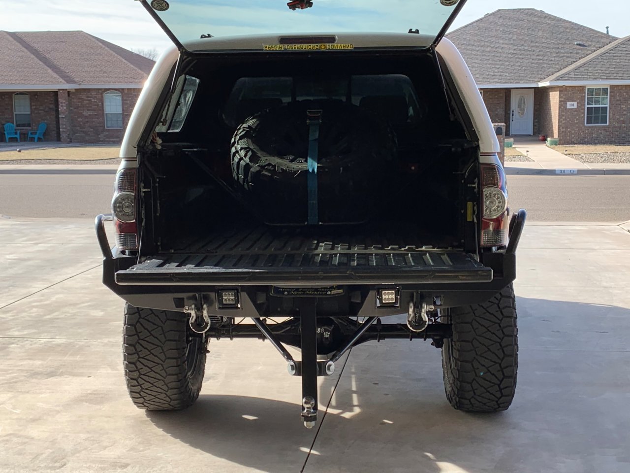

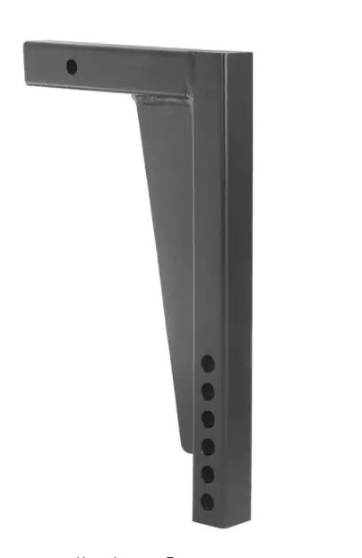

    Ha lol - Yep, will need to determine height of trailer (level or slight nose down) and then get a drop hitch that allows for a WDH setup
    This one we custom produced for hauling my enclosed trailer with my Quads, we added the Swedges with heims to reinforce/reduce the movement.
    the trailer we are looking at sits up higher than my toy hauler - so hopefully wont require a 18" drop hitch

    They make 16" drop hitches that except WDH setups, and with the airbags, swedges etc. I think we will be fine - will post pics and results as we go along.
    will set the truck up with the airbags, aux trans cooler, get a WDH drop hitch then rent a trailer (from the Base - military) that is comparable in weight and size to see how everything handles before purchasing a trailer to rule out issues etc.

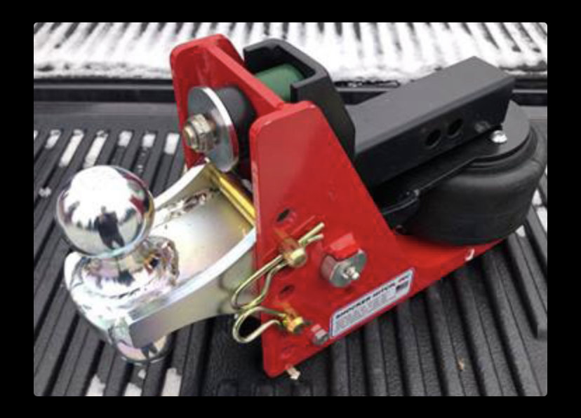

    I picked up a shocker hitch recently but haven’t towed with it yet. Absolute overkill for my 6x10 trailer but if it makes towing better and reduces wear & tear then I’ll be happy. I’m looking to upgrade to a 6x12 or 7x16 in the future.
    I’ve got an ultra gauge to monitor trans temps and want to get a brake controller and upgraded trans cooler.

    What’s the weight rating for this? Seems like a lot of moving parts and bushings carrying the load.
