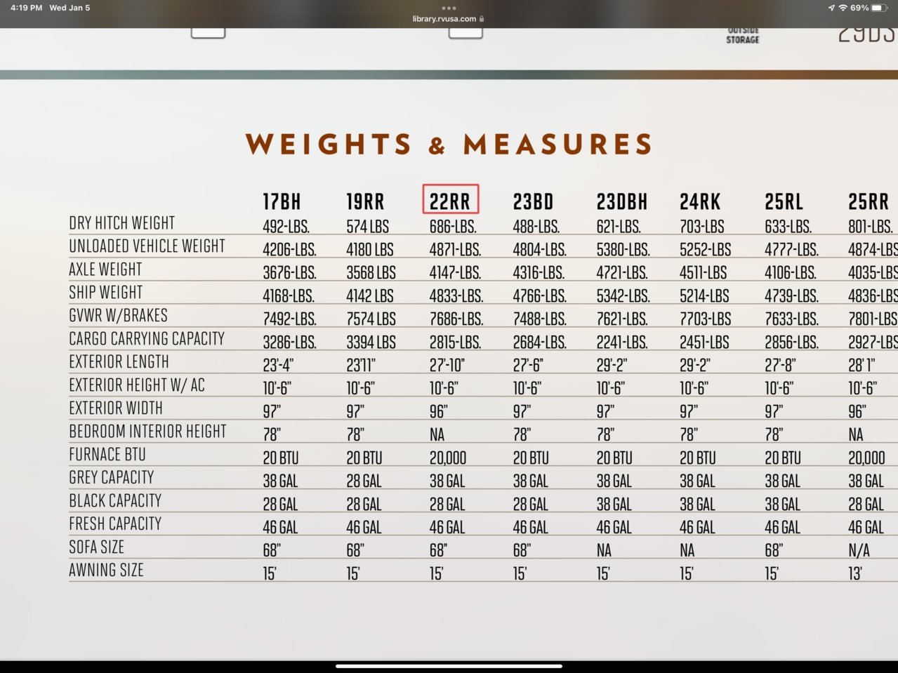

    i HAVE A 2020 TACOMA OFF ROAD and am considering buying this trailer but not sure if my rig will handle it ? Thanks for you input
  14. Jan 5, 2022 at 3:52 PM
    #1914
    YF_Ryan
    YF_Ryan Well-Known Member
    Feb 23, 2017
    #211450
    5,760
    Kent, WA
    2011 Silver Tacoma TRD Offroad, 2022 Honda CB500X
    Icon Coil Overs. Deaver U402 Stage 3 Leafs w/ Bilstein 5160s. ARB Deluxe Bull Bar. Fuel Boost wheels w/ Wrangler Duratracs. Brute Force Fab Sliders & HC Rear Bumper w/swingout
    That's a no. The hitch weight is already overweight from the get go. The trailers GVWR is also well beyond the Tacoma's max trailering weight.
  15. Jan 5, 2022 at 4:17 PM
    #1915
    Dog_River
    Dog_River Member
    Aug 8, 2020
    #337023
    8
    That is what i figured but I cannot find a tongue weight anywhere for my truck

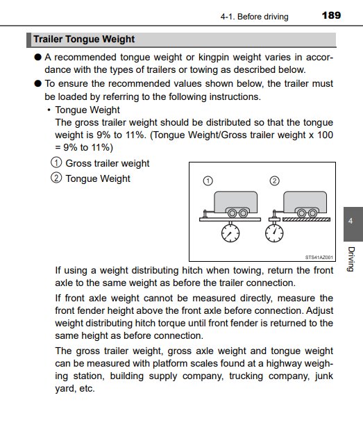

  16. Jan 5, 2022 at 4:24 PM
    #1916
    YF_Ryan
    Feb 23, 2017
    #211450
    5,760
    Kent, WA
    I believe it's 10% of your towing capacity. my 2nd gen, it's 650 (6500 max tow). I believe the properly equipped 3rd gen is 680 (6800 max tow)
  17. Jan 6, 2022 at 10:06 AM
    #1917
    Dog_River
    Dog_River Member
    Aug 8, 2020
    #337023
    8
    Not that I don’t believe you but I would like to see some Toyota documentation on this. Thanks for your input.
  18. Jan 6, 2022 at 11:42 AM
    #1918
    jpereira2
    jpereira2 Well-Known Member
    Dec 20, 2013
    #118928
    6,362
    Jason
    Massachusetts
    2013 double cab trd off road
    Bilstein 6112 4th notch Bilstein 5160 rear Camburg ball joint UCAs Old man emu dakar leafs 265/75R16 Cooper ST Maxx Crux stereo a/v interface UltraGauge ARE fiberglass cap Wet okole seat covers Retro fit source Led fog lights Superbrightled pods in rear bumper Superbrightled light bar in grill Rock blokz mud flaps SOS Rock Sliders RCI Skid Plates (to be painted and mounted)
    Manual has capacities listed for different configurations. 10% is correct though

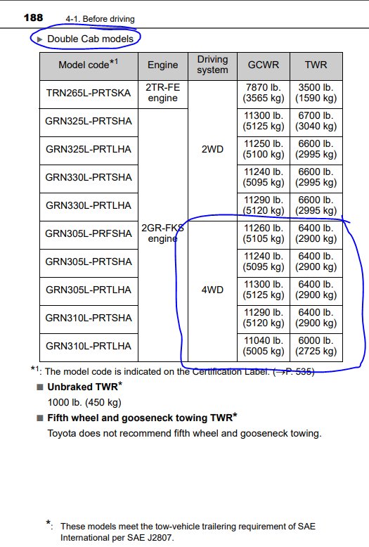

  19. Jan 6, 2022 at 12:21 PM
    #1919
    YF_Ryan
    Feb 23, 2017
    #211450
    5,760
    Kent, WA
    EDIT: These are from your owners manual.
    Assuming Double Cab:
    jpereira2 likes this.
