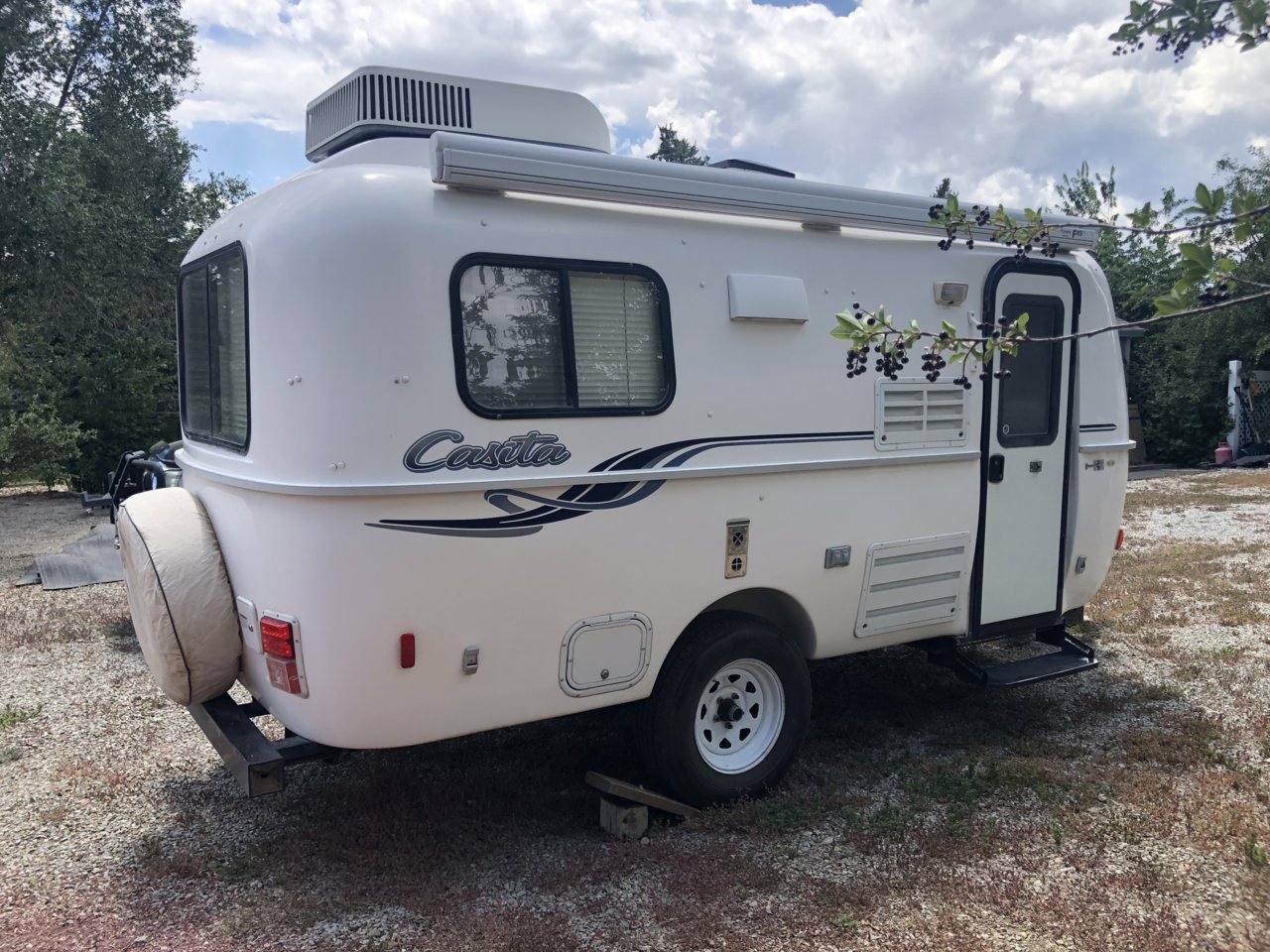

  18. Aug 25, 2022 at 8:31 AM
    #1938
    Ridgewalker1
    Ridgewalker1 Well-Known Member
    Sep 20, 2021
    #377594
    327
    Philip
    Longmont, CO
    2003 Tacoma TRD OR, 2015 Tacoma TRD OR
    2003 1 5/8” lift, 235-85r16 BFG KO2, ARB Bull Bar, Warn M8000, sliders, Snugtop; 2015 Hefty Fab al bumper and sliders, Warn Zeon 10k, Rago bed stiffeners,
    My new (to me!) camping trailer. 2015 Casita Deluxe to go with my 2015 Tacoma. Needs a bit of tweaking(customizing to fit our needs), but all-in-all great shape!
