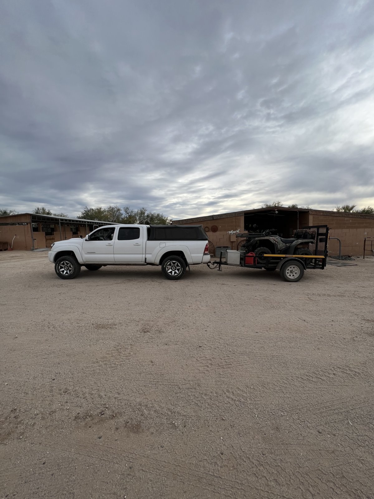

    I seem to be reading a lot of mixed reviews on towing in D vs 4. Out of precaution on the way home I kept the truck in 4 but boy did it kill my fuel mileage. My coworkers letting me borrow his quad for the rest of the year I’m towing on nearly flat highway posted 65-75. Can I keep it in drive? 06 sport package no secondary trans cooler.

    I typically get around 17 on the highway and use just under a 1/4 tank getting to my hunting spot. I got home with less than half a tank. I only towed the quad on the way home. But just to maintain speed not going over 72mph I was running around 3k rpm. In drive doing 75 I’m normally at 1800 rpm. I am not climbing hills or going down any steep grades, 2400 feet of elevation to 3040 feet over 70 miles. Not sure exactly how to tell if the converter is locked or not. Any input? @YF_Ryan
