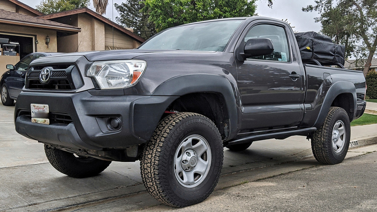

    A little of this and a little of that.

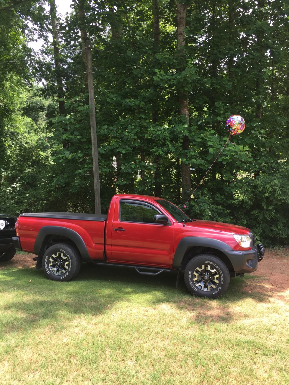

    Terri, the Tiny Taco is a neat little truck. Awesome build thread!
    I also have a 2013 Regular cab, 4x4, auto truck. I did the cruise control mod as well, no pre-wire for me either, but it’s not too tough and it’s worth it! My daughter is the primary driver and she has the truck at college. Eventually I will get the truck back and then I’ll do some stuff.

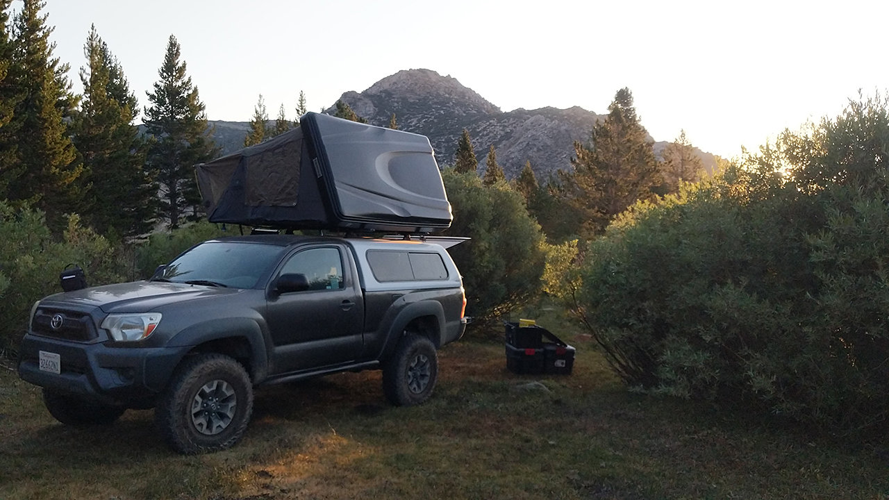

    I guess it's been long enough since the last update. Sometimes it's hard to find the time to get on here. I work 12 hour shifts, 7 on and 7 off, with a 1 hour commute each way. Things have been crazy at work and I have been working way too much OT. I also ended up getting a puppy and that has taken up a bunch of my time.
    On with the update. Now that The Taquito is lifted a little and has some decent AT's, it was time to start thinking about how I was going to camp with her. I would just sleep in the back of my old Tundra, but this bed is a little shorter. Being 6'5" and in my mid 40's with bad knees, a ground tent was out of the question. A few friends of mine have roof top tents and I have always thought they were kinda cool, so I decided that was the route I wanted to take. Then came the decision on how I was going to mount it. I did not want a big ass bed rack. I also wanted to keep the top of the tent pretty much even with the top of my cab. I did some research and ended up getting the Smittybilt RTT and a couple of 4" rise bed bars, from 4Xinnovations. After some prep and paint, install was a breeze.

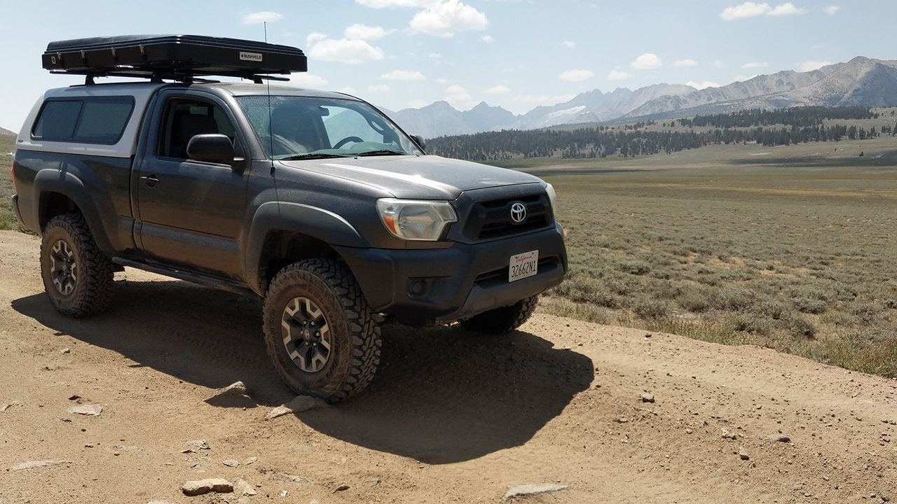

    As time went on and my Pup got bigger, I knew that the RTT was no longer right for me. I just could not keep picking him up and putting him in the tent. It was more of a size thing than a weight thing. I was also getting tired of playing the cooler game on long trips and wasn't about to spend all that money on a 12 refrigerator, just to have it get all dusty in the back of my truck. It was time to rethink the setup. I decided to get a shell and a hard shell RTT. I figured a hard shell RTT would be more aerodynamic than the brick shaped Smittybilt. I did a bunch of research and decided that I was just going to order a new shell so I could spec it out with the options that I wanted and to make sure that it can handle the weight of a RTT on top. I went with a SnugTop Cabhi and optioned it with the Sportsman Package that gives the roof a load rating of about 500 pounds. I also got the roof tracks, Rhino Rack cross bars, sliding front window, carpeted headliner, pet screens on the windows, 4 USB ports and a 12v outlet that are always hot. As I've said before, this truck will never be a beauty queen, so I had them paint it white. Color matched would have looked better, but my pup might get too hot if I decide to sleep in (that never happens). White would also work better while I was driving. My gear wouldn't get as hot and the fridge wouldn't have to work as hard.
    For the hard shell RTT I went with the OVS Bushveld. Once I put the tent on the truck it felt very unstable and had body roll for days. These little Reg Cabs just don't have the size and weight of the V6 AC & DC. It takes a lot less to make them feel top heavy. This was around late spring, early summer 2021. Supply shortages were in full effect. I parked the truck and canceled all trip plans until I could get the rear suspension back up to par. I contacted Deaver and had them build me a set of their Stage II leaf springs. While I was at it, I ordered some Bilstien 5160's. Those parts took a bit over 2 months to get in. By August of 2021, it was all installed and I was able to take my annual summer trip up to Coyote Flats.

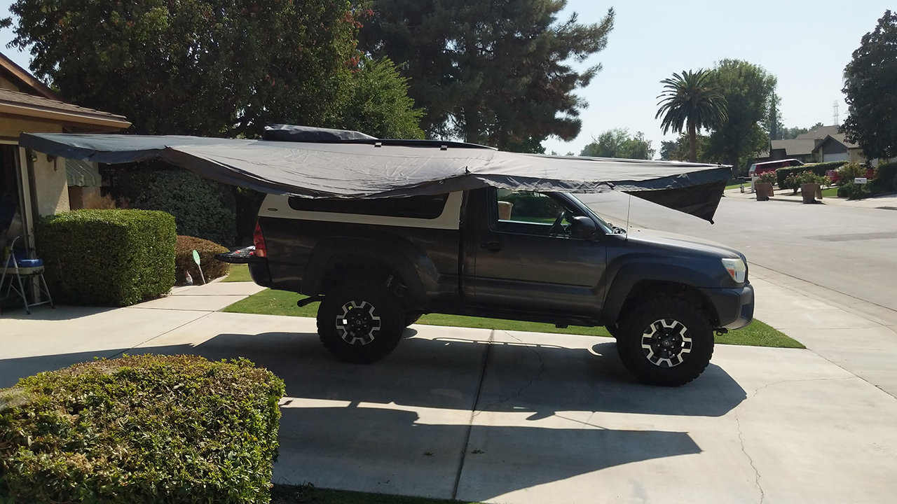

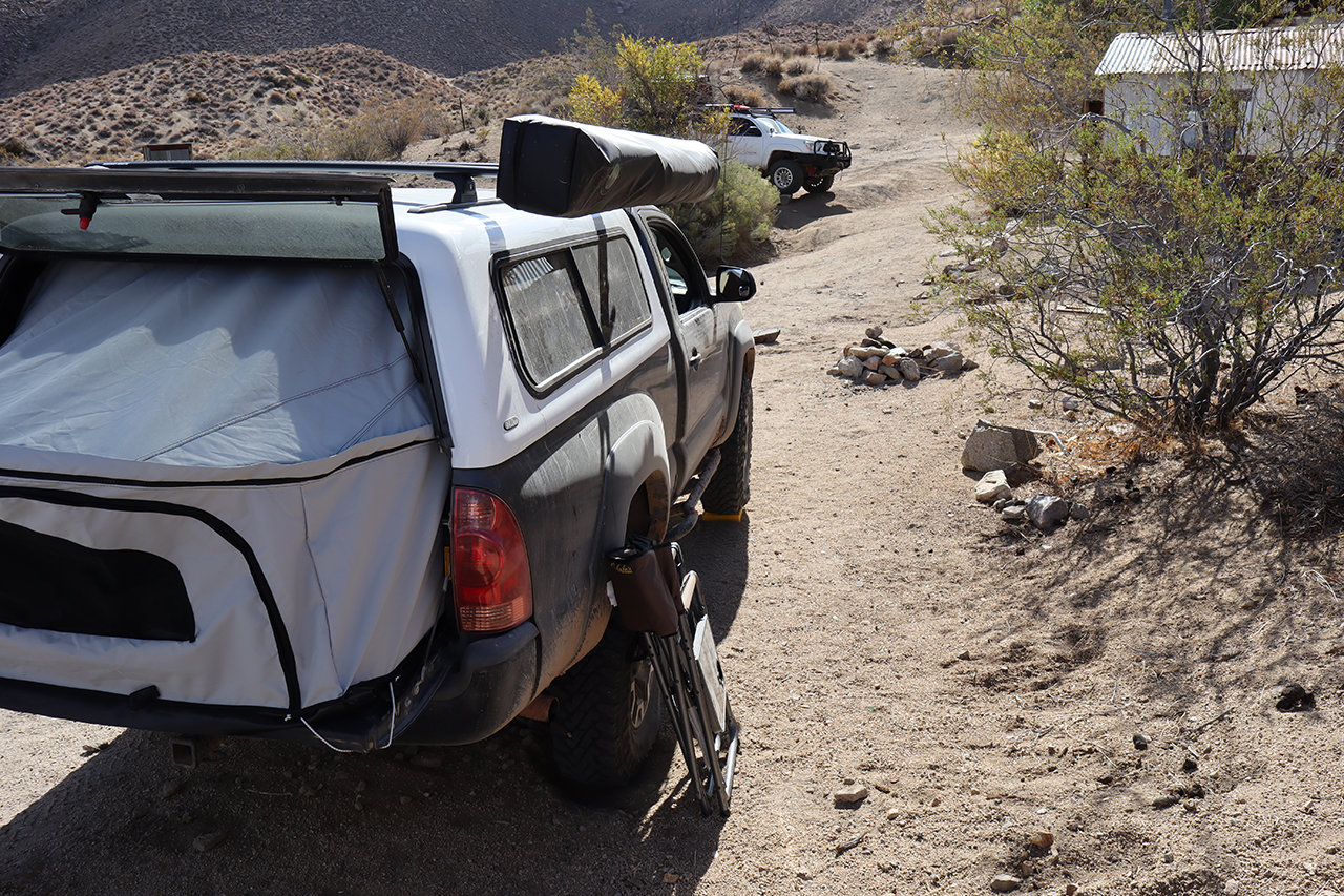

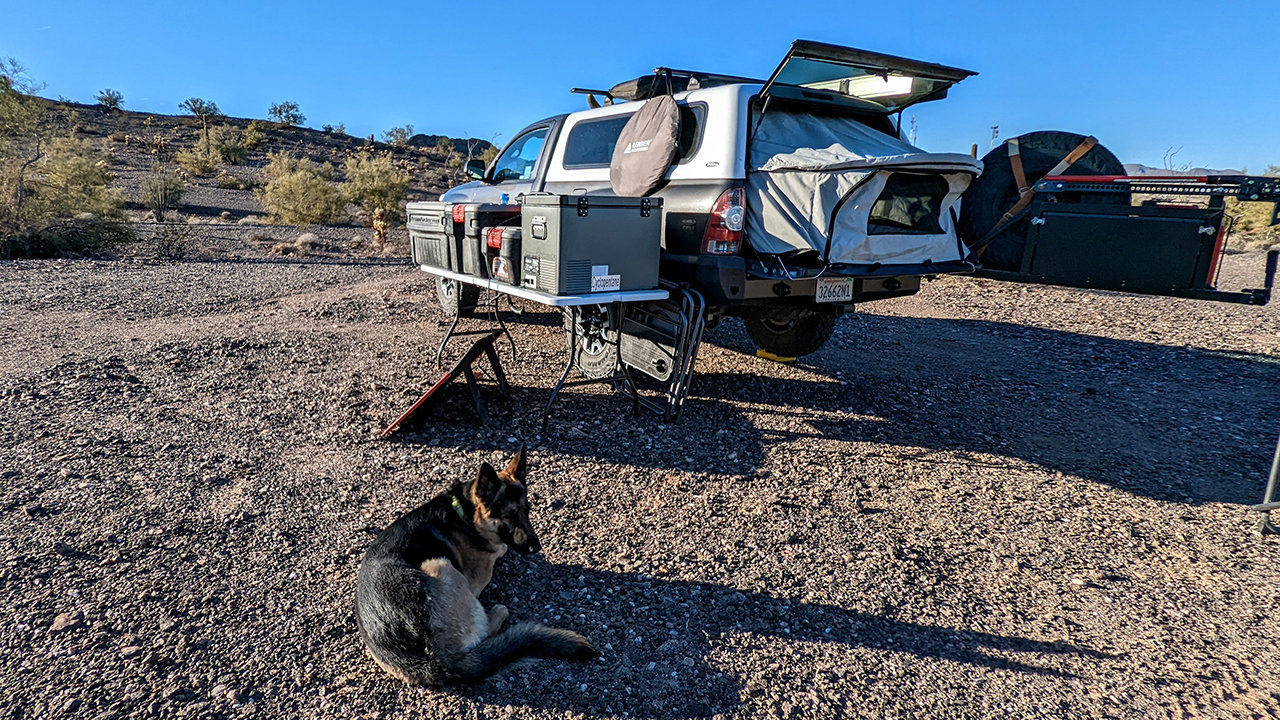

    So, um, that last setup lasted for 1 trip. I hated it!!! Not only was the RTT uncomfortable, it was a pain to pack back up. Don't get me wrong, it was a fine product and I had no quality issues with it, but after three nights in it, it just wasn't for me. The aerodynamics of it also sucked. Even with the 5.29 gears the truck was struggling way too much when the wind kicked up. This wasn't a problem with the tent, it was just the wrong product for my setup. Since I only spent a few nights in it and it had only been on my truck for a couple of weeks, the fine folks at OVS let me return it. I thought I'd return their kindness by giving them some more of my hard earned money and picked up their 270 awning. An awning was on my list of things that I wanted, so I figured it would be a good time. I drove down to their warehouse and it was a pleasant transaction. Here's a poser shot of the awning in my driveway.
    For the new sleeping setup I went with the Topper EZ Lift Nomad package. It just basically Velcro's inside the back of the shell and straps to the tailgate. I am way too tall to sleep in the back of the truck with the tailgate up. For a mattress I just went with a tri fold setup. My first trip out with this setup was a 7 day trip through Utah. Besides now having to sleep next to a dog that sheds way too much and is a bed hog, it's pretty comfy.
