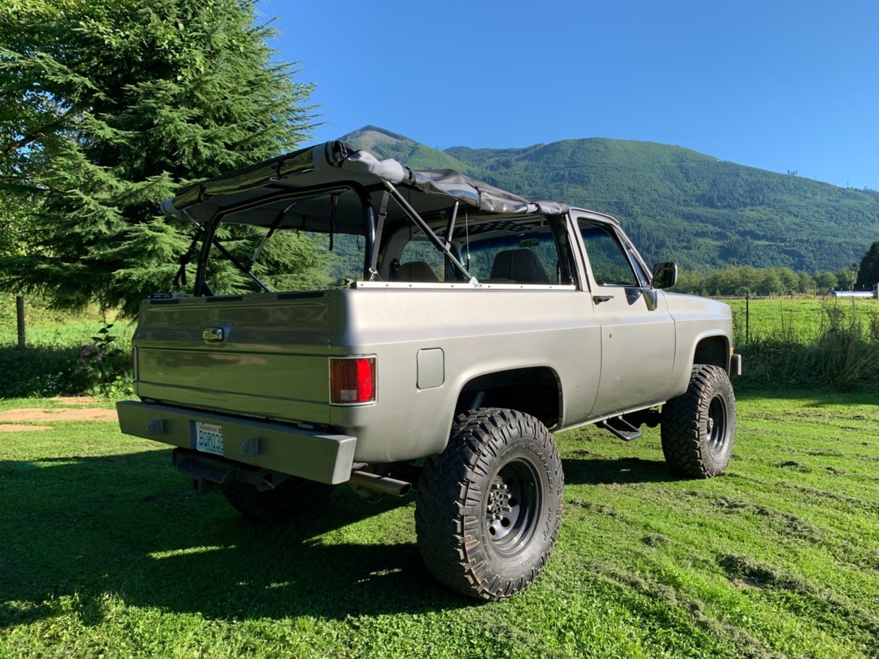

    This is what I was building on the past couple years instead of the Taco. I just sold it last week. Moving and need the funds + wanted to start modding the Taco. Now I have the funds for both however I have some serious sellers remorse. Was my dream truck. I will build another one though.

    man like that!
    BF had a chevy K5 454 with 6" lift and 40's... bada$$! he sold his too... seller's remorse too.
