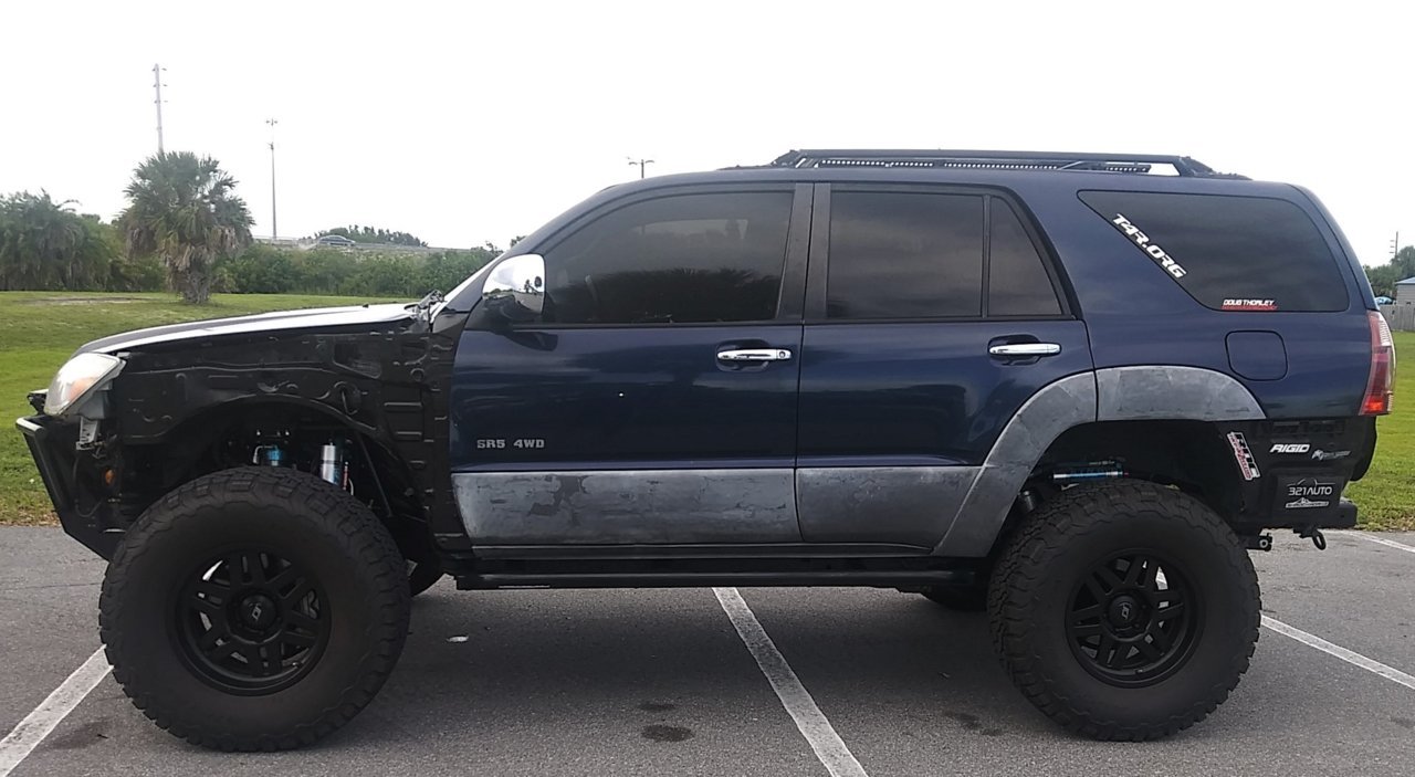

    I had a TC Dual Shock-stock length on for years and it did pretty well, but I got more enticed by the day to go LT.

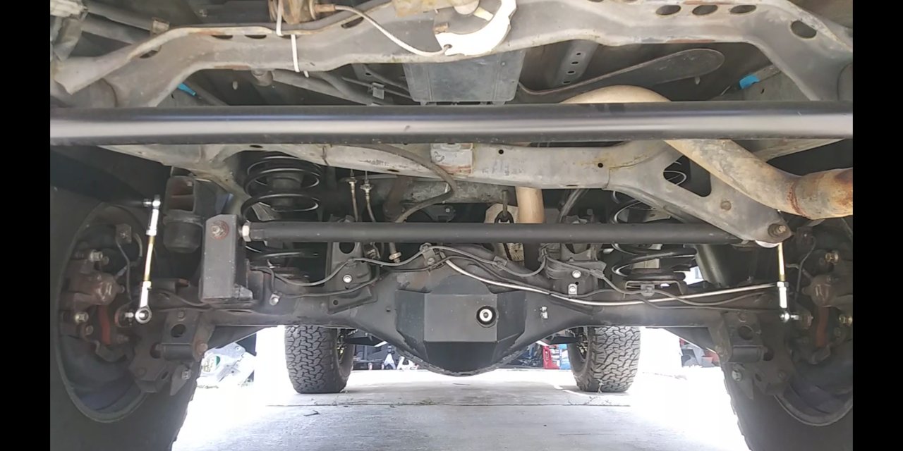

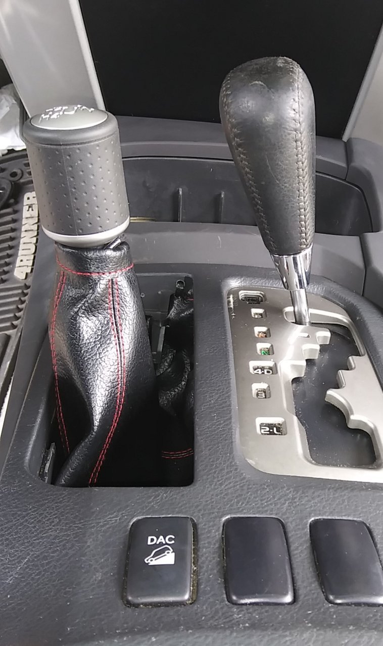

    Toyota's 8.0 diff got the 4:56 Nitro gears, axles, and ARB upgraded housing I purchased from a really good guy in San Diego, and the electronic T-case was swapped to a manual out of a 2012 4Runner.

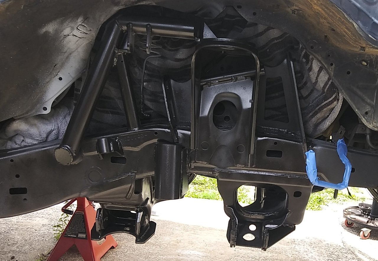

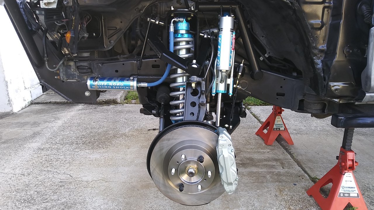

    The LT took awhile to get started on but it's getting there. The fenders will go on in a month or so. Word of caution if installing the MC tab gussets, as I overlooked the Zerks on the DK lowers clearing the gussets. So provisions had to be made.

    Looks good! How does the rear feel in comparison now? My rear end is already being way outperformed with just the DK stock length setup and no bypass.

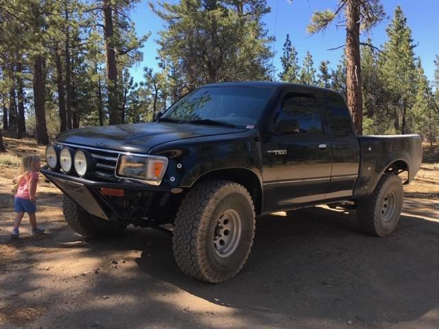

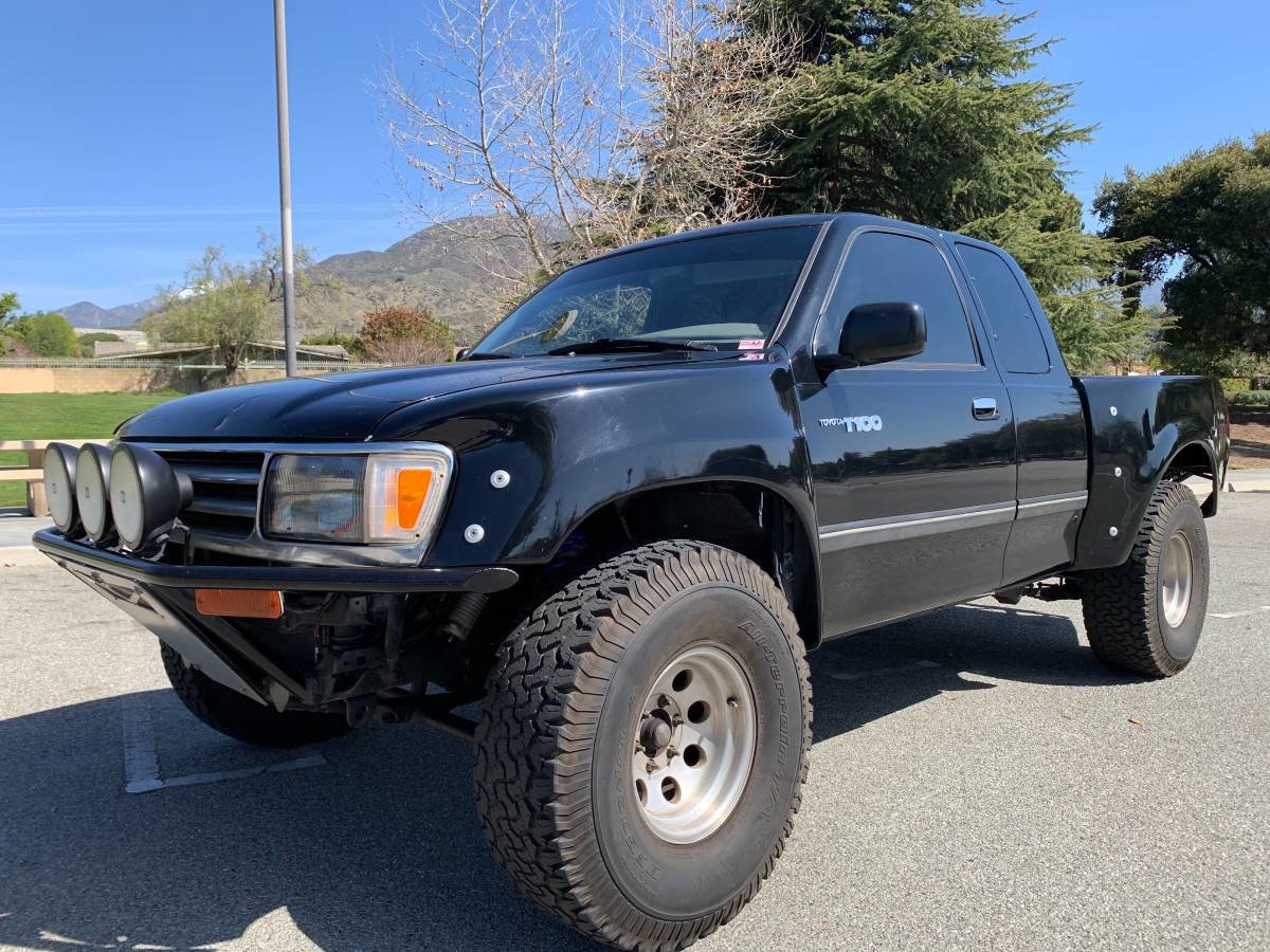

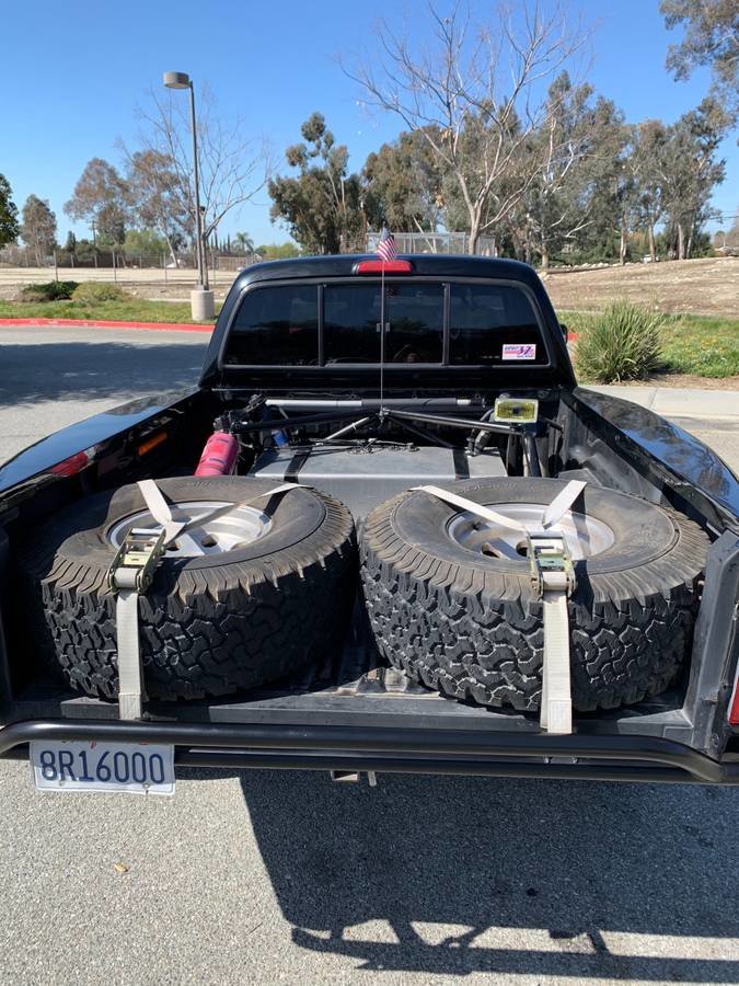

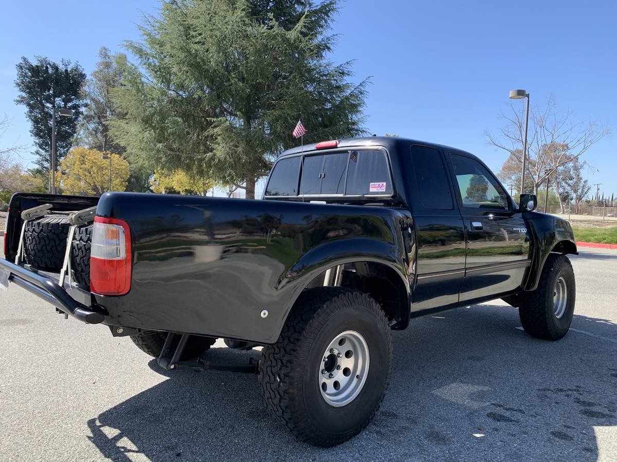

    I took a 4.7 out of a Tundra and put it in my long travel T100. This was my favorite truck (so far). The little V8 screamed with 35’s and 529 gears.
    Front was an old Duffco kit adapted to fit the wider T100 frame with fox coilovers. Rear was 64 inch Deavers, a cool frame pocket notch and Fox triple bypasses outside the frame rails.
    This was my little homage to the Ivan Stewart Toyota.
    Loved it.

    Thanks! Years ago I did a Califab rear link system and a King 10" 2.5 smoothie w adj. to go w the stock length TC kit that I had. Travel numbers are a little less than 10" though. So it's kinda keeping up, but the front still needs a lot of tuning also. I'm gonna be wearing out my super bumps for the time being.
    I have plans to redo it w 14" triples, but we'll see how that goes.
    I'm am way over my head and lacking fab skills, but learning everyday.

    Yes, I want to say it was an A340e, if I’m not mistaken.
    Whole setup was stout, once we worked the bugs out. As I recall, we used a Dakota Digital speed calibration tool to modify the signal from trans internal speed sensor before it got to the ECU. Without it the trans was constantly in the wrong gear.
    Once we worked it all out, I put 100k+ miles on the conversion with no real problems. California smog legal, working heat and AC. Toyota to Toyota makes for a very reliable engine swap.

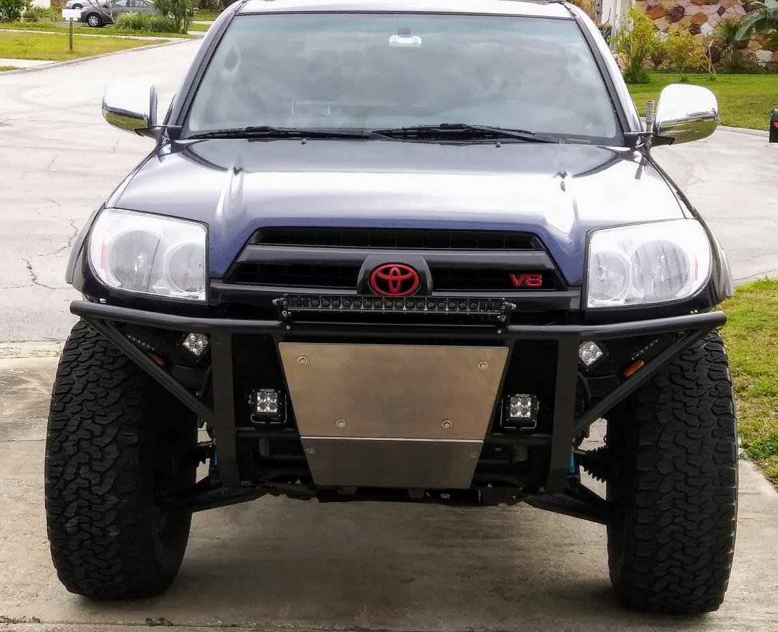

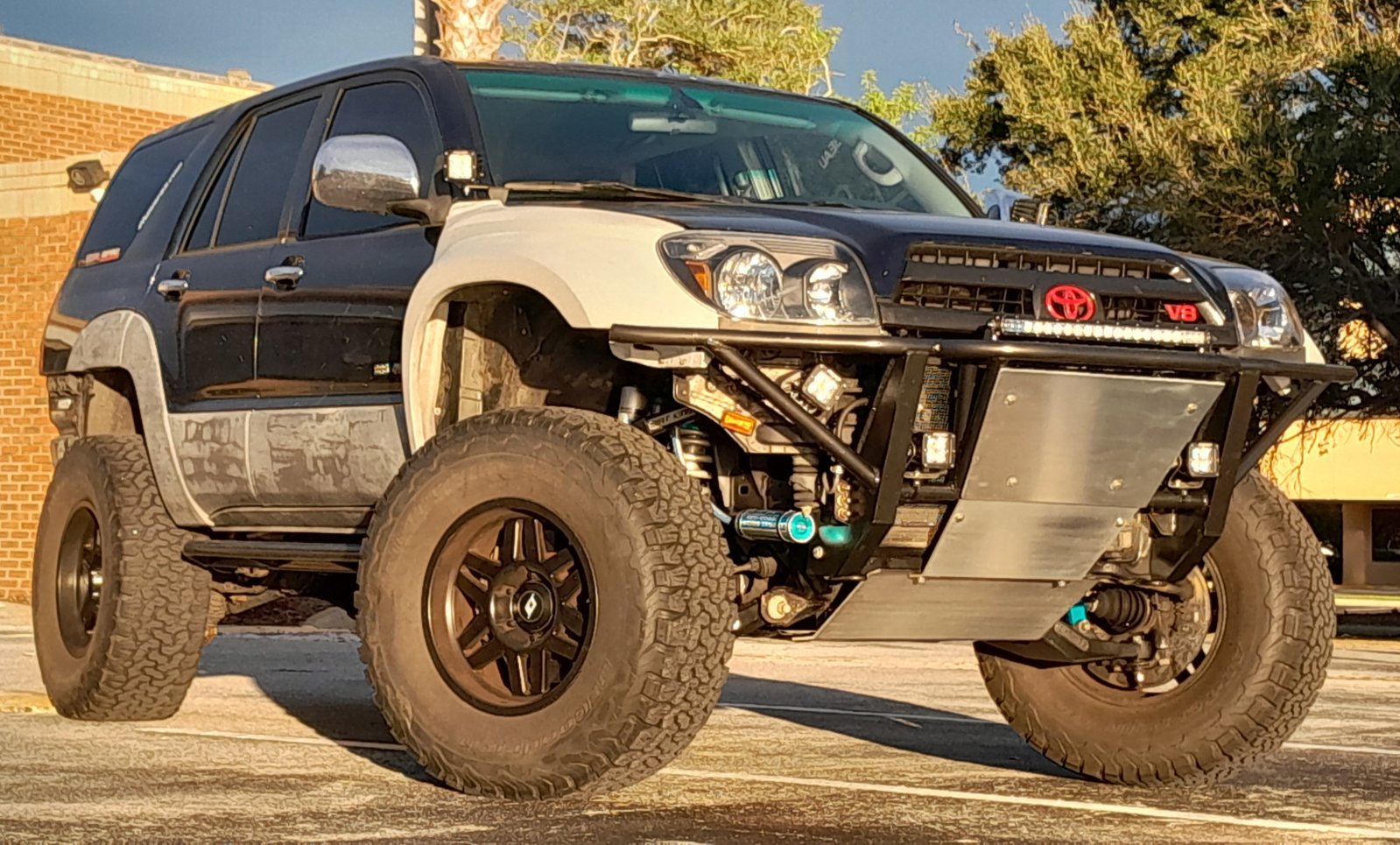

    Finally got the glass installed earlier this year. Added a nerf bar and some aluminum to the bumper. Front factory skid was toast. She's running pretty good too. You Tube Short

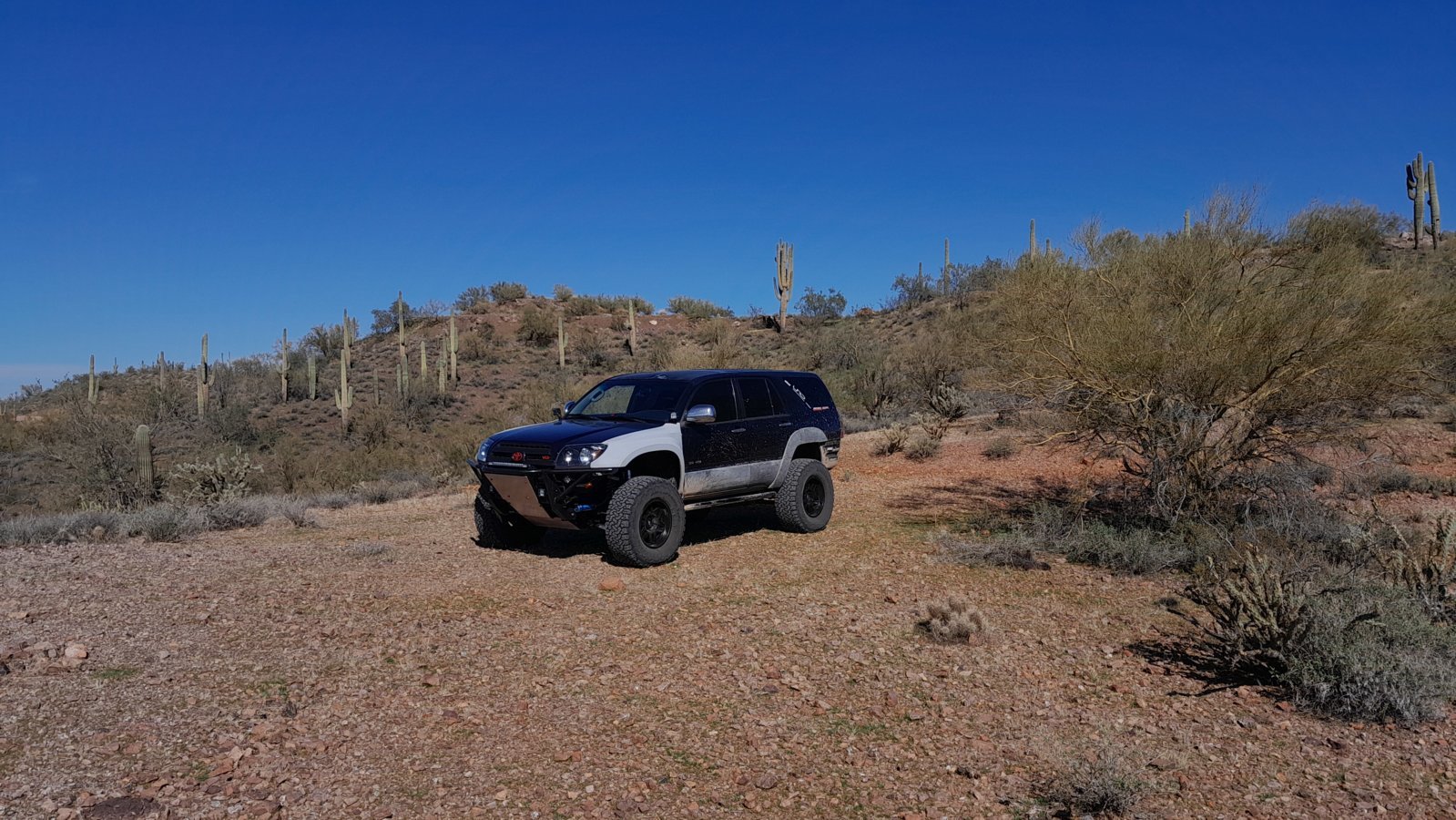

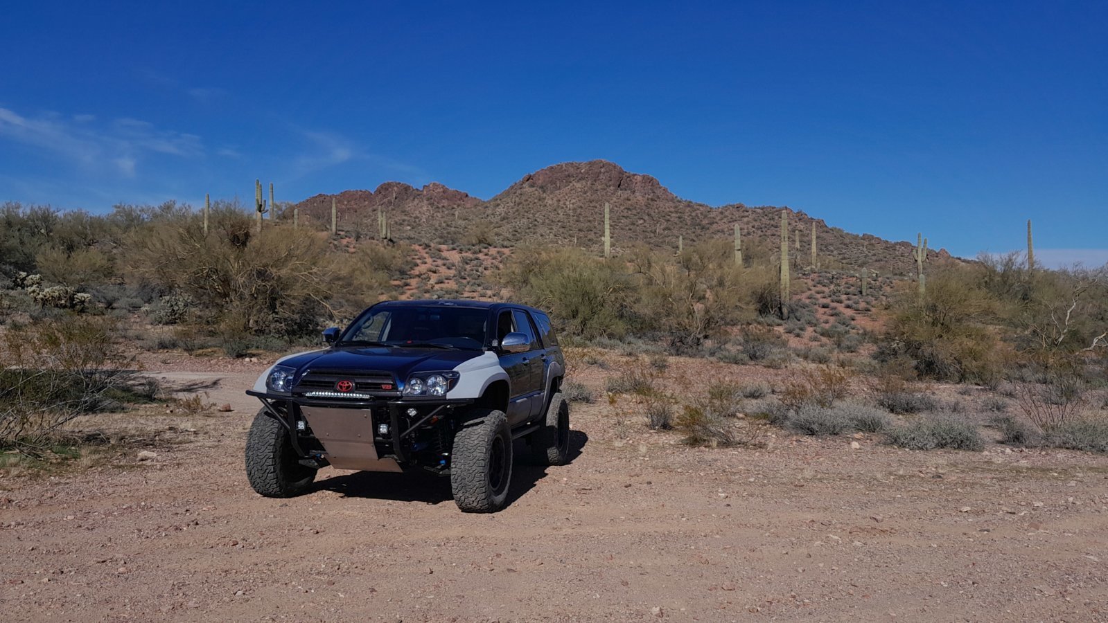

    The swamp dweller is finally getting some Desert Time. First time she's been out west. Vulture Mtns, AZ.20240215_143003.jpg
