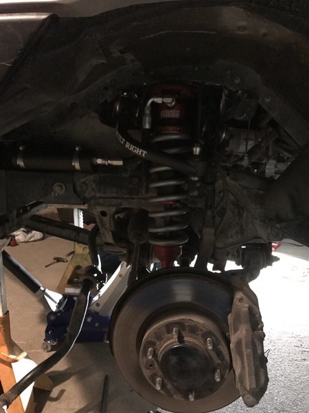

    I'll just leave these here energy suspension bumps going in tomorrow. Also sorry about the dark front coilovers pic. I tried to hammer it out through the night

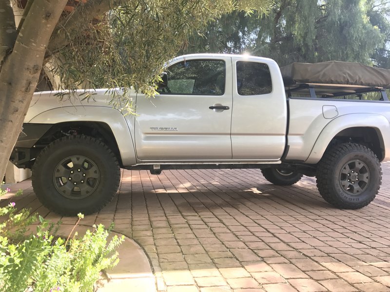

    Here's the initial stance after alignment (with branch in the way lol)
