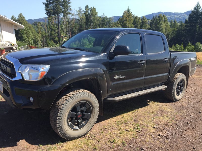

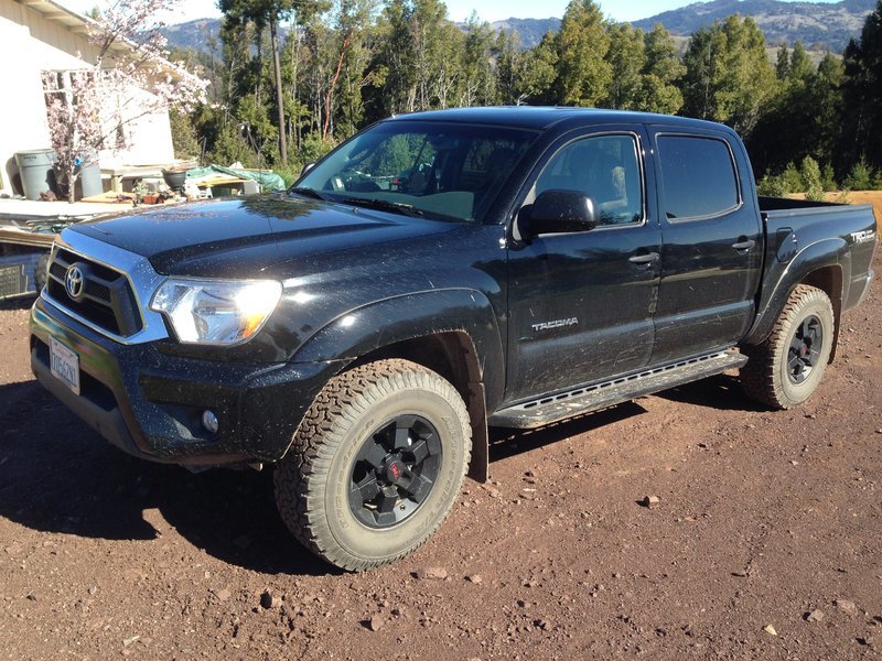

    Here are some old pics of when I got the Toytec 2" BOSS Suspension System installed (BOSS Front Coilovers, Eibach Springs, Light Racing UCA, BOSS Rear Shocks, Toytec AAL):
    Before:
    After:
    BF Goodrich T/A KO 265/75/R16 tires with no rubbing issues.

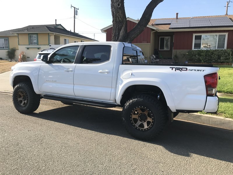

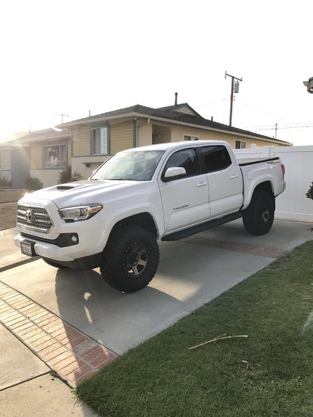

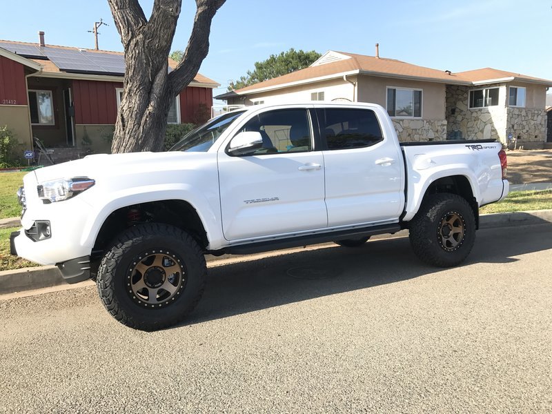

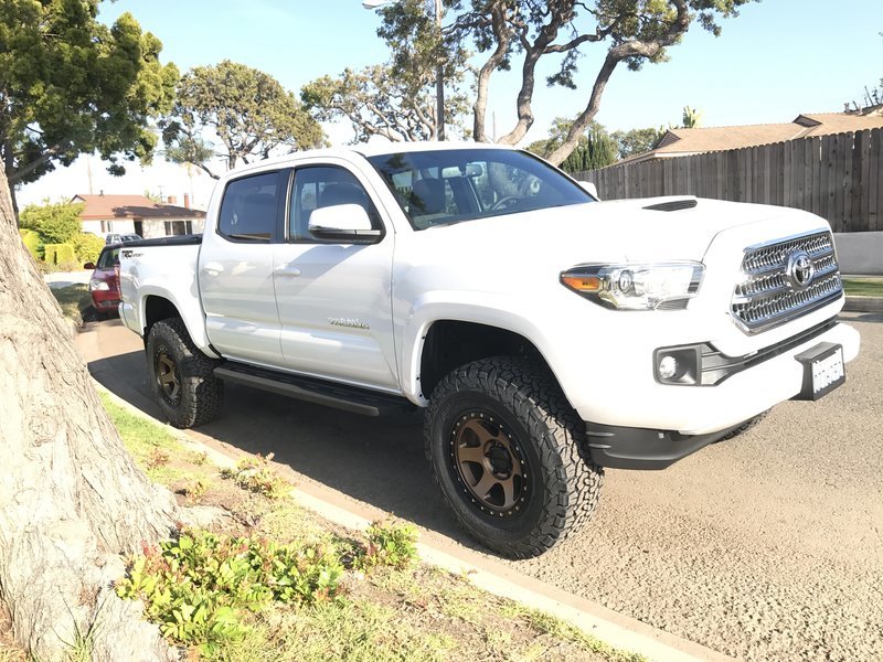

    Finally got some work done and installed most of my toytec goodies. Was quite a wait but I'm supper happy how everything turned out. I installed the boss suspension with #650 springs, spc lr UCA, and AAL. Still contemplating install of the toytec 1" body lift but will install the toytec bump stops probably next weekend I'm off from work. Couple of things that required some work was the removal of the passenger side UCA bolt. I basically murdered the underside of my fender just to have enough clearance for the bolt to be removed. It literally touches the radiator support. The next thing was the removal of the aals. Those are super heavy if you're doing it by yourself! Then aligning the damn leaf springs were a pain lol! Despite that, I'm happy to say, the ride quality feels pretty damn stockish if not softer so for me that's deserves a solid 10!!! I'll wait until everything settles before I mess with the shocks as I didn't adjust them from their factory setting. Oh, and I just had my wheels, tires, and alignment done today after suspension work over the weekend. Here's my 2017 white taco with method wheels wrapped in bfg ko2s 280/70/17 and yes, for now, now rubbing issues.

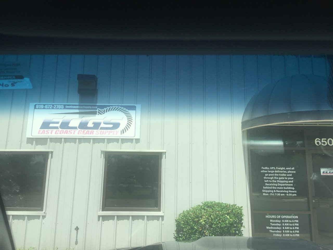

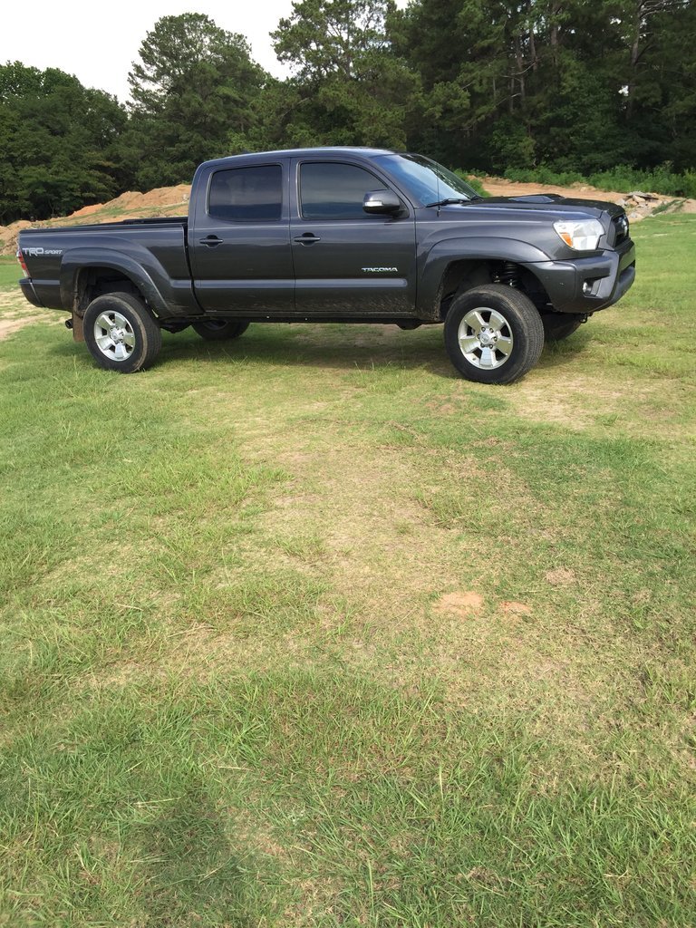

    IMG_1155.jpg IMG_1159.jpg I have a 2015 trd sport dclb 4x4 with boss 2.0 suspension with the progressive add a leaf pack wheelers super bumps up front and a bolt flip with timbren active offroad bumps in the back. Got my needle bearing changed out the other day by our friends at ecgs. Rides like a caddy
