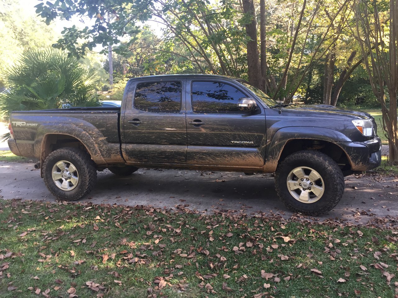

    50836583-3585-442A-B959-226B013C0388.jpgBoss 2.0 lift 285’s

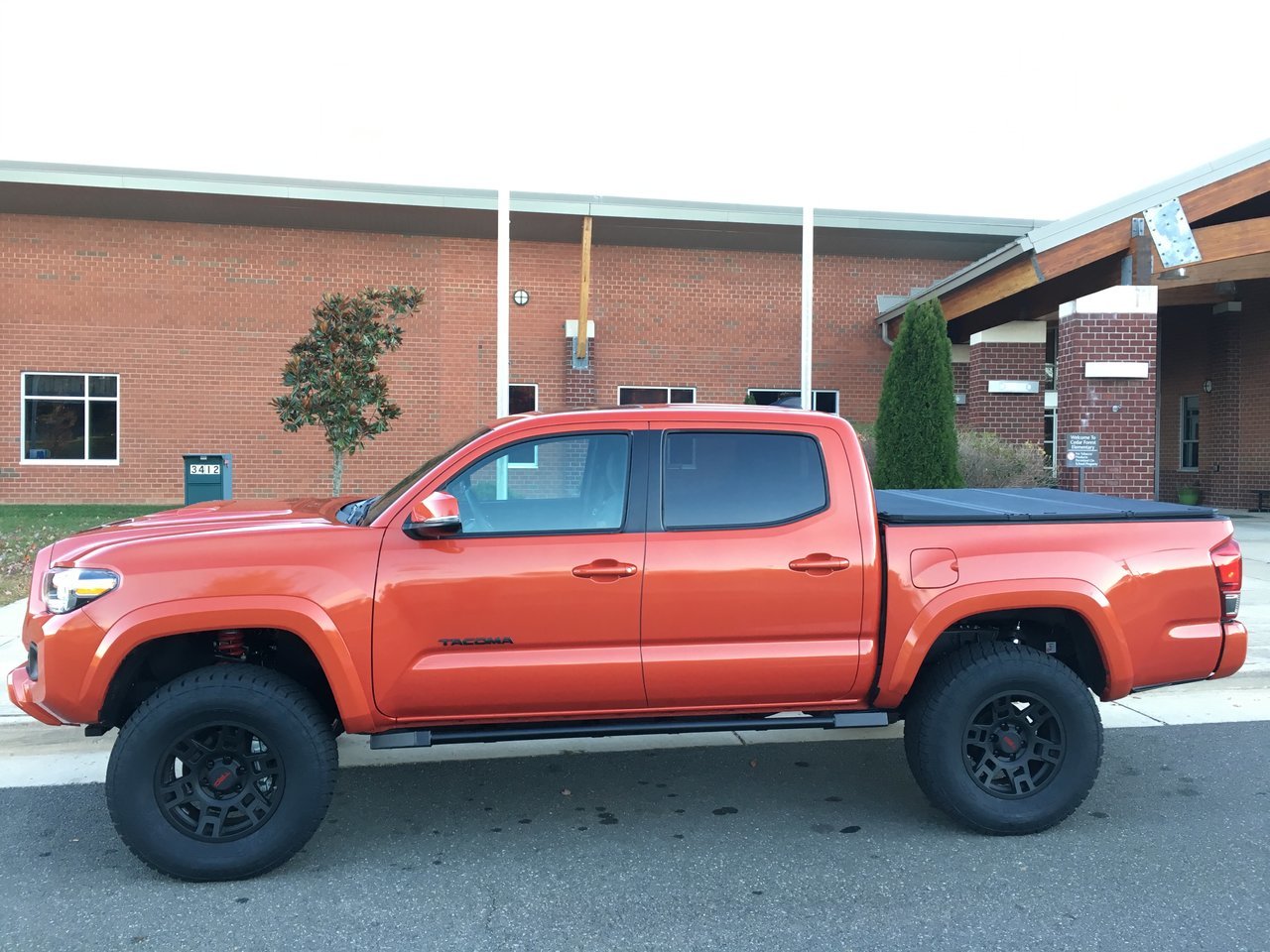

    I get the slip light when turning. I have the BOSS lift, Light racing UCAs, 285 tires, and 4Runner TRD pro black rims.
