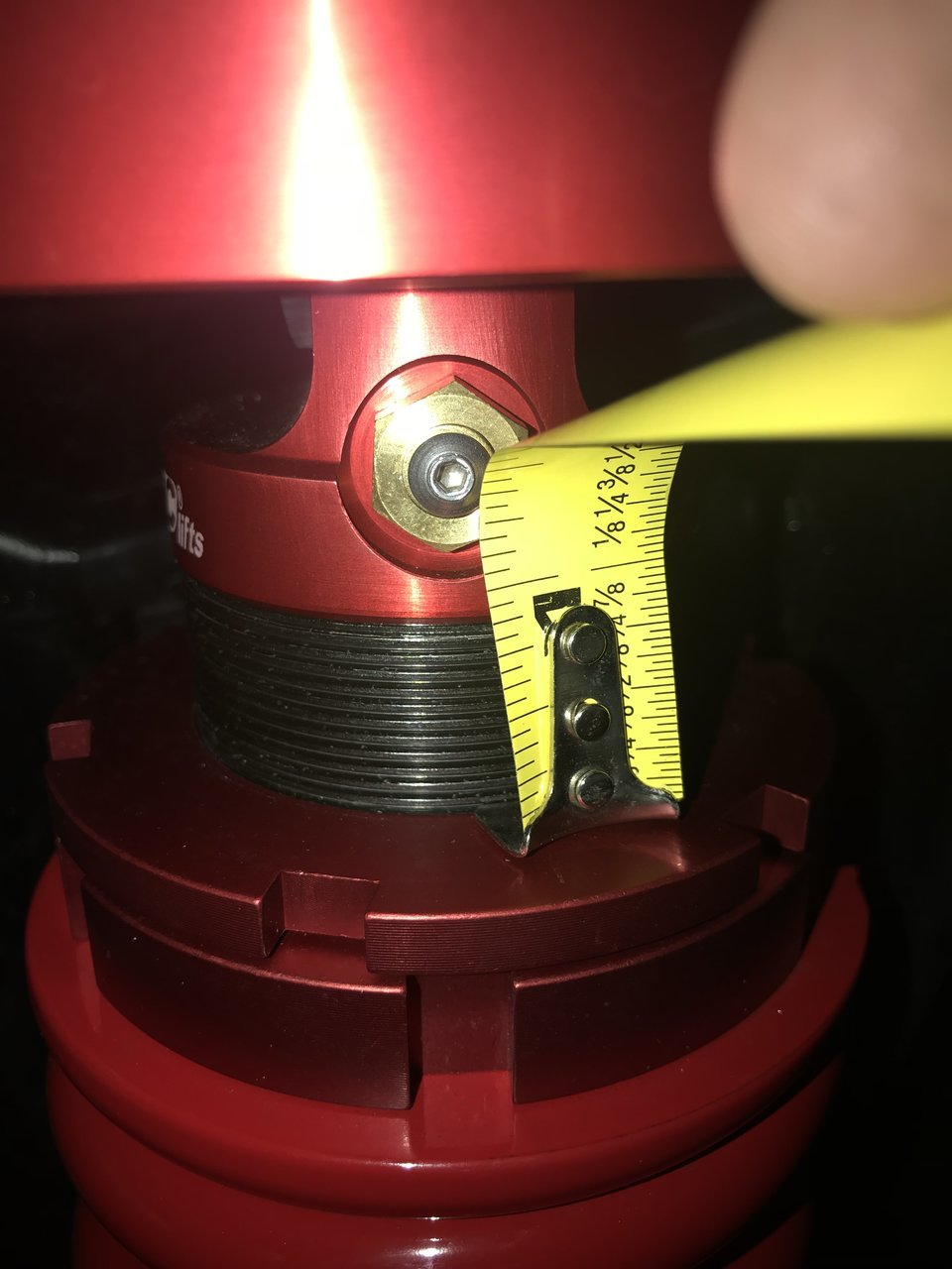

    Does any one know what the pre-sets are on the boss performance 2.5 coilovers? Are they already set at 2” lift? Toytec is closed on weekends and i couldnt find any info on their website

    I believe they are preset for 2 inches but im not 100% positive.

    I was thinking the same thing. Was hoping someone on here knows if not no big deal ill call Toytec this monday when they are open

    Typically they are set to 2.5"s unless your is a 3rd gen taco. Then the lift is 2"s on yours.

    The install instructions state that you shouldn’t pre-load them beyond 1” of threads showing at the top. That would be 2.5” at that setting I believe. Good way to double check if they were shipped that way.

    Just measured it ... im going to assume its set at 2”
