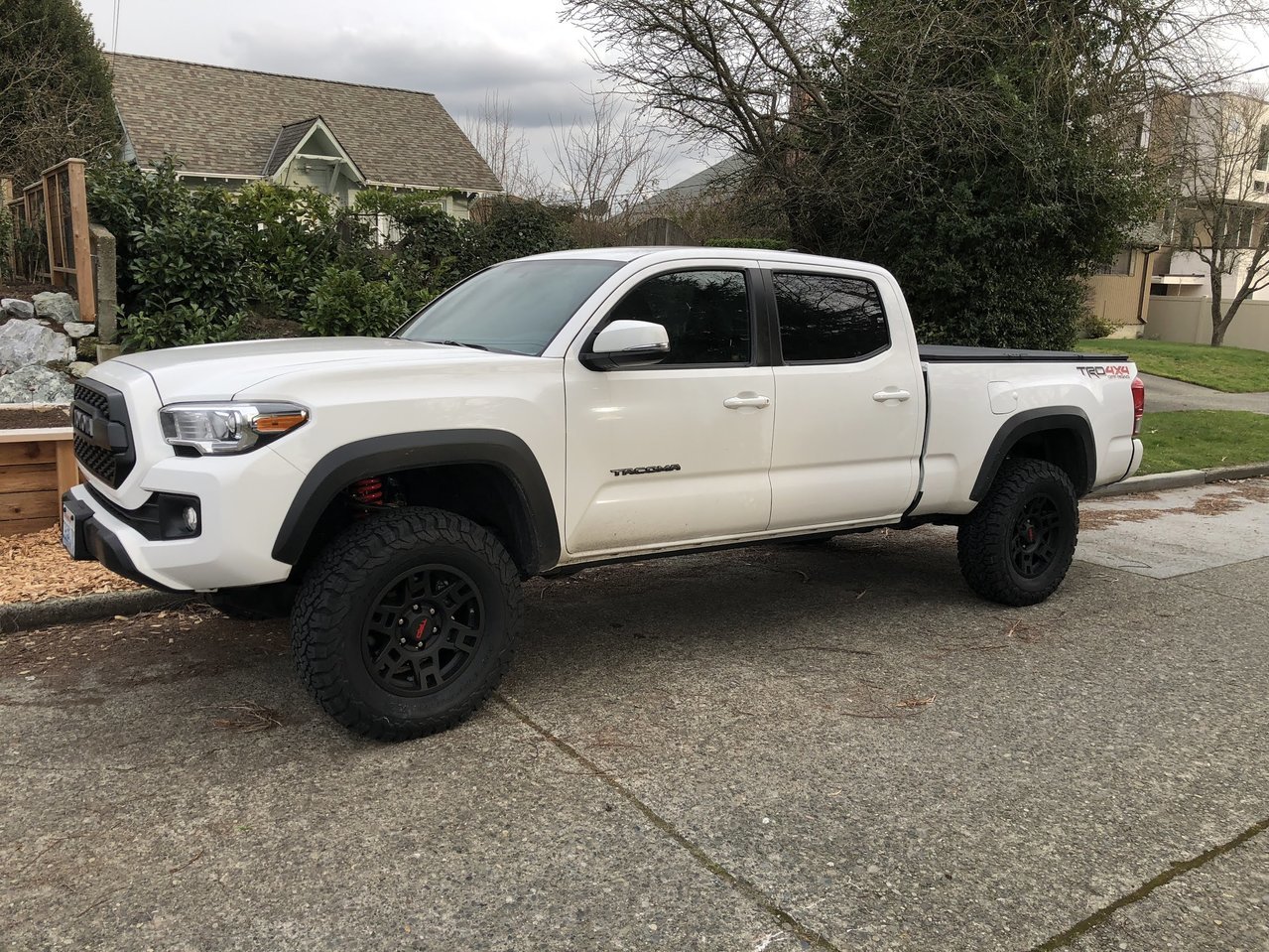

  18. Feb 21, 2018 at 8:31 PM
    #538
    mactin
    mactin New Member
    Feb 21, 2018
    #245191
    4
    Evan
    Seattle
    2017 Tacoma TRD OR DCLB
    Toytec BOSS, AAL, TRD Pro wheels, 275/70R16 BFG KO2
    This was a really useful thread that nudged me to go for the Toytec BOSS with rear AAL for my 2017 TRD OR DCLB. With 2 young'ns, a wife, a job, and a woodworking hobby, there's no way I was doing the install, and it was a little tricky finding someone in Seattle who a) was knowledgeable, and b) didn't insist on installing a leveling kit. Fortunately someone recommended a local-ish dealership (Michael's Toyota of Bellevue) and their accessories team was really knowledgable. They stocked the BOSS (as well as OME) and seem to do a lot of lifts on showroom models. They also stocked the new wheel/tire combo I wanted (TRD Pro wheels, BFG KO2 275/70R17). From my first reaching out to getting the install today was less than a week.
    I prefer the look of short bed trucks better, but LB made more sense for how I use it. The lift finally made me really love the look of the long bed. Super happy. It's also got a bit of rake (hub-to-fender was 23" front, ~24" rear) which I like as I'm frequently hauling lumber or yard waste.
    I didn't replace UCAs. We'll see how that goes. Again, thanks for folks who contributed to this thread and helped me make a decision.
