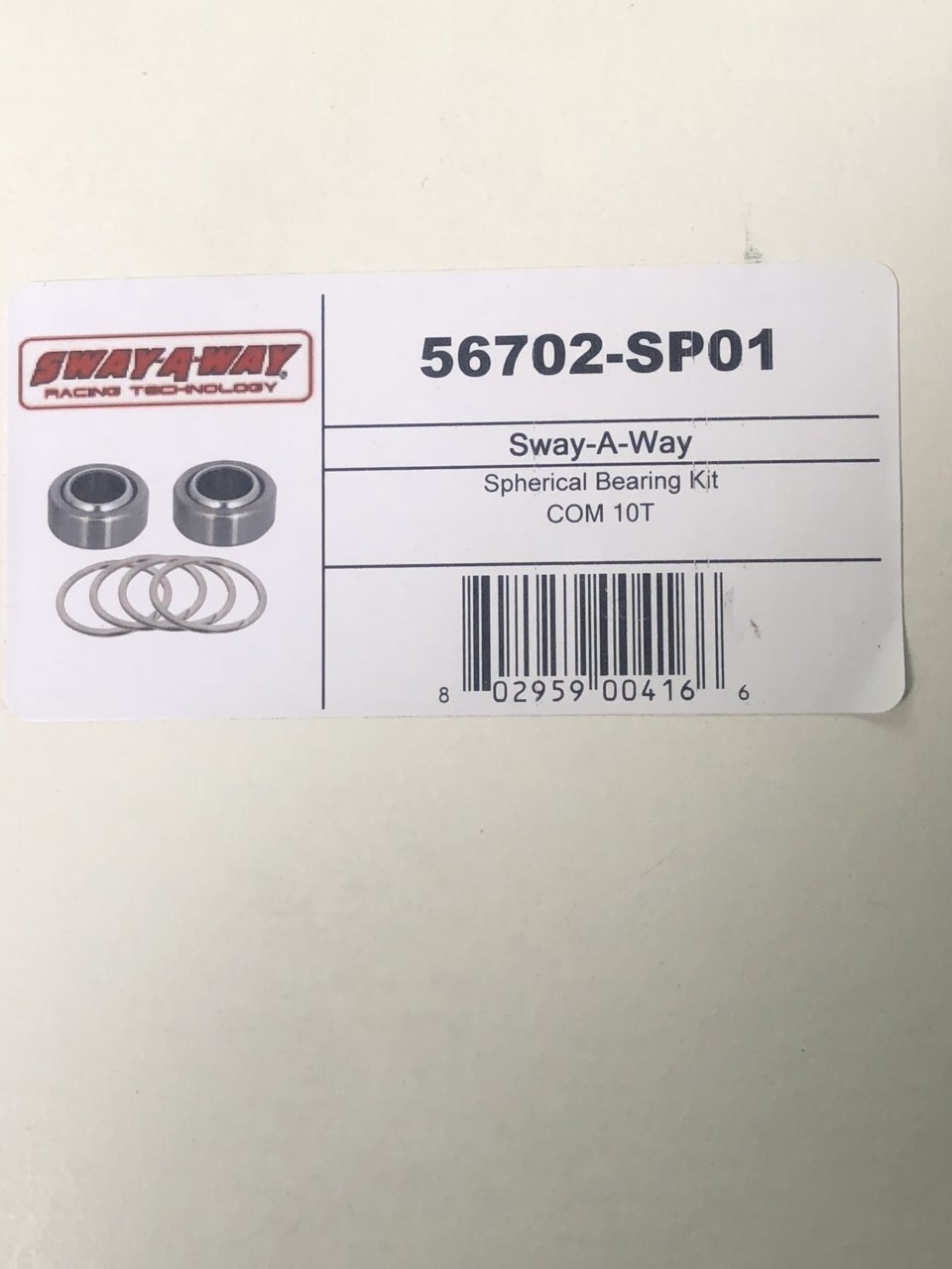

    Over 50k miles on my Boss 2.5 bought in Dec of 2016, carrying FWCamper full time up to the Arctic Circle and down to Arizona. Only issue I had was a terrible squeak that I couldn’t find until recently with the help of good shop in the SF Bay Area, turn out to be lower heim ball mount at the bottom end of drivers side strut. Maybe the desert dust done them in...? Got parts in hand thru Toytec and replacing all four next week!! (after 2 cans of silicone spray later..... at one time thought it was lower a arm bushings due to sound/vibration transfers going all over the place... LoL)

    CA1B1AD5-7D1E-496F-84AA-5A6356453C65.jpg Update:
    Just lower strut heim ball mounts where replaced, the old ones where destroyed!
    I am amazed that water or silicone spray could of even quite them up!
    Here’s the part # FYI
    Oh yes...... I’m squeak free!!!
