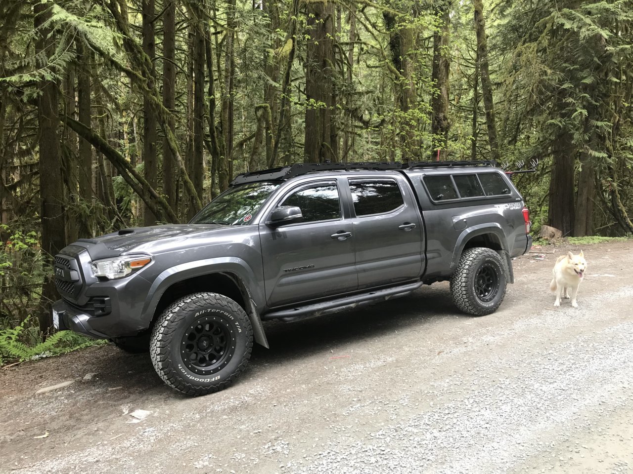

    I guess thats a poorly worded question... what I mean is :
    Is this a common problem? and if so, is there an easy solution like adding a leaf or two/ heavier springs? is there a manufacturer/ item that is best for this application? OME, toytec, icon, etc.
    So far, I really like the toytec setup with UCAs... its tough putting on all this weight!!!! Its starting to cost me money...lol

    Sounds like your going to need 700 lbs front coils and maybe a set of OME heavy rear leafs. I am currently researching this stuff also.

    kidding.. its been good so I kinda want to keep as much as I can but I am thinking by the time we add the weight up it will be as you say

    yea. Sounds like 700 coils for sure , and maybe upsized rear shocks and leafs to handle the weight.

    Since you have the Boss set up you can always adjust the front coilovers to get your height back after adding the front bumper. I run 650 coils on mine and I have a Pelfrybilt steel bumper and steel skids and don't have any issues. In the rear I would looking into upgrading to a full leaf spring pack, I currently have the OME Dakar EL095's and really enjoy them.
