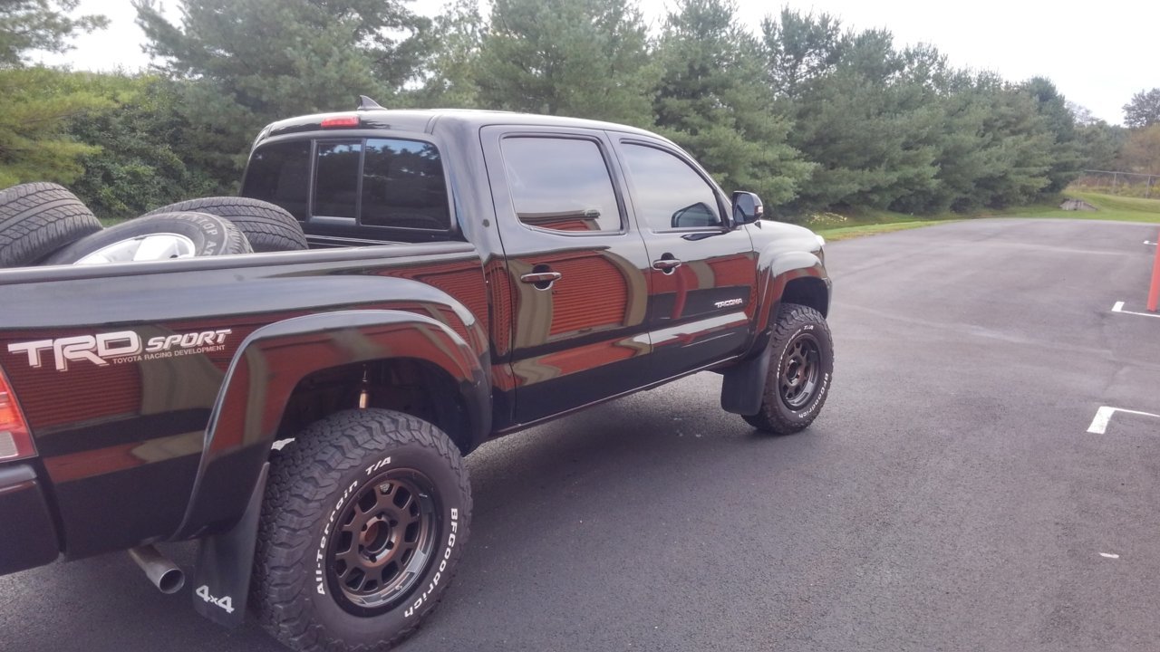

    KIMG0592.jpg Put the BOSS lift on this weekend. Really liking these FN wheels.
    Biscuits likes this.
