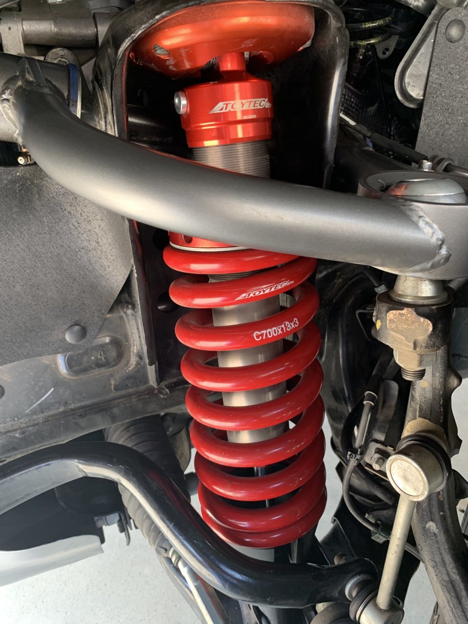

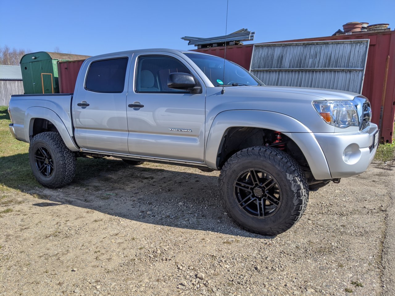

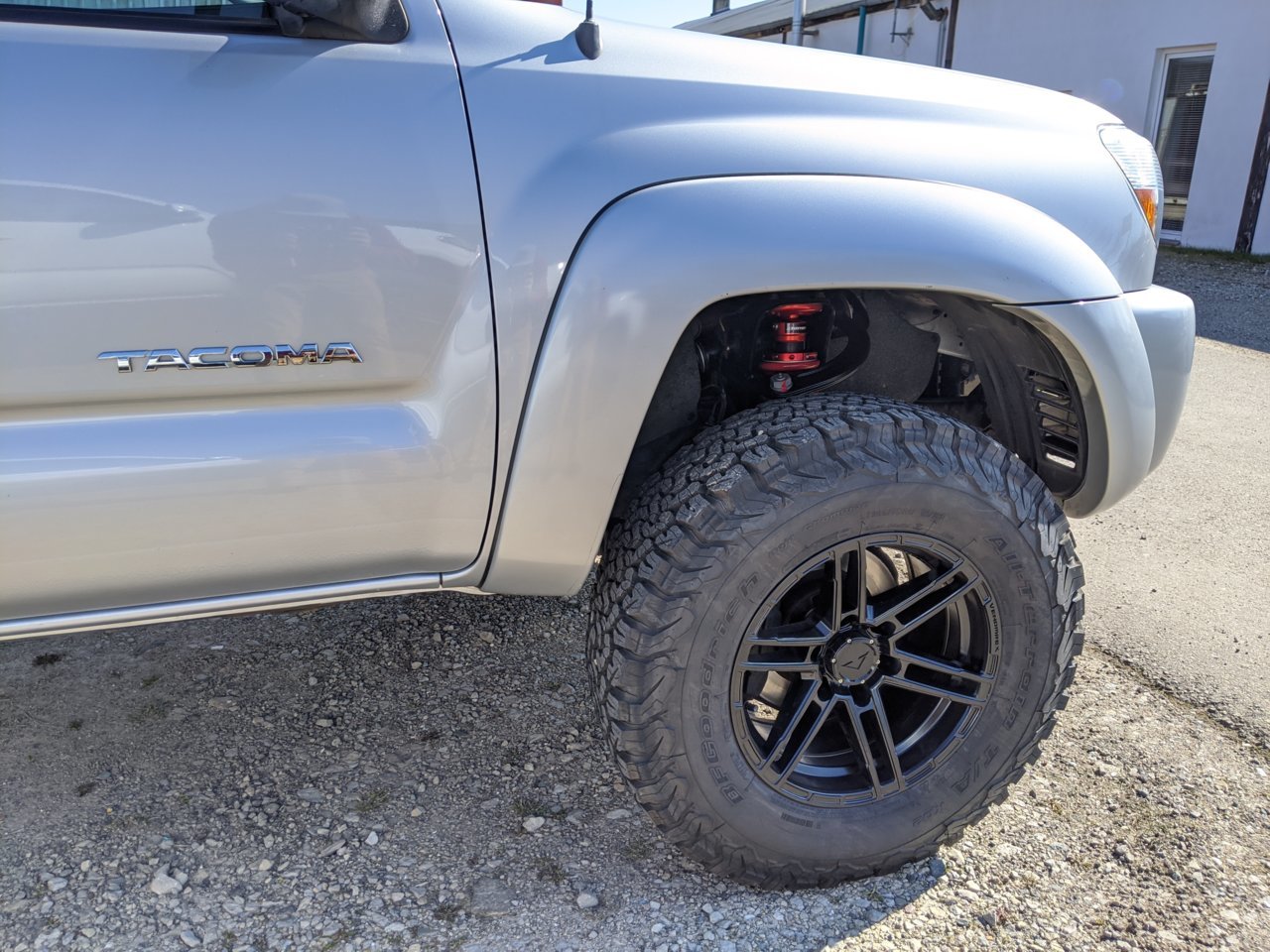

    -Currently Leveled (Bought that way) -265/70r17 Nitto Ridge Grapplers -OEM Sport Wheels with 1.25" wheel Spacers -Many Changes Coming soon! See my old Jeep and now my Tacoma build @4x4erik
    My buddy has them on his second gen. Opted for 700# springs and he is running SPC arms. Truck looks and rides awesome. No rubbing after alignment with positive 2.4 caster. He has not been off-road to check rubbing their. Rubbed like crazy before alignment. Same with my 3 gen. I rubbed like crazy, did the CMC, stopped rubbing and then got an alignment. I don't know if I would not have rubbed with just an alignment for onroad use. We will be doing CMC soon so he doesn't rub off-road. 285/70r17. Let's see if I have a picture.

    Crapp, I accidentally deleted the post...
    Damnnn truck looks solid! Can't wait for mines to come in. Do happen to know if he adjusted the coils prior installing or just installed them out of the box? What set up did he go with the rear? Thank you for posting pics!

    I do because I installed it and helped him adjust it
    -We installed it at the set height toytec ships them at.
    -drove for a couple weeks (we don't drive much)
    -re-adjusted to a full 3" lift height after it had settled. 05-15 Tacomas Measure 20" in the front and 21.5 in the rear.
    16-20 Measure 21" front and 22" rear.
    He drives a 2011.
    - After adjustment to 23 inches in the front (full 3" of lift) we let it settle for a couple more weeks and then he got an alignment.
    -We did the adjustments on the vehicle. Don't remove the set screw all the way (only back it off a little bit), and order a hole punch that fits your coil hole to use as your tool (we broke the tool that comes with it. It's not very stout). Also, you HAVE TO lube the hek out of it by spraying down the threads with something like wd40 or liquid wrench while you adjust. Toytec does not recommend you adjust them on the vehicle.
    That is the exact same kit we installed but he added the toytec rear aluminum bump stops, he did the toytec single aal, and he also didn't get the new toytec 2.0 aluminum ifp, he has the old style normal shock. They didn't have that available when he ordered it.

    Thanks for the suggestions.. I will definitely follow you when installing.
