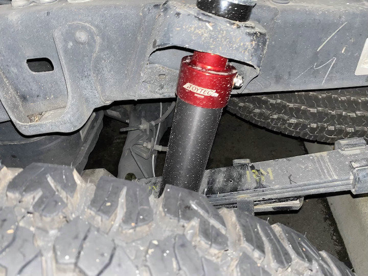

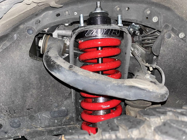

    I believe the front coil overs are discontinued...also, research points to the old shocks being made by Radflo and the new Alumas are Elka.
    On the other hand, I am really impressed with this lift. It so far exceeds what my expectation were and then some for performance.
    I paid 10% off retail and ~$600 install. I had an Aluma kit on order but had to canx due to no inventory at Toytec.
    Should I be concerned that I got a frankenstein kit?
    I don’t want to incriminate the shop just yet so I can’t post the invoice. It just says “Toytec boss” The Aluma series are beautiful—the old one...meh.

    Nah. Those might be the 650 springs & kinda look like the ultimate kit maybe. Those are super nice front coilovers

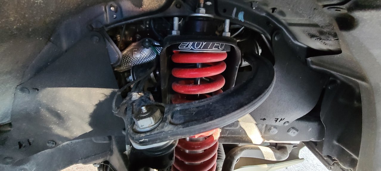

    Here's my 2003 with recently installed Boss kit
    - Toytec Aluma Series coilovers
    - SPC UCAs
    - OME Dakar leafs
    - Toytec 2.0 Aluma Series rear shocks

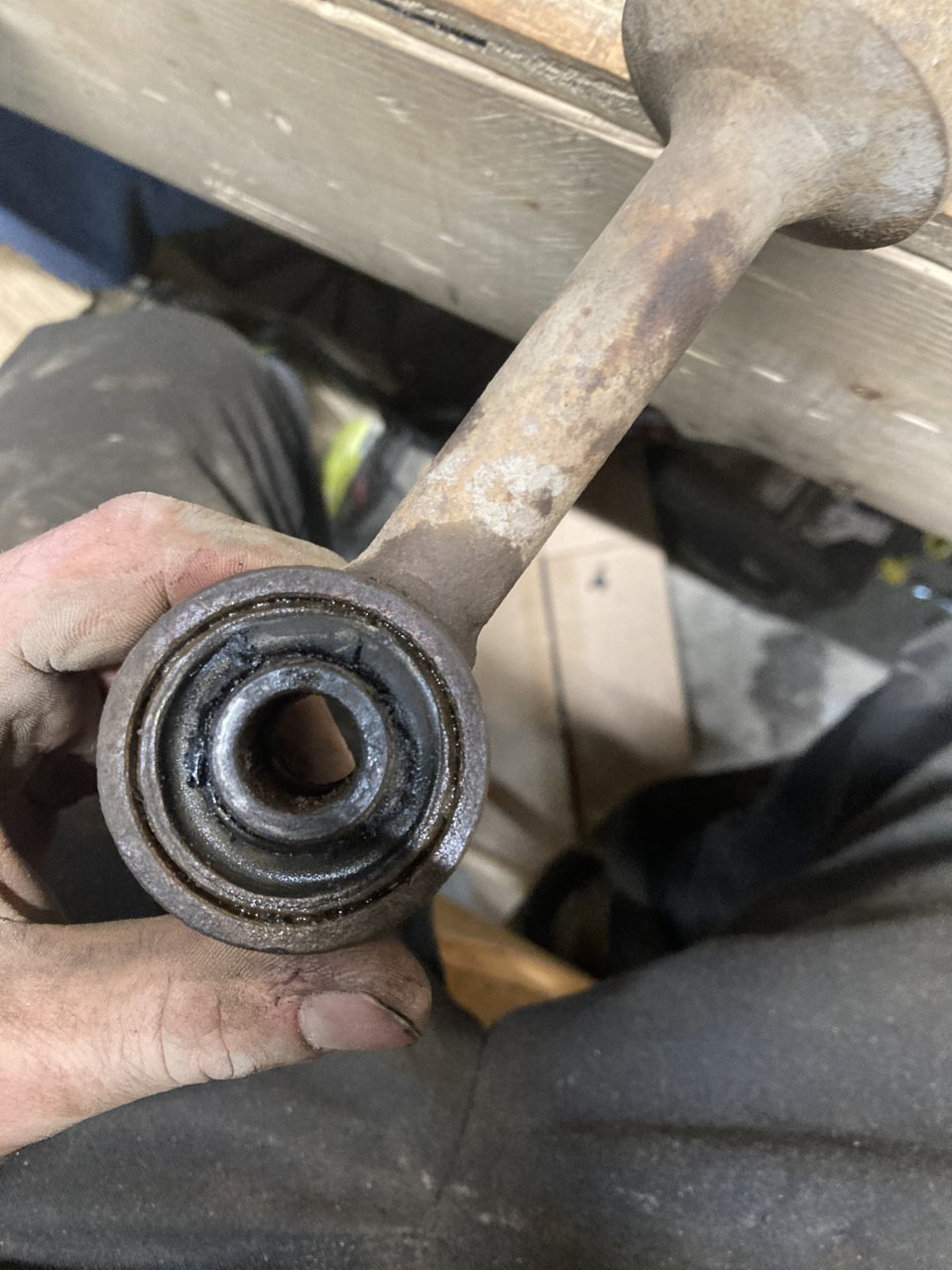

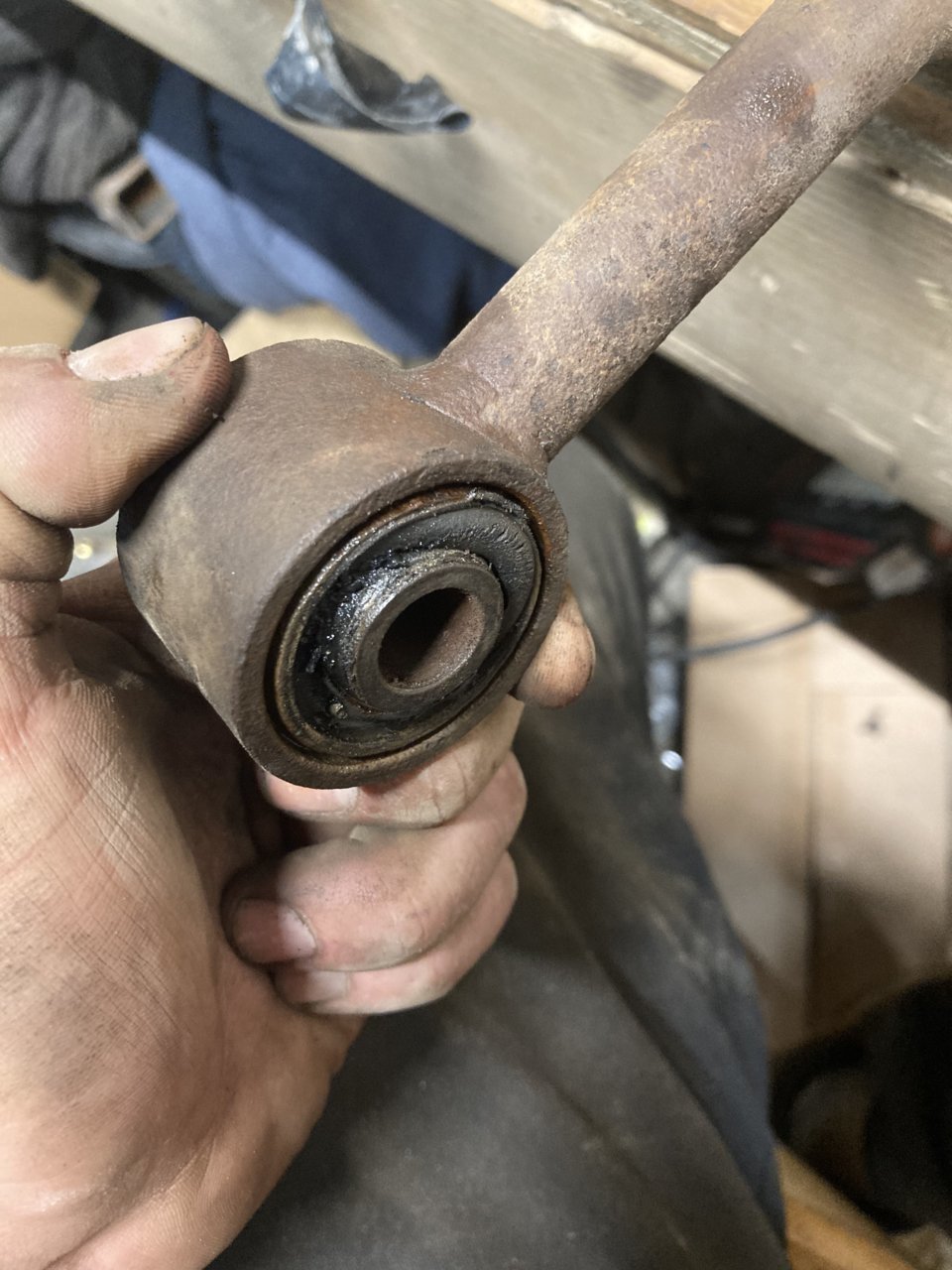

    Has anyone replaced the lower mount bushings on their coils yet. Last time I had the suspension apart mine were about shot. I was wondering if there was a better option then the rubber bushings they come with that someone has used or if @Toytec Lifts offers a replacement to press in.

    Normally when I see those bushings go out like that, it is because during the installation process the lower mount bushing is torqued at full droop, not at static ride height. When that happens the "Neutral" position of the bushing is "set" per say, at full droop, so when you lower the vehicle back down, the bushings are going to bind and twist to try to get back to the "neutral" position of full droop and will eventually rip.
    We do have bushing replacements in stock here ready to go for $10.99 per bushing.

    Appreciate the response! I always torque under static loading with the wheel on so I'm thinking might have just been from me beating on the truck lol. If you could provide the link to the replacement busing I would greatly appreciate it. Thanks again.
