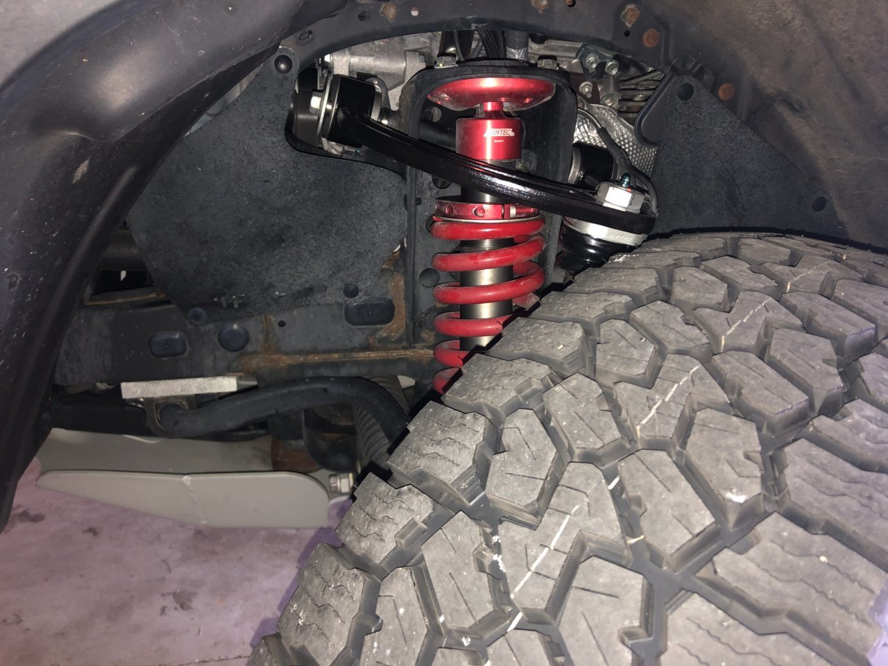

    After 38k on my boss coilovers. Had to replace them today. Went with aluma 2.0’s. Hopefully they’ll last longer! Did see about a half inch drop when installing these. C1371266-B5BC-471F-ACC5-0E5C26F720B1.jpgFE74FCB6-C12D-4D81-9825-77907A267F6F.jpg

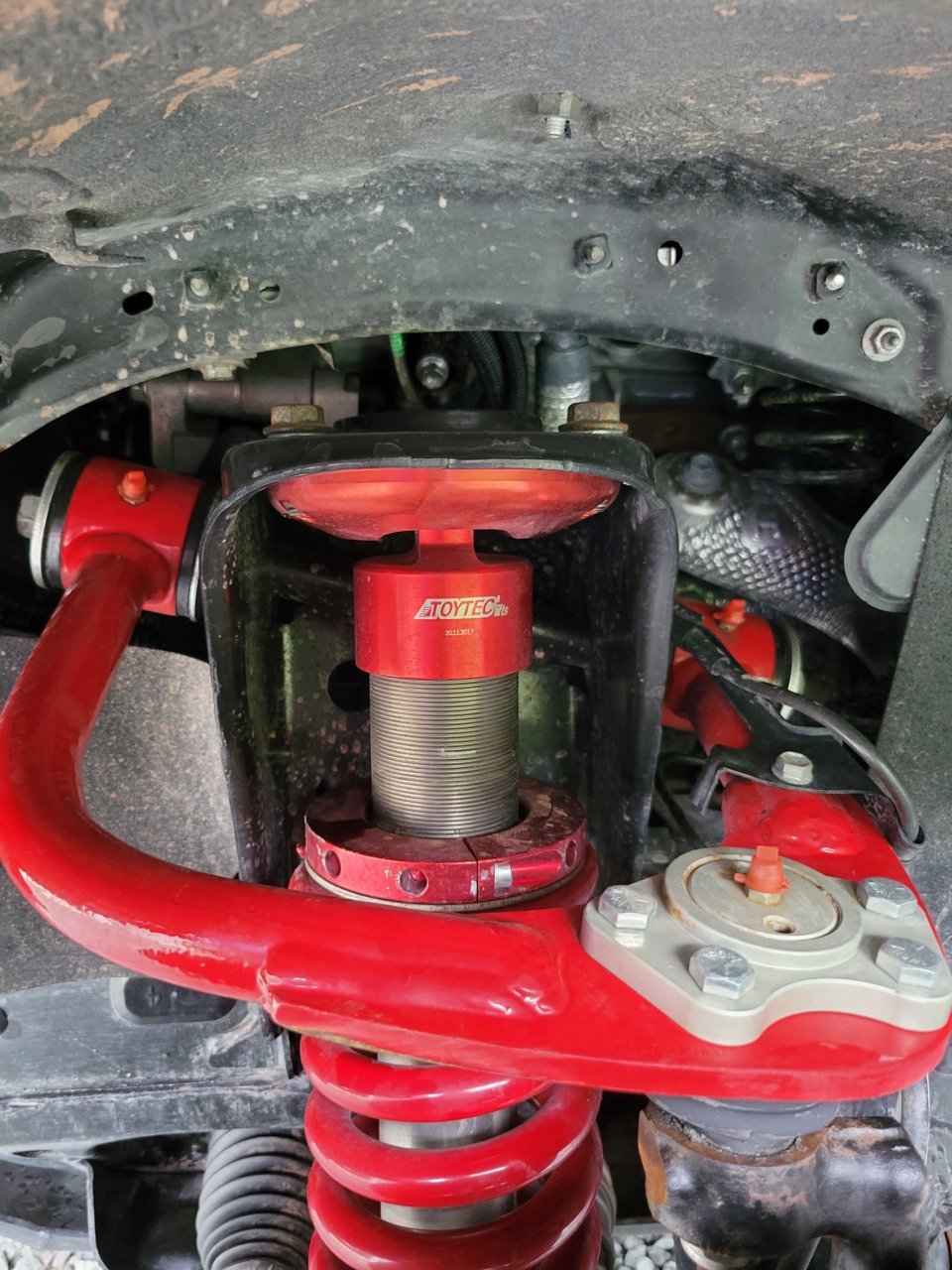

    I have a 2020 Tacoma Off Road with 285/70 tires, an aftermarket bumper and winch. Due to the weight and to level it with my after market HD rear leafs I had to put a ton of preload into my BOSS 2.0 Aluma Series Front Coilovers. I got almost 3 inches of preload as it sits, way more than the max. I am curious what springs people recommend, as I understand I need to change out the springs to make this back within acceptable spec. I attached a photo of it as it sits currently. Thanks for any advice.
    @Toytec Lifts

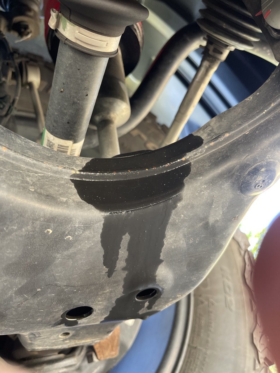

    So several years ago I purchased a Toytec Boss Coilover complete lift for my Tacoma. About a year ago and after 16k miles of use, all the oil leaked out of the Passenger side front shock. Needless to say the truck now ride terrible when the passenger side hits a bump or other road imperfections. So I call Toytec customer service and explain to David that i only need one shock to be replaced and i'm told that the shock I have has been discontinued and is no longer available and has been replaced with the Boss 2.0 for $999.00. After doing some research, I found out that Eibach actually made these shocks for Toytec. So I then call Eibach only to talk to a guy who transfers me to a different department and no one has answered or returned my messages. So do you folks know if Eibach still produces this Threaded shock and if so what is the part number. The Toytec shock part # is TTFSC-2005. As a note, I'm not interested in spending $999.00 on a new Boss front suspension as I don't plan on keeping this truck much longer, but i want it be fixed as I'm gonna sell it to a friend.

    I could be wrong on the older ones, but I think all of the Toytec are made by Elka, not Eibach. Are the ones you have not rebuildable?

    So I called Eibach today and they verified they did indeed make these shocks for Toytec lifts and they have been discontinued. And they are not Rebuildable shocks.

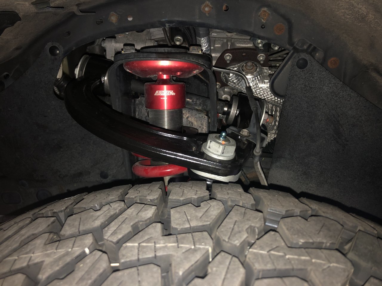

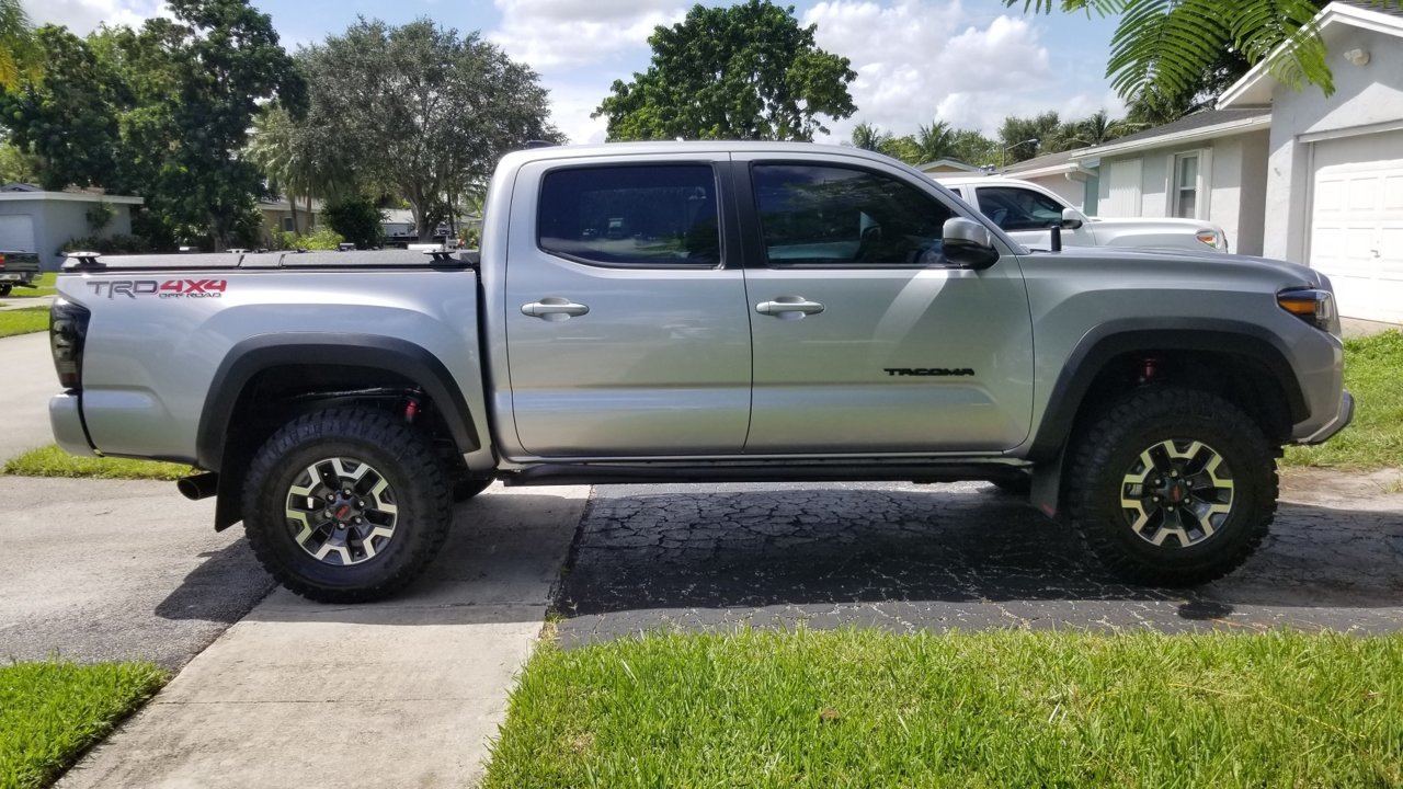

    Had a pro. Traded for an OR and installed Toytec Aluma 2.0 with SPC UCA and 3AAL. If you loved the Pro suspension, you will be very happy with the Boss Aluma. To me the OR with Toytec is a much better ride. The best example I can give is driving on the highway with a crosswind. The Pro would get pushed around a bit in high winds. Even with 2+" of lift on my Aluma kit, no wind nudging at all. To me it is just as planted, but less harsh on pavement compared to the Fox Pro setup.

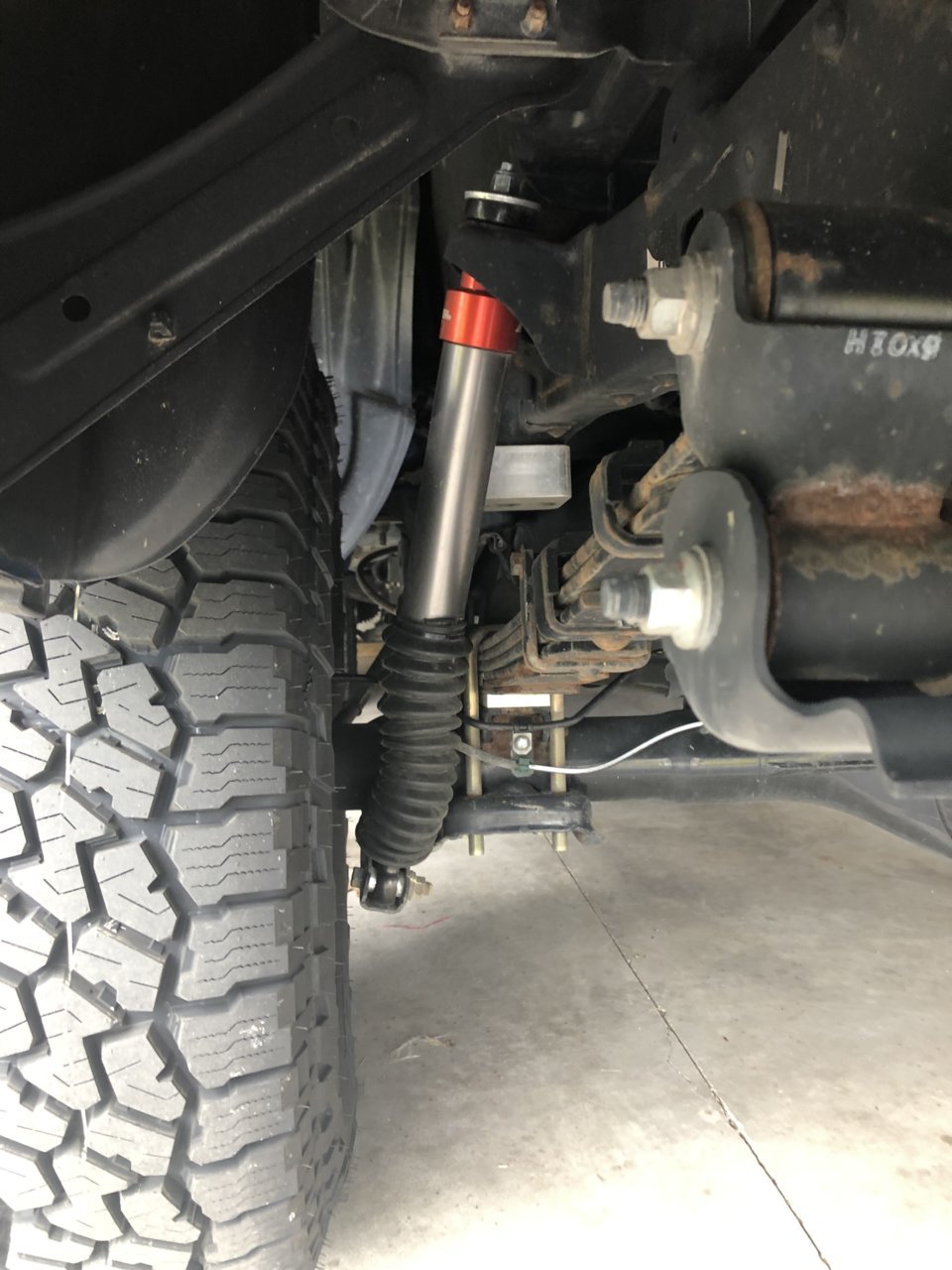

    Does anyone have the Travel or Collapsed/Extended for the 2.0 rear shocks?
