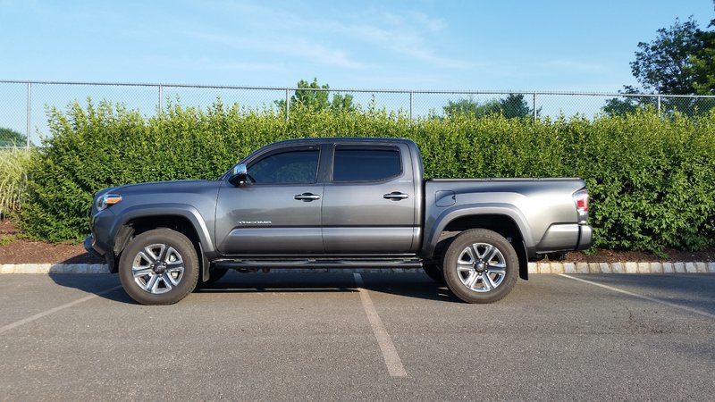

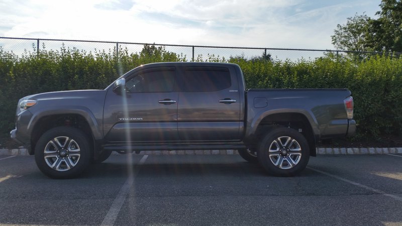

  17. Jun 20, 2016 at 3:44 PM
    #97
    martinh
    martinh Well-Known Member
    Dec 27, 2013
    #119314
    111
    New Jersey
    2018 MBP Limited
    The farkles have started and on order
    I finally got my Toytec Boss 2.0 suspension lift installed and have to say the ride is so much better than toe original suspension. Smoother over the bumps and much more planted feeling.
    AFTER
    BEFORE
  18. Jun 20, 2016 at 4:44 PM
    #98
    SLACKBOY
    SLACKBOY Toyota For Life!
    Nov 26, 2015
    #170763
    1,712
    Erich
    Washington State
    2016 MGM Toyota Tacoma OR 4x4
    Blacked Out Emblems Wet Okole Seat Covers Installed Tinted Front Windows Weathertech Digital Floor Liners for the Front Plasti Dipped OF Grill - Removed BAMF Grill - MGM Installed Icon Stage 2 Kit. TRD Pro Wheels - 17's Ko2s installed (275 70 17) TRD PRO Rigid Led Fogs N Fab 3" Step Bars TRD Pro Auto Shift Knob TRD Pro Tail Lights
    How many inches did you gain
  19. Jun 20, 2016 at 5:03 PM
    #99
    martinh
    Dec 27, 2013
    #119314
    111
    New Jersey
    2018 MBP Limited
    Solid 2" all around. I'll see what it becomes once it settles.
