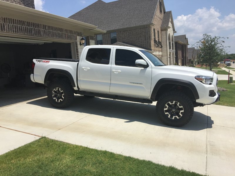

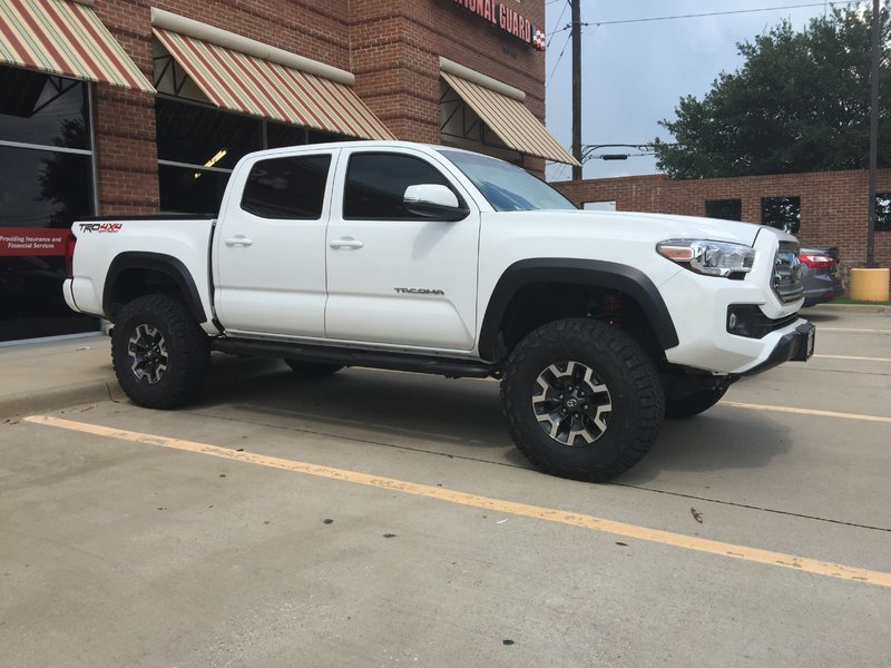

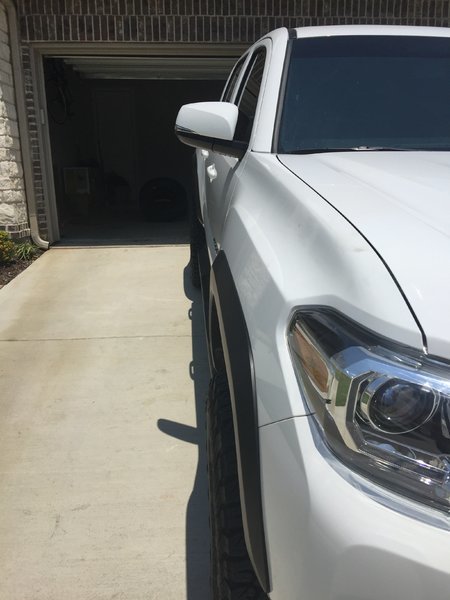

    Thanks man! 285 75 16. Spidertrax 1 1/4 wheel spacers. Puts the tire barely outside the wheel well.

    Thats awesome! thx for the quick reply and pic. any rubbing? trimming needed? I ask because I'm thinking of running the exact same.

    Everyonce in a while, if I'm turning sharp uphill, I get a quick rub. Hardly noticible. I could probably crank up the coilover and have no issues. It's only on the left. Other than that, I have no issues. I don't wheel the truck. I hunt and fish, so the off road trails to my spots are the only time I'm off road. I would recommend a 275, because those have proven not to rub. That's what I was going to go with, but they were actually more expensive than the 285. If I wheeled the truck, I would probably have the cab chop done. It's really case-by-case with these trucks. Some don't rub at all and some do. Mine only started after a few weeks of settling. I really like the kit for the price. Huge improvement from stock IMO. I have upper control arms too.

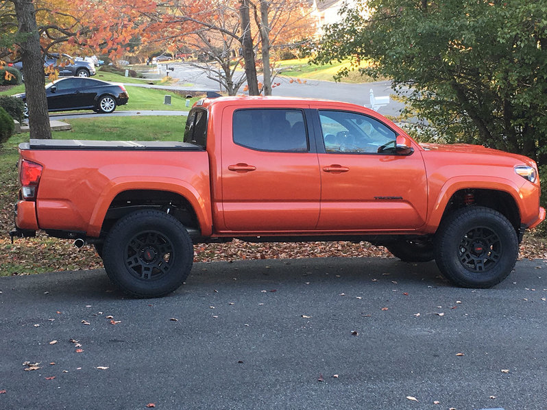

    Just picked it up. Love it!
    Boss 2.0 kit
    The ride is much better than stock! Not firmer, but smoother if that makes sense. Definitely better though in my opinion.
    Truck was half a quart low trans fluid.
    Tsb on the trans was done and there is a noticeable/better feeling now.
    I paid $1789 for the kit and install at Koch Toyota.
    I have 265/70/17 BFG AT KO2's and TRD Pro wheels.
    The front measurement from middle of the hub is 23 1/4" and the rear is 23 3/4".
    If I had to change anything it would be going up to 275's. For now though I think it still looks good but 275's might be in order down the road when I run the tread off these.
    I lost 1 mpg compared to what I normally get coming back from there. I'm won't lose sleep over it.

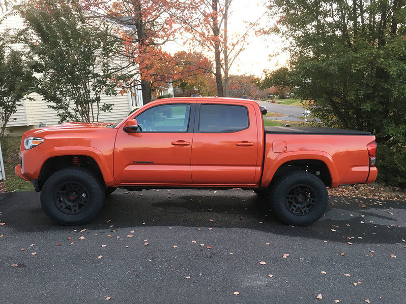

    This looks great! Did you do uca? Any rubbing? Any regrets so far? And are the those tires c rated?
  15. Nov 20, 2016 at 7:06 PM
    #175
    peppinoss
    peppinoss [OP] Well-Known Member
    Sep 3, 2015
    #163380
    575
    Los Angeles
    2016 TRD OR 4x4
    ToyTec Boss 2.0 lift TRD Pro Wheels 265/70/R17 KO2s Mobtown Offroad Sliders
    I got TC UCAs, no rubbing, no regrets. Correct, those are 265/70/17 KO2s load C

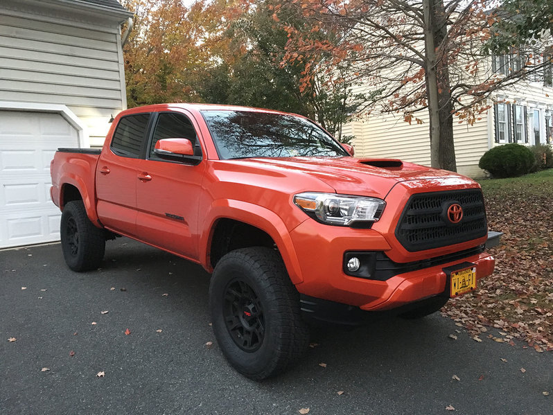

    Boss kit with Light racing UCAs. Nitto Grapplers G2s, 285 70/17
    Rides better and I took the air dam off but I think it still rubs when turning on a grade. I saw the vsc flash a couple times when turning.
    I do have a slight vibration when taking off and a rhythmic vibration when cruising down the highway if that makes sense.
    Just got it done last week. Got to get the vibration figured out. It is very slight but bothers me non the less. I love the look and feel. It feels more like a truck now.
    Pics
