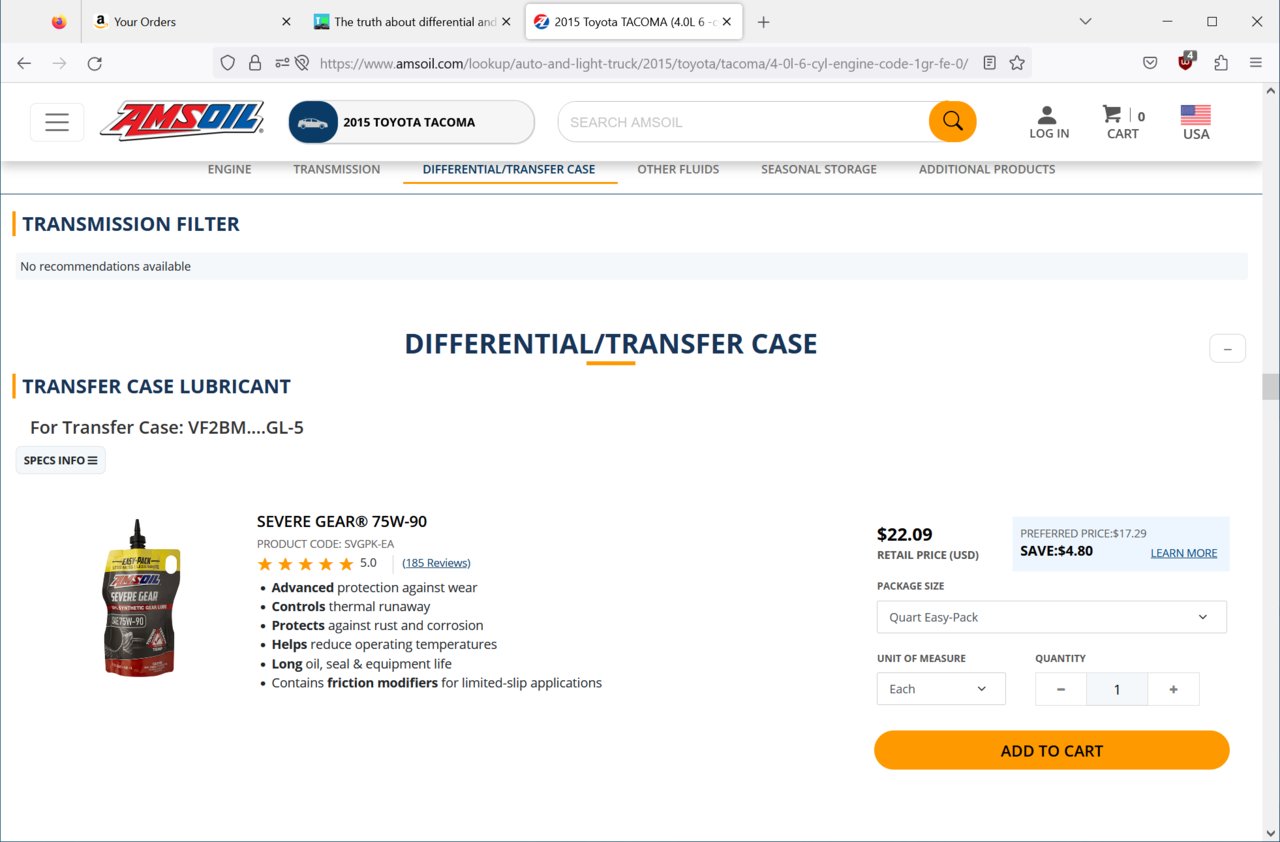

    That's a much lighter weight than the diff fluid specs, any particular reason you go with this particular fluid? I'm using Amsoil in the rear, and after 2 changes with a cheap fluid in the front, i'm ready to go with the Amsoil up front as well. All this after a regear and backcountry 3k mile trip. Might as well swap out the transfer case while I'm at it and doing a bit of reading first.

    TC does not see the loads a differential sees - different gear loading, materials, interface, heat, etc - no need at all for heavy gear oil.
    Oddly the Amsoil MTF is more viscous than the factory fluid. Factory is a really ultra thin oil.

    Right, I knew it was a 75w LF and not the 75-90, but just curious since Toyotas fluid is so damn expensive. I can't see paying what they charge, but like Amsoil, and you reco'd the MT which I'm inclined to use. Just wanting to do it right without buying Toyota's fluid
