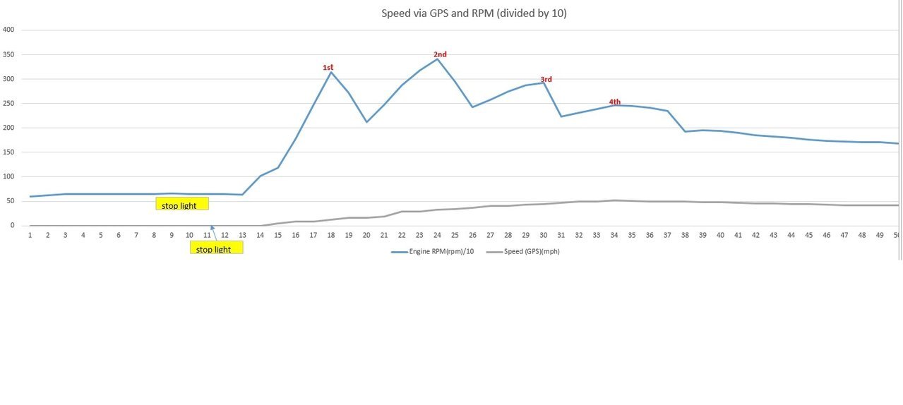

    I definitely remember having rev hang when I bought my 2017, and I really delayed my shift from 1st to 2nd. My muscles already got used to the delay. Today, I decided not to delay my shift just to see what would happen. To my surprise the rev hang was completely gone.
    Here is graph of one of my most recent trips (recorded with the Torque app). The X-axis represents each second of my trip. The Y-Axis represents both the RPM(/10) and my Speed. I divided the RPM by 10 for presentation purposes. I wanted show my speed and RPM in a concise way without messing around with so many graph settings in Excel.
    The RPM record clearly shows that there is no rev hang. For example, after the second stop light (see below), I shifted quickly, with the same speed from 1st to 4th, and there was no hang at all.
    Please pardon the misspelled "3nd" labels...

    Can you please change your graph to a much larger scale to show on the horizontal axis just the short duration between top revs 1-2, around 120-125 second mark. Thanks

    Here you go! Doesn't appear to be any rev hang at all. There is a bit more than 1 second in between my shift from 1st to 2nd. It's not a super fast shift, but it's not a relaxed shifting speed either. 6_28 zoomed..jpg

    What is the mileage on your truck currently? Or when did you notice that the rev hang disappeared?
    Did you ever run the torque app when you had rev hang to see if it captured it on the graph?

    I have had the torque app for one week. I bought the 2017 Tacoma in the beginning of May. It had 150 miles at that point. It currently has 2900 miles.

    Your graph shows it takes 3 seconds to drop 1000 rpm (3500-2500). Seems like that's too much
