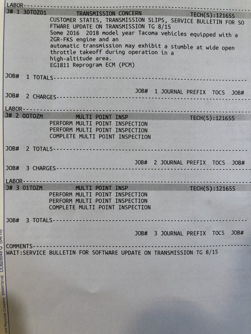

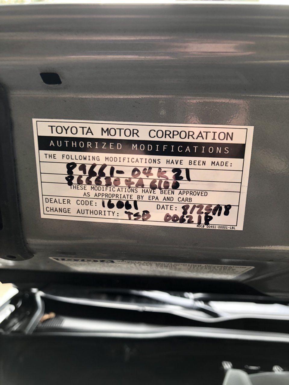

    Just picked my 18 OR up from the dealer. 2nd dealer I delt with, first dealer claimed they had no idea what a TSB even was and there were no recalls so nothing they could do, even though I printed the TSB off and showed it to them.
    She said I was the 2nd Tacoma today with the TSB printed off and they've done a few in the last month. She drove a 17 TRD Pro so he was well aware of the issues. She also said if a dealer claims to not know what a TSB is to go somewhere else immediately.
    45 minutes and I pulled out of the parking lot. No muss no fuss.
    I drove about 50 miles, mixed with back roads, highway, and town driving. It feels like a new truck, or at least closer to what an automatic transmission should feel like. Wasn't hunting for gears constantly on the back roads and interstate, and city driving felt responsive and much less clunky.
    The biggest thing I noticed was while driving through town letting off the gas and the pressing it again a few seconds later was smooth. Previously it would jerk super hard. Not sure if it was the torque converter or what but sometimes it would feel like I was about to rip the rear end out.
    The dealership also placed the sticker under the hood.
    All in all its worth it, and to parrot everyone else, the way our trucks should have came from the factory.
    If you're in central KY then call Georgie at Frankfort Toyota. Very pleasant experience.29F5762D-7B1E-4A18-BBAA-467CC4061D39.jpgE876D06F-E0DE-4D6E-9372-F2FB554B9446.jpg
