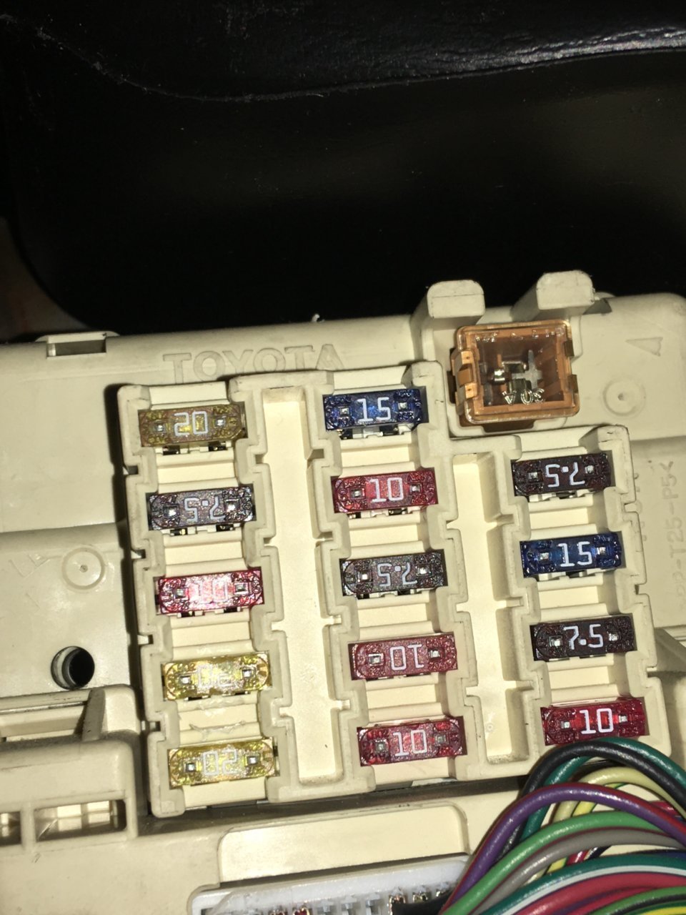

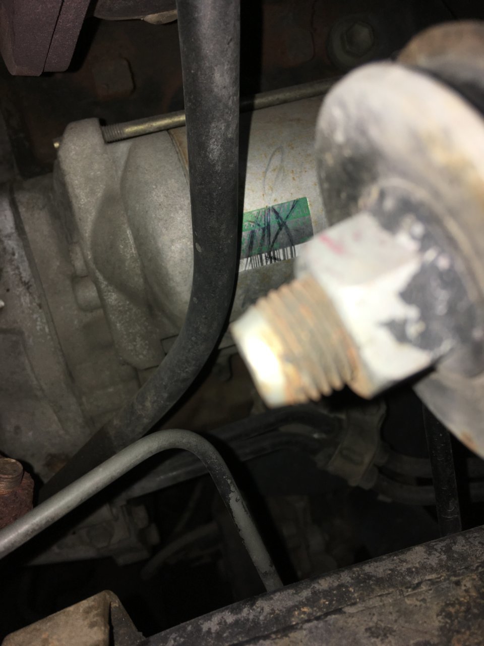

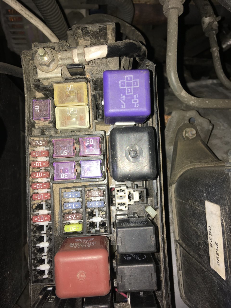

    I just checked out the interior fuse block which seemed pretty dry. I haven't pulled each fuse for inspection just yet tho.

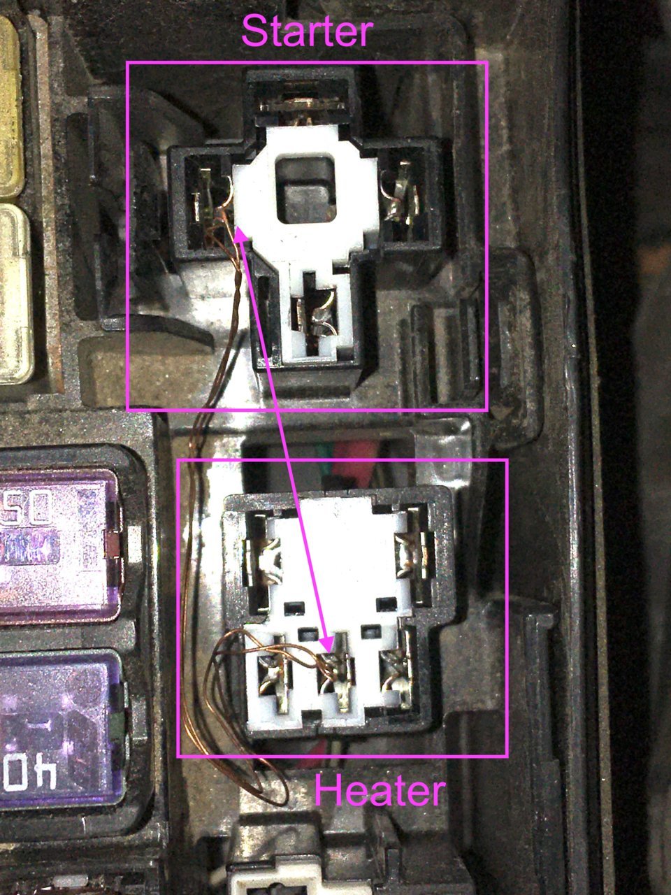

    As for the junction block - would that be the larger fuse relay block under the hood that covers the larger starter and heater fuses (in pics)? If it is, I did take a look at that as well. Although it seemed dry it's certainly in an area (driver-side above wheel well) with exposure. The cover of that block is a loose fit too boot.

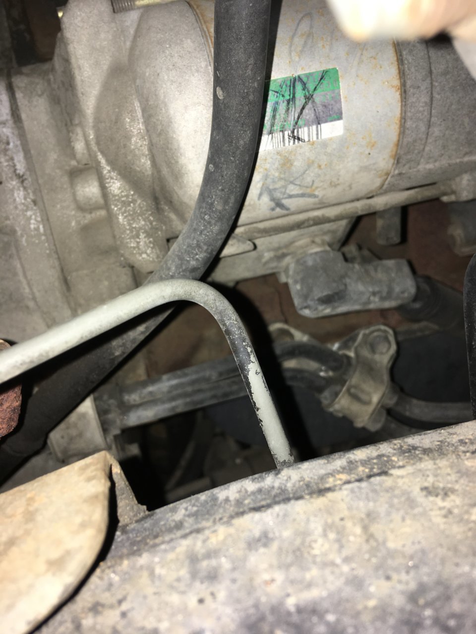

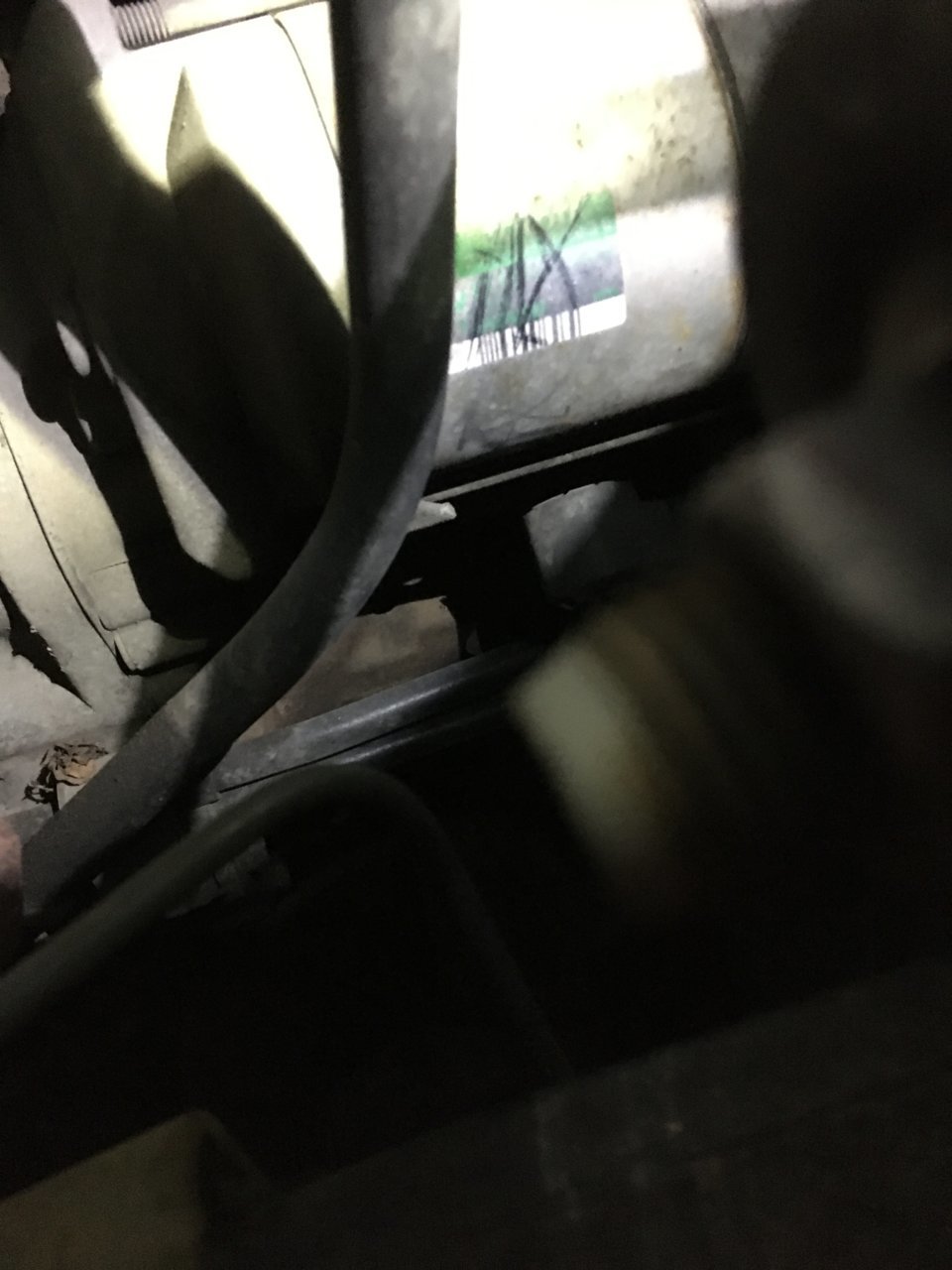

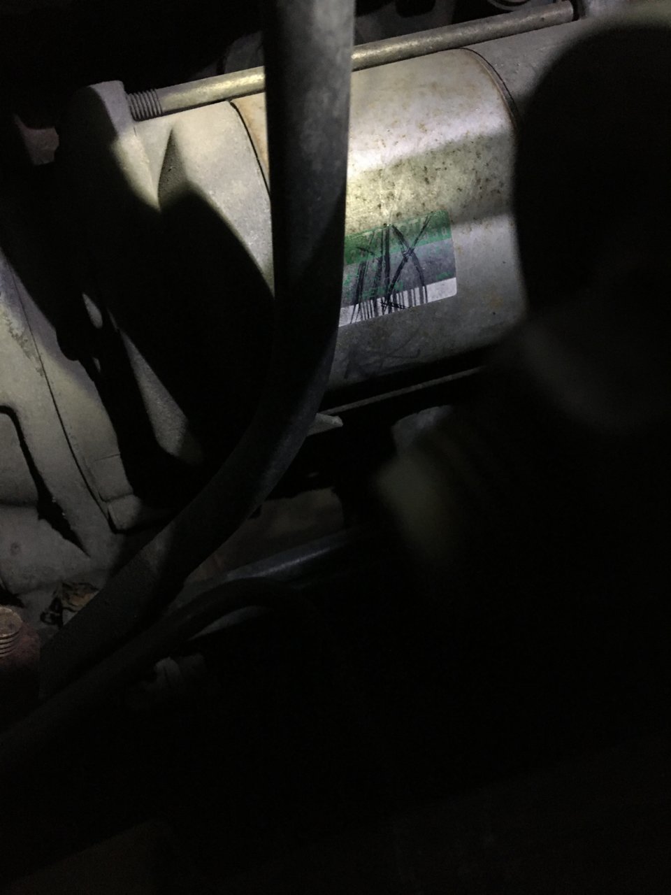

    Also did what I could to check out the starter/solenoid area which appears fine. (see pics)

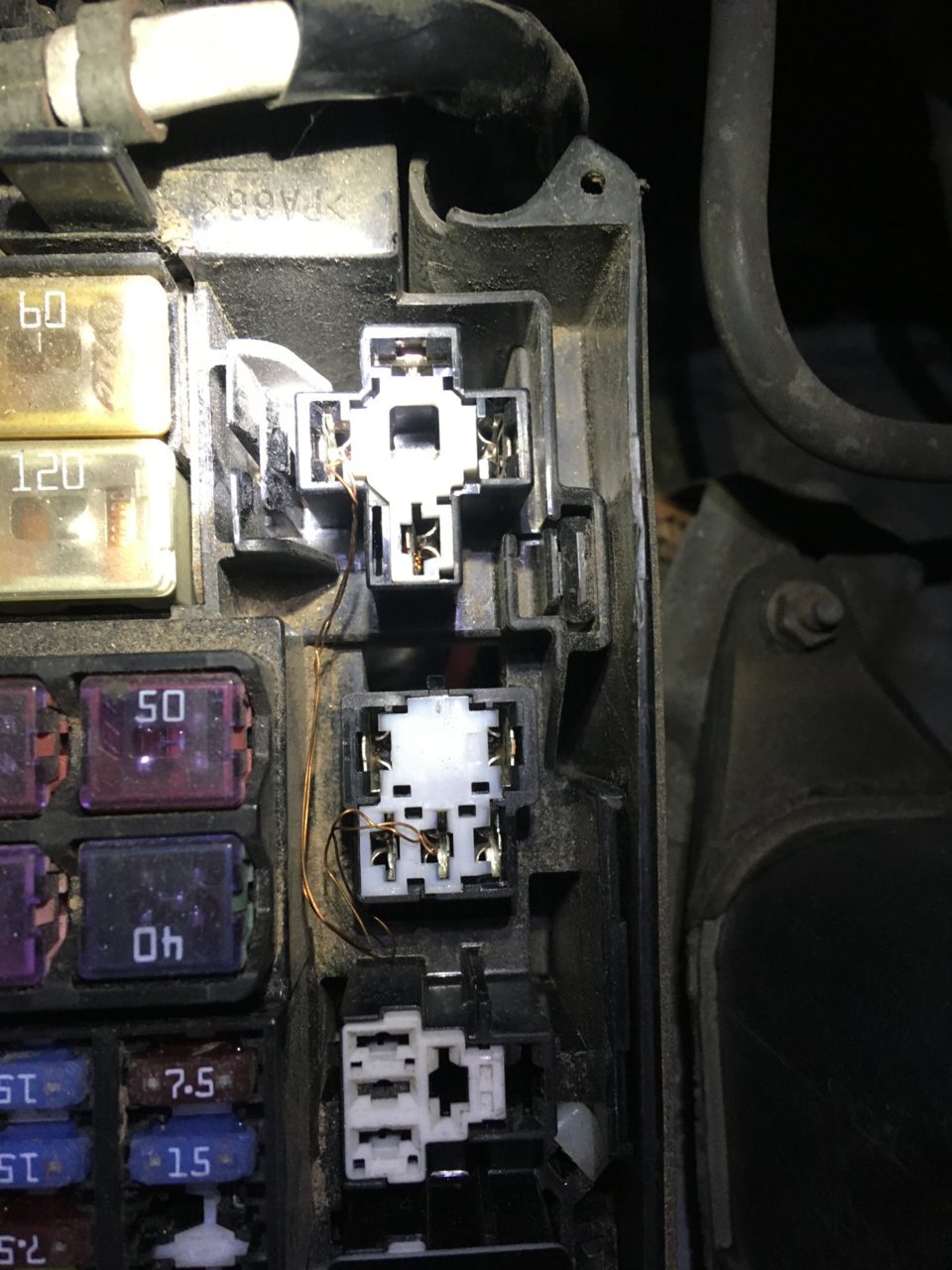

    I'm sure it's unrelated but has me curious still, when I was inspecting the relay box and pulled out the starter fuse, I noticed a bare strip of fine copper wire running between both the heater and starter fuse nodes. I took a pic of it.

    You have a very messed up starter circuit . I can only say look for strange wiring . Where it might be I would think a very easy place to access.
    When the starter circuit some how was energized if the blower motor switch was closed the engine will crank .
    Fresh water is a very poor conductor of electric now if it was ground water slop that might have had metallic grit that is another story. A very interesting physics experiment in my youth.
    That has to be in the Top 5 of the strangest vehicle wiring I have seen.:annoyed:
