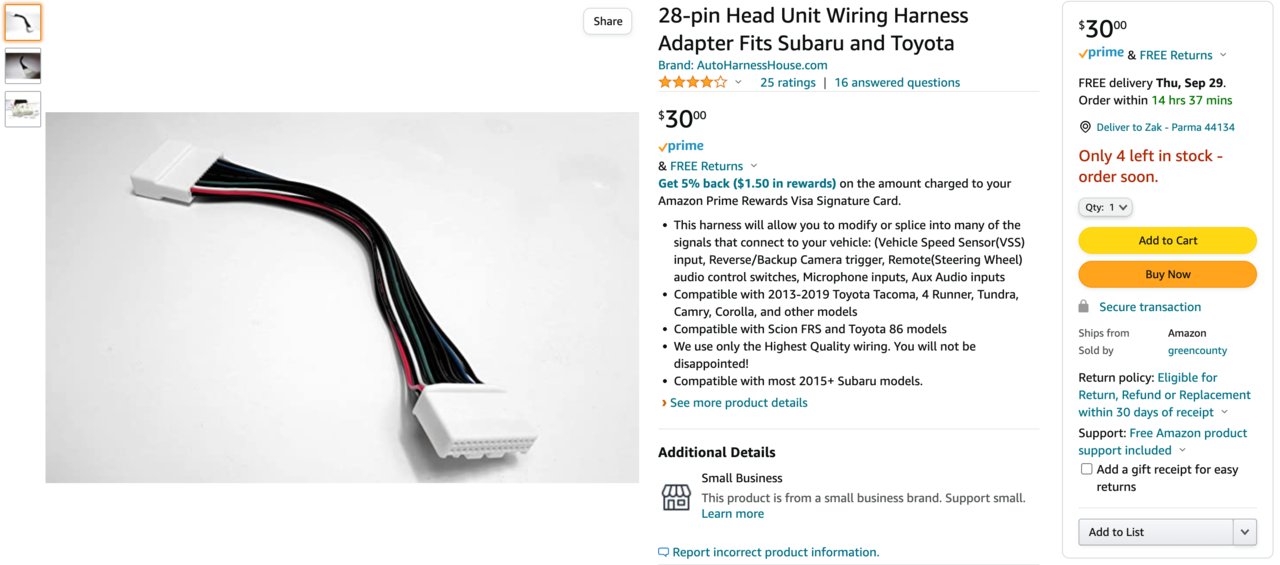

    Yep, that's the current plan. I've abandoned the idea of an Arduino on the steering wheel in favor of putting it in the dash for both ease of install and to not worry about how to plumb power.
    I'll tap into this harness which as far as I know connects directly to the back of the headunit:
    This'll be accomplished modifying this harness I found on Amazon, similar to the modification I outlined for the steering wheel harness:
    https://www.amazon.com/gp/product/B01BSE5X9Y?ie=UTF8

    We can build that 28 pin for cheaper but fine to use that for a prototype for now.

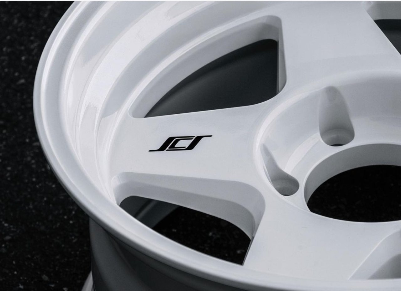

    Hoo boy!
    So SCS finally released some Gen5 in gloss white and I managed to snag a set!
    Can I afford these right now? Absolutely not.
    Am I stoked on the purchase? Of course.

    Glad white rims are making a come back. Always looked good on older trucks

    Yeah. I'm happy with how powder coating the TRD SEMA wheels turned out, but these SCS will be a big upgrade from that.
    Should look real sharp :cool:

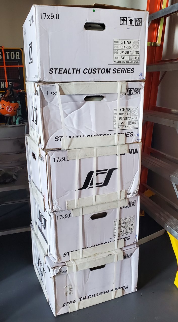

    Sadly it'll be a couple months before I can afford a new set of KO2 for these beauties.
