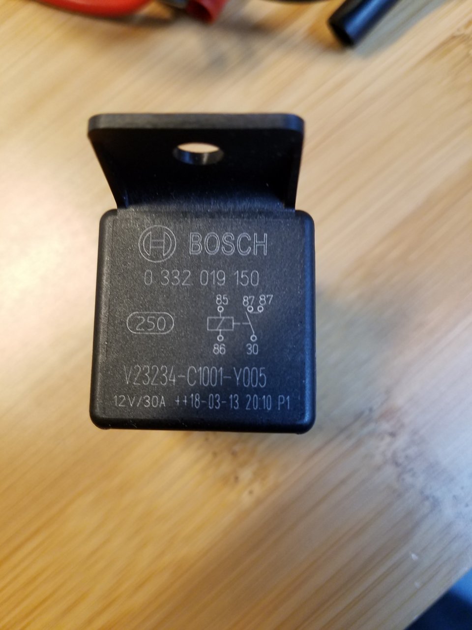

    The Rallylights harness uses German brand Hella relays made in China. I'm always skeptical of made in China part quality and do my best to avoid those parts. @Norton had his Hella relay fail after a couple years and did some leg work to find a high quality alternative. You can see his post with photos here.
    The recommended replacement is the Bosch 332019150 Relay, made in Portugal.
    Image above is from Nortons post. For the $7 it is a worthwhile preemptive upgrade IMO. I've purchase one to replace my working Chinese Hella relay. It is worth noting that Headlight Services, who builds headlight harnesses used in the headlight upgrade thread strives to use only the highest quality components, and they use the same European made Bosch relays.

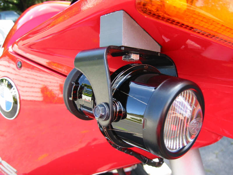

    my favorite aftermarket projector fogs are the Hella MicroDE, which are available in halogen or HID. these are metal bodied, glass lens, very compact, very good wide patterns. they also make MicroDE Driving Lights, these are long distance spotlamps.
    here's one on a custom mounting block[1] on my bike. I installed these lights in 2003, and have driven 50000 miles in all kinda weather with them, they've never let me down. in 12 years I've replaced 2-3 sets of high wattage yellow H3 bulbs.
    [1] a wedge of delrin, hahaha. These are meant to be mounted behind the bumper

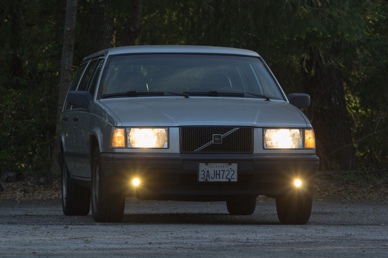

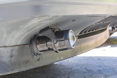

    oh, here's another pair of them on my 1992 volvo 740 turbowagon, which was my utility vehicle before I got the tacoma.
    (but that closeup was a trial mount before I recessed them into the bumper trim)
    these have 55W Hella yellowstars in them. pale yellow, makes a great foglamp. photo was taken from right at the edge of the beam cuttoffs.
