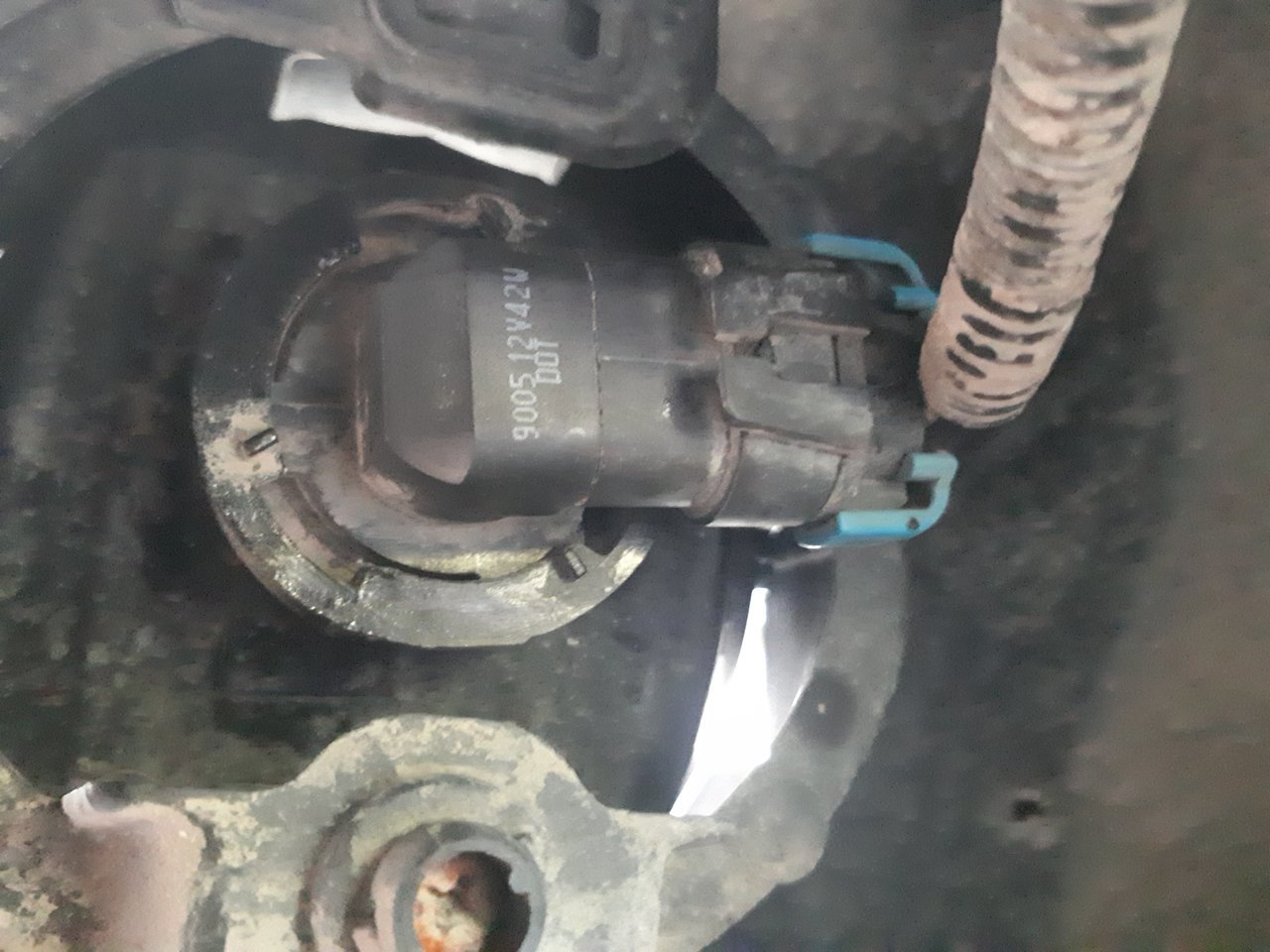

    @crashnburn80 so I did a silly haha it did not dawn on me until just now as I re-read the OP. I ordered the bulbs, and I ordered the harness, I installed the harness. realized my fogs are not H11 cuz I have an 09 :anonymous: now I know I can change the ends on the harness to ones that will fit on my fog lights but unfortunately I cant use the bulbs hahaha do u know off hand any bulb that would work in my fogs? I cant remember what type they are right now but I will edit after I go look lol

    ive got 9005 bulbs, I'm assuming those are the same as H10's. I have no problem soldering on 2 h10 males and a H10 female. its finding a decent bulb my issue, I will do a little digging haha I was contemplating just going the Morimoto route but if I can find a bulb that will give me more light output and keep my stockers that would be cool too since I already dropped coin on the wiring harness hahaha

    thanks for all the info man I really appreciate it! and I guarantee they are indeed 9005 lol I pulled the bulb out and checked before I posted haha

    Are you in OEM housings? Is the bulb connector for fog light modified.
    The brightest 9005 is the 9011 HIR. It is a completely different class of bulb and exceptionally rare. It makes 3000 lumens at stock wattage, compared to the LED Morimotos 1200.
    http://www.rallylights.com/vosla-9011-hir1-9005-65w-halogen-infrared-bulb.html
    Though I'm still skeptical on your 9005 bulb in a fog.

    So I have housings from Spyder and they came with the bulbs. But I compared them to my oems I had laying around back when I had installed the wiring harness because I thought maybe that was the difference and they were the exact same man I promise you haha no modifications dude I will snap a picture after work hahaha

    Well I have no idea what to make of that, but the 3000 lumen 9011 HIRs would be the way to go. I think you have to remove a tab with a dremel if I remember correctly, but well worth it.
