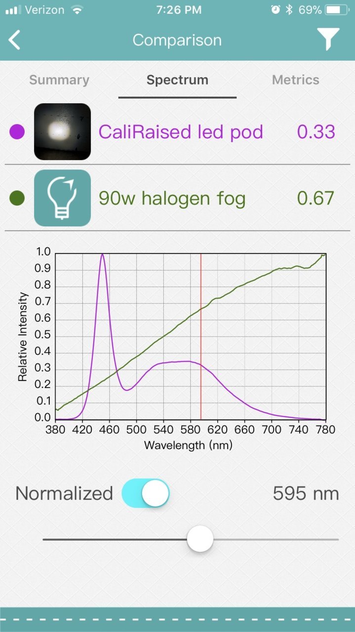

    I've hit standard Caliraised pods with a digital spectrometer. The vast majority of their light is in the blue spectrum, here you can see how their spectrum compares with the 90w halogen. The marker is placed at 595nm which is the center of the amber spectrum (570-620nm). For a given amount of light output, halogens produce double that of LED. So if you are filtering your LED to only allow amber light through, the output is going to be severely reduced.
    You can also see the unfiltered pods put out massive amounts of blue light, which is not what you want in rain/snow/fog due to blue light's refraction causing surface glare on the moisture in the air. For poor weather you want more long wave length light, which is light on the right side of the chart, and less short wave length light which is the left side of the chart. Greater than 700nm is IR light which will keep the lens from icing over in cold weather.
    Norton and jet123[QUOTED] like this.
