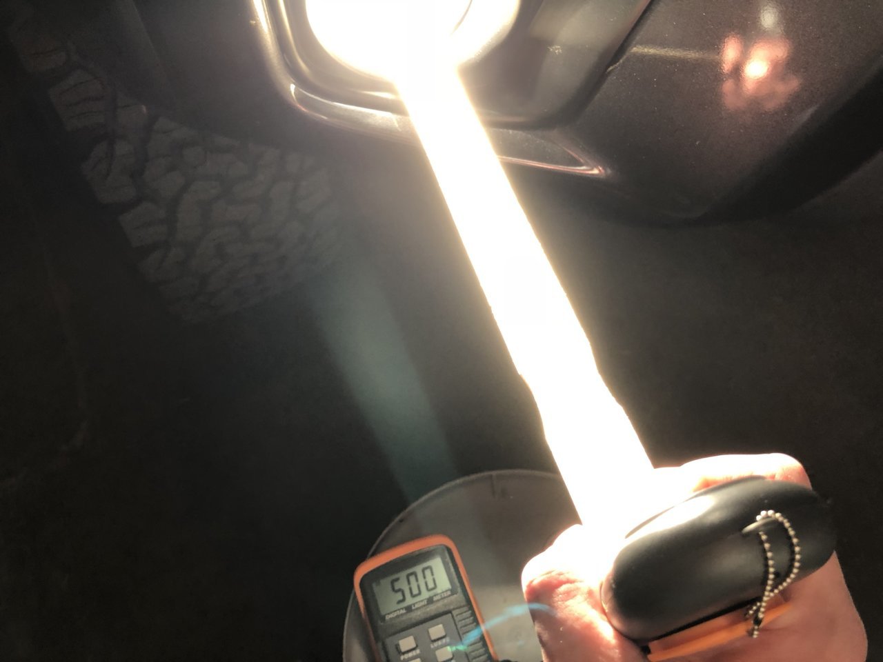

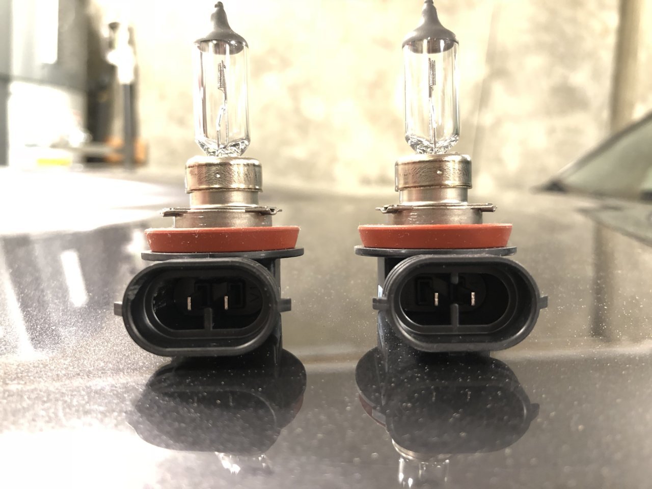

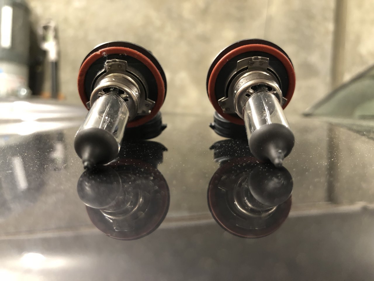

    Got the new bulbs in today, Volsa H9s with an H11 blacktop glare cap. H9s are more work to fit compared to the plug and play Flossers.
    An internal tab needs to be trimmed in order to fit onto the harness plug. I used an exacto knife and a little patience to whittle down and remove the tab.
    Tab removed from the left bulb for H11 connector compatibility.
    Then one of the external tabs on the steel mounting color needs to be trimmed to fit into the housing designed for H11 mounting tabs. I used a dremel with a cut off wheel. You can see where I accidentally nicked the seal.
    Top tab modified left for H11 housing compatibility

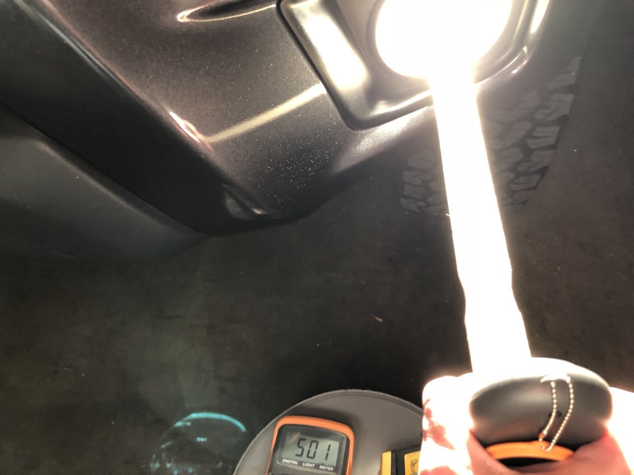

    Comparing output
    Volsa H9s
    Seeing the rating as pretty close to what I got before, I reran my last measurements of the Flossers.
    H11 90w Flosser
    Output actually appears nearly identical. So I tested operating temperature with my IR gun.
    Volsa H9: 209 degrees
    Flosser H11: 230 degrees
    The big advantage with the H9s is at 65w they do not require a harness, unlike the 90w Flossers. Note that the testing done in this post was running on a standalone harness for maximum performance. If comparing Volsa caped H9s on the stock harness to Flosser H11s on the standalone harness, the Flossers would likely outproduce the Volsas.
    The H9 is a high efficiency bulb with a higher precision filament than the high wattage Flossers. In theory this should result in better distance projection, though I have yet to do any night testing.
