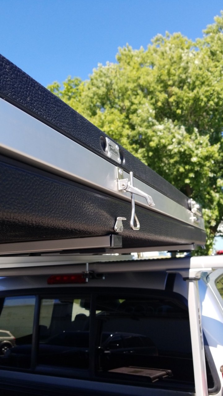

    IMG_20180913_123851.jpg Well I just got the headlight harness from Headlights services, and it is ridiculously good quality. It was also less than the other premium options. So I can whole heartedly endorse it's purchase!!! It is damn good!
    I just haven't had a chance to put it in yet. Too busy with this.

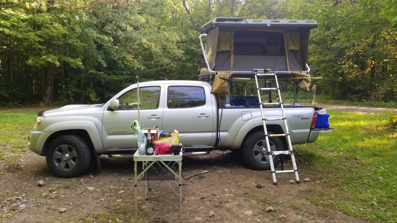

    See right now, I am enjoying some NY state cider in some forest, at a primitive camping spot with my new RTT:
    The fire is a nice touch... Regardless of the LED light bars, and upgraded Uber headlights... just burning wood and cider... Very nice.
