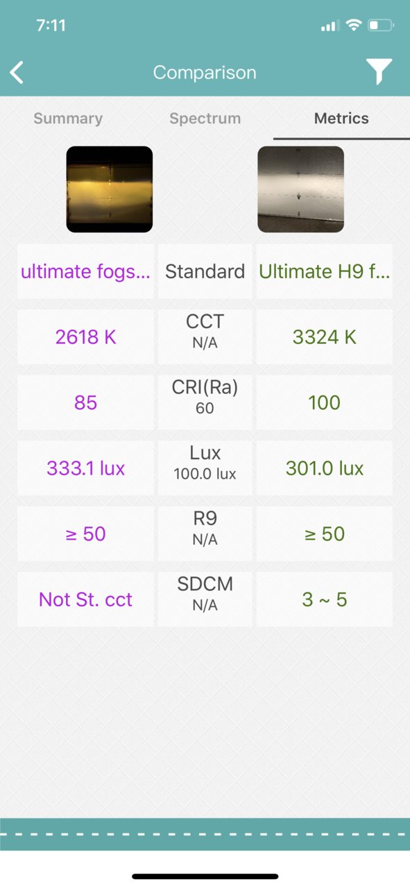

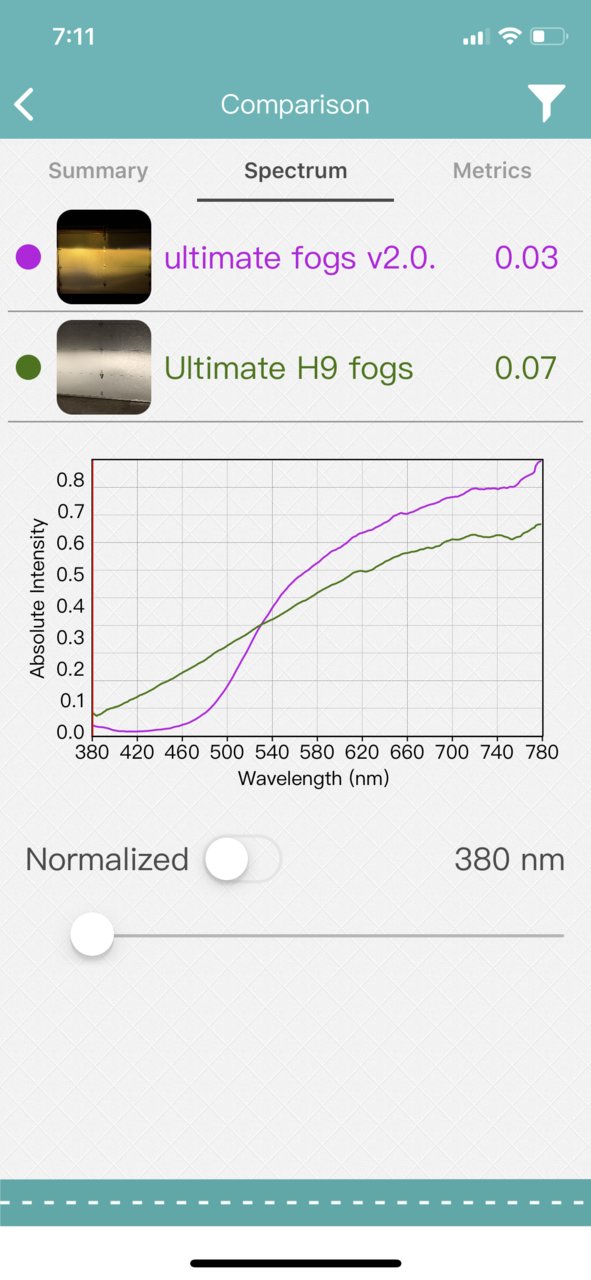

    2003 DCSB TRD OR
    After using my fogs in the most extreme snow conditions yet and being unhappy with their performance I’ve been working on building something better, with less short wavelength light and a more amber/yellow color.
    Not ready yet, but here is a sneak peak at some data.

    @crashnburn80 -- When you list 'ultimate H9 fogs',, you are referring to the Volsas H9 bulb discussed earlier in this thread?
  20. Jan 23, 2019 at 8:04 AM
    #380
    crashnburn80
    crashnburn80 [OP] Vehicle Design Engineer
    Jun 6, 2015
    #156893
    14,772
    Kirkland, WA
    2003 DCSB TRD OR
    That is correct. Those are not available but had comparable output to the Flossers at a lower power consumption.
