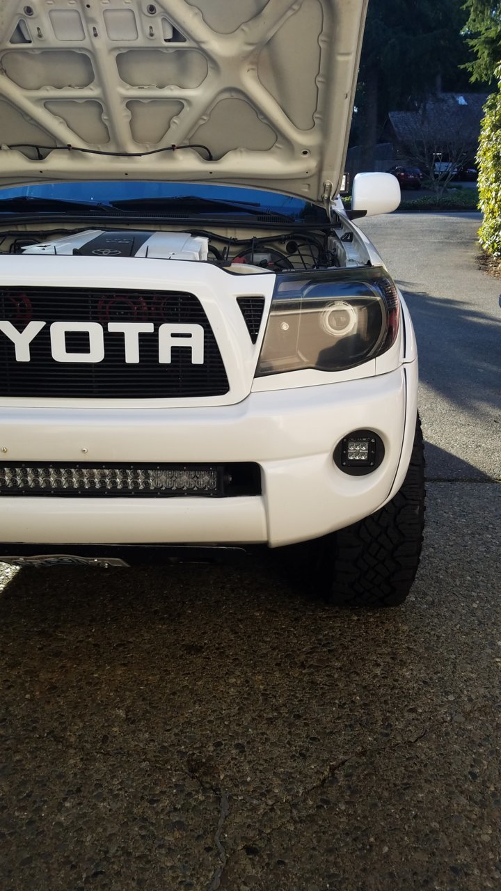

    I posted this in the wrong thread, my bad. Morimoto mini h1, 5000k bulbs
