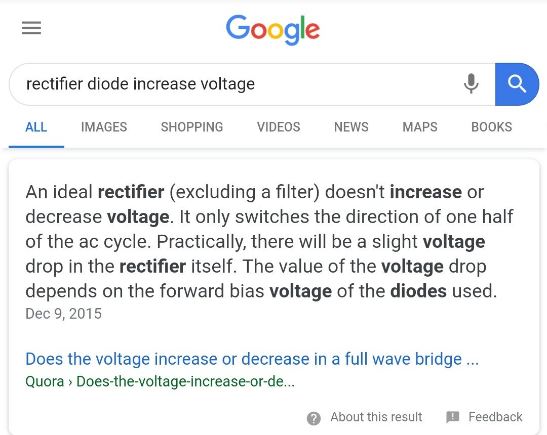

    Add a diode in line to boost voltage. Also I was saying for the second gen

    Diodes don't boost voltage.

    Rectifier diode does

    Well that what I use on my alt for 10yr now no problem. It charges at 14.8-14.9 all day. I got the ideal from a guy on here. You want the link page? I not arguing fighting just what I seen on here.

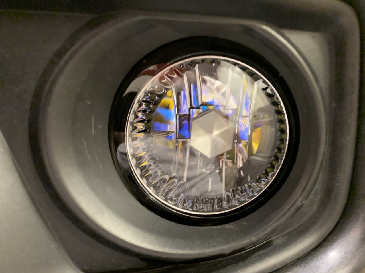

    Lights are in, but not wired yet.
    I forgot to take pics of them fully installed as I spent waaaay too long trying to cram 14ga wires in to the terminals on the body harness plug and ended up destroying them. I might try again, but I might just punt and buy the factory harness.
    Thanks again @crashnburn80

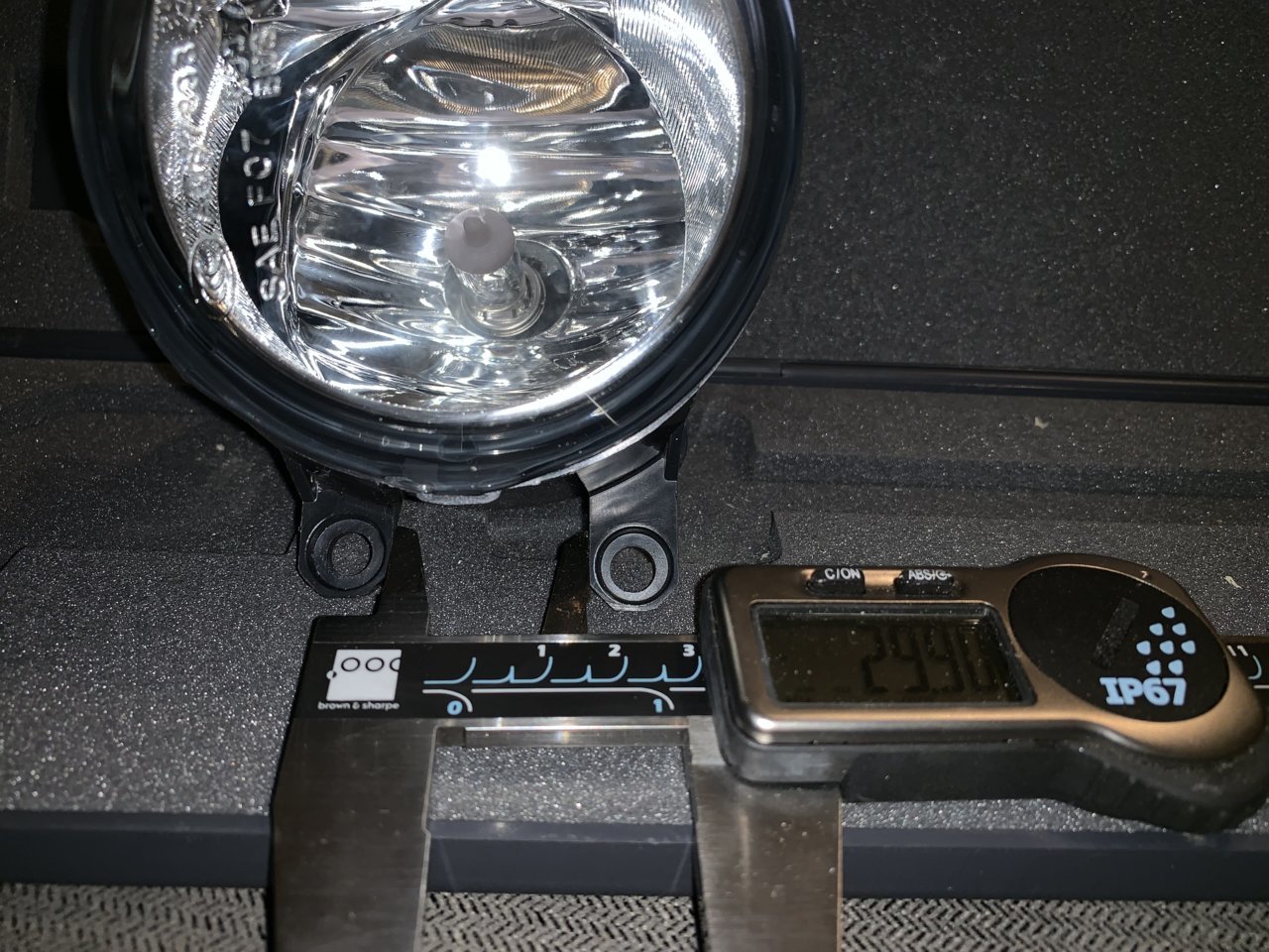

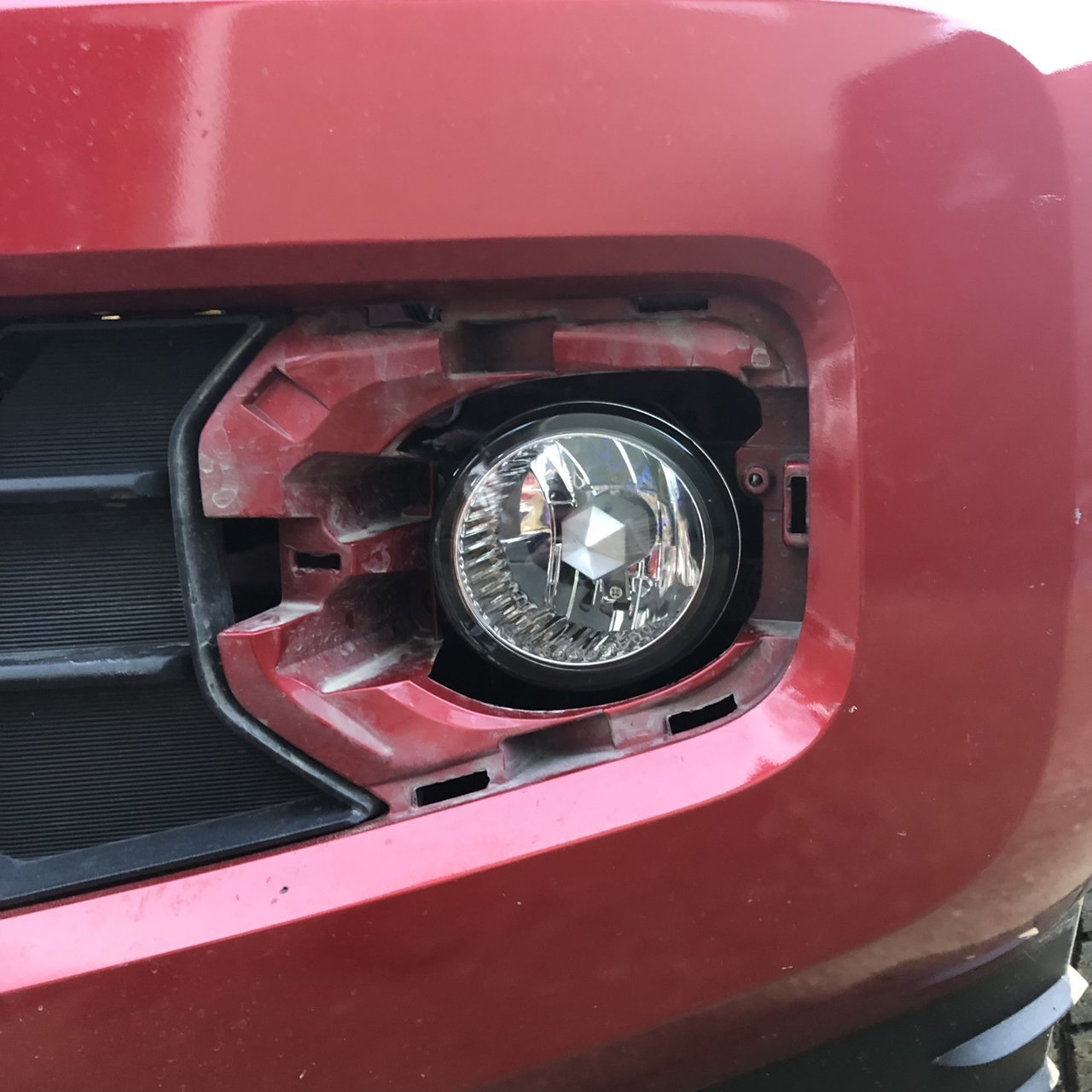

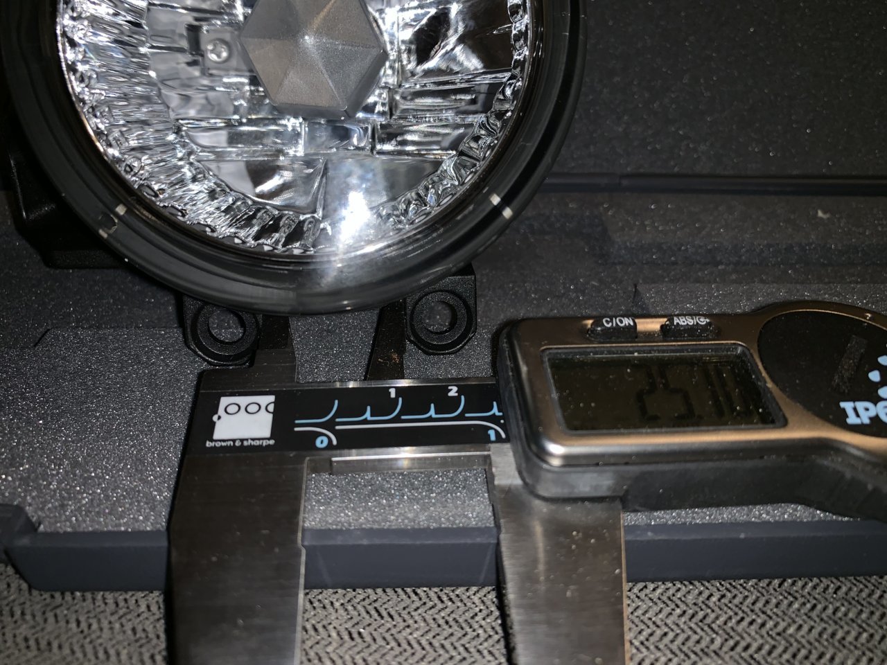

    These don’t fit unfortunately. Unless you grind out 2.1mm from each of the two inner tabs closest to to the grill on the Subaru housings, and you have only 3.5mm of material on the ear to work with. Otherwise they are 4.2mm too narrow to fit in the bumper slots to hold it firmly and in the right place and are resting outside and pushing rather hard on the mounting point.
    I’m still contemplating grinding the tabs as these are very nice housings, and the best solution for a halogen bulb I’ve seen yet.
    I refuse to mod the bumper.
    Hard to see. Measurements. OEM: 29.90mm, Subaru 25.70mm
