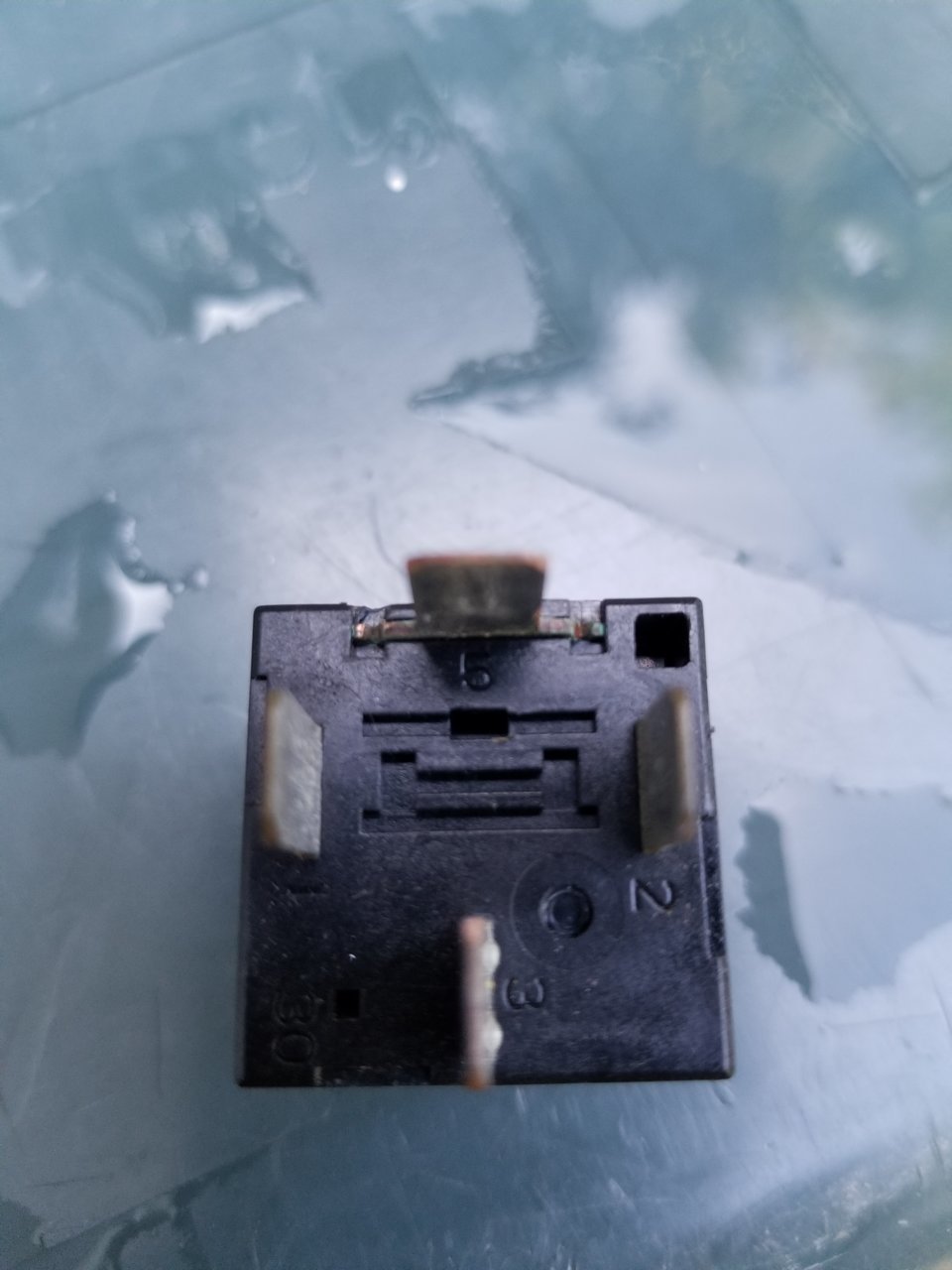

    So @Norton this relay is actually a 4 pin and not 5 pin as pictured?

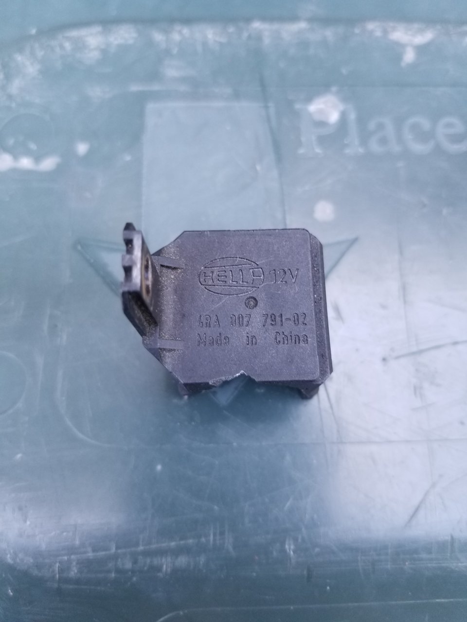

    Hmmmmmm my hella relay is 4 pins not 5

    So does anyone know where I can find the Hella 500ff relay that is a 4 prong and not 5 prong? Instead of buying a whole new set of lights just to get one.

    If you happen to find a 5 pin relay, you should just be able to use it in place of the 4 pin. The only difference is the 87A pin, which would be unused.

    Thank you I did notice the harness had 5 summits and wondered why it only had a 4 pin.
