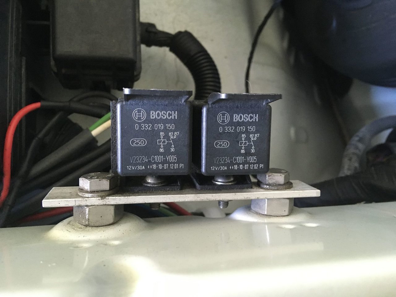

    Any pics of where you guys mounted the Rally/Susquehanna harness relay? I just received my harness and I'm undecided as to where to mount it.

    I had just tucked mine in between the battery and fender, wasn’t hard mounted. But others have found spots on the fender wall there to mount them. More ideas are posted in the 2nd Gen headlight thread for relay mounting if you ask over there.
    Yes a 20A relay would work. As you point out 180w/12v=15A, which should provide the adequate needed headroom.

    Right on the inner wall of the left front fender.
