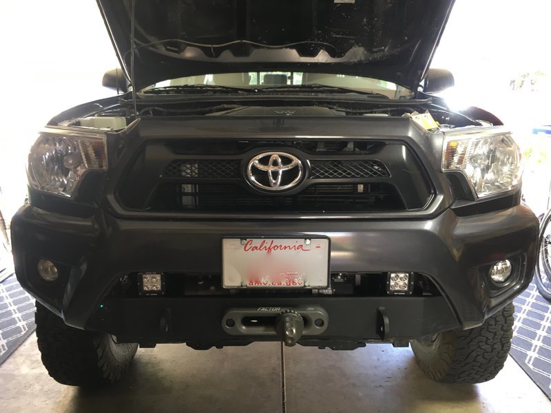

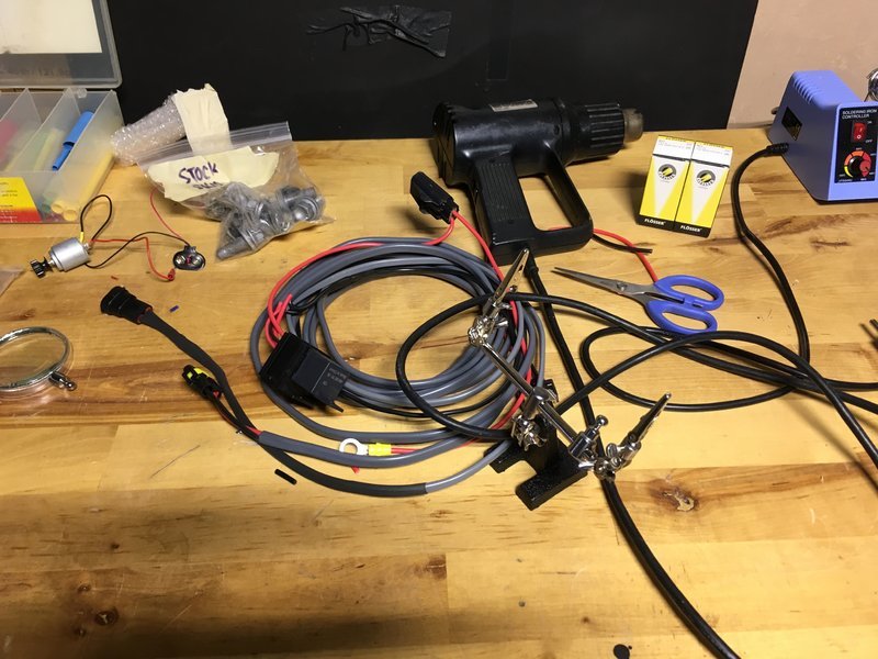

    :hattip: to you, sir. I now have done both of your lighting mods. Thank you for doing the legwork and providing us with a fabulous option for better lighting. True to most of what I also happen to like, this is stock-looking, only much, much better when it counts.
    The prep done:
    Nothing to see here:
    Never heard of Flösser, either.

    I like the stock look as well, and your near stock looking US off-road bumper. It is on my list. The headlight upgrade, plus the fog light upgrade, plus the LED pods on that bumper must put some serious light down range.
    EDDO[QUOTED] likes this.

    The combination with your headlight mod, the cubes and then-stock fogs worked really well on an off road night run we did a couple of weeks ago. Don't want ditch lights or a light bar on my daily driver, so this is it. Plus, I have the benefit of improved lighting on-road.

    As of July 6 (when I placed my order) they still weren't stocking the trigger connector:
    If that hasn't changed, you can buy your own and do a little solder/heatshrink job. I have a spare connector and a soldering iron if you are local.
